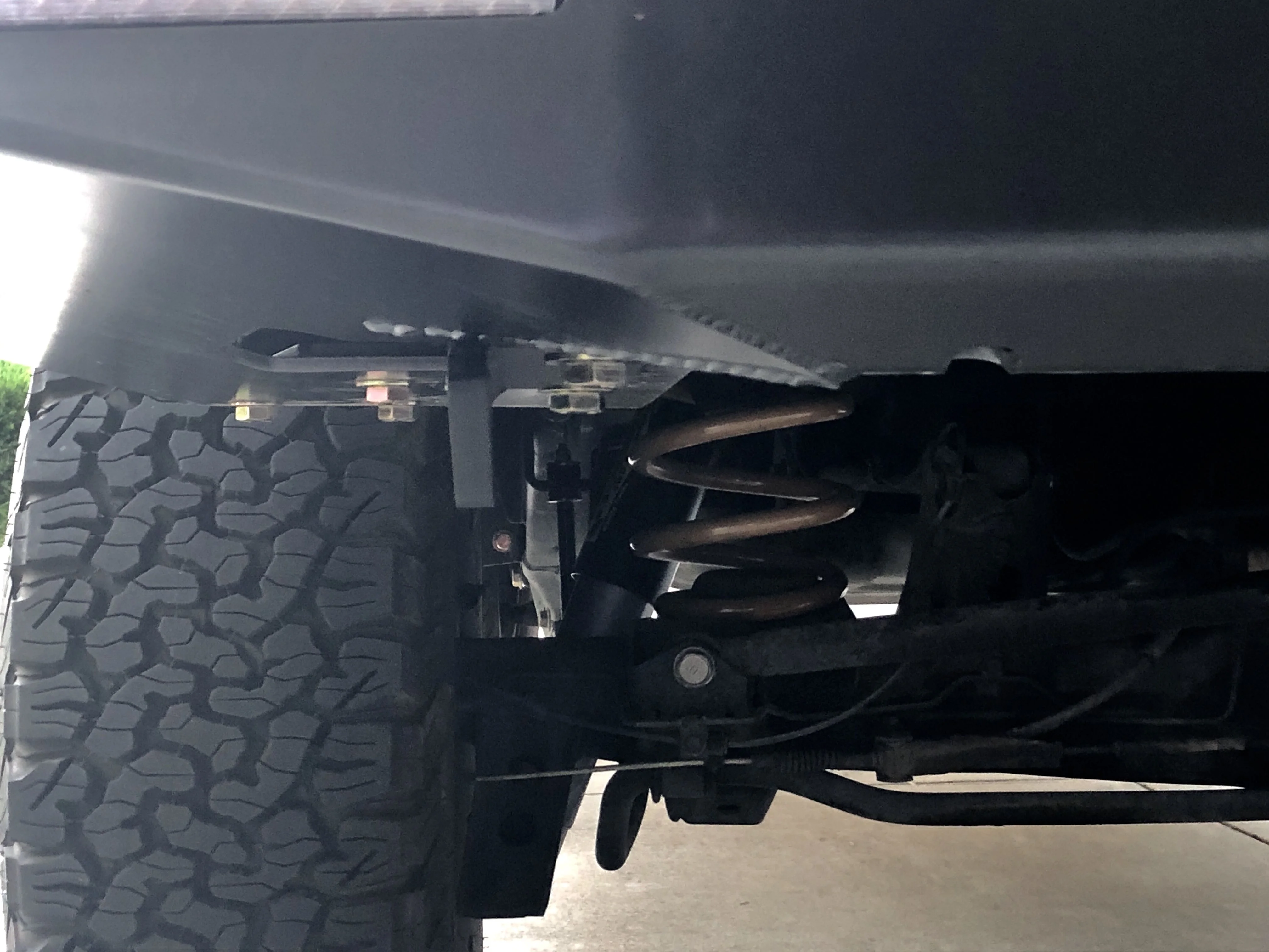

I have the aluminum version with dual swingouts. Does anyone know what these are and where they go? I couldn't find any reference to them in other pictures or the instructions. Thanks
Those are the recovery locations at the bottom of the bumper. See images below. Since you got the aluminum this is the method Ben and his crew came up with. I think its a solid solution for the recovery. Place a d ring and tell your friend to "PULL"
Thanks so much.
Will they sell those separately? I don't think they were available when I got my aluminum bumper two ago. I've just used a warn tow hitch shackle for recovery
I would give Ben a ring and ask.
