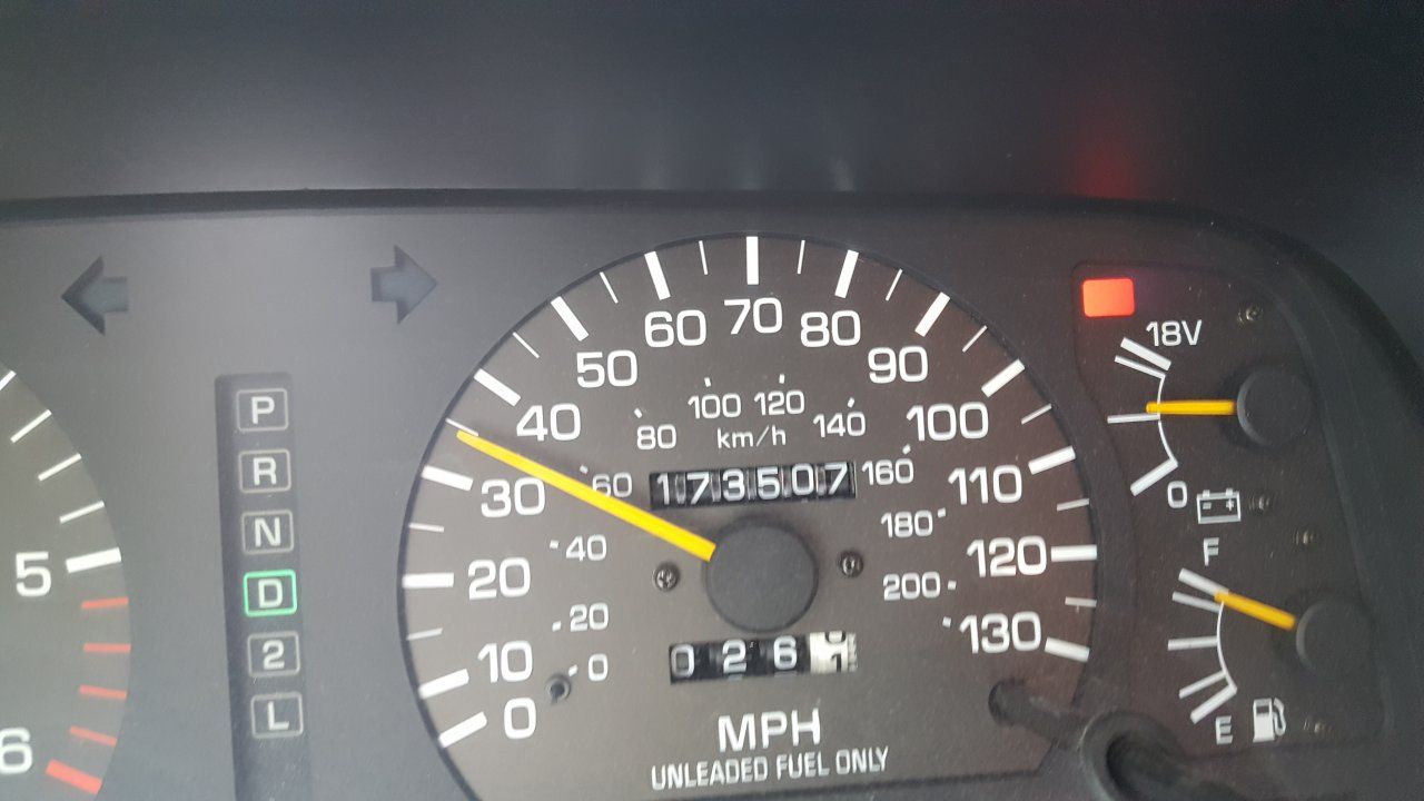

It came one while I was on a trail. Got back to a main road and the truck completely died on me. Suggestions? New alternator?
We were playing in mud... Could that kill the alternator, or are there other things I could investigate?

173k miles. I just got home so I will try hosing it off after I charge the battery. I like the brush idea.. I will investigate. Thanks for the ideas.

After cleaning - test the output while running from the alternator. Low output - new or rebuild the alternator.

Haven't played with alternators much. Where do I test the output?
