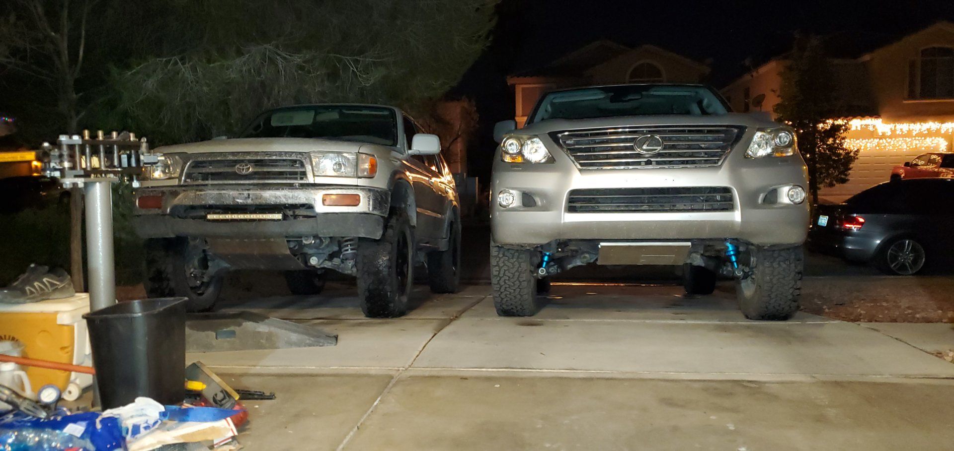

It looks like it will be sitting like this.
Did you measure fender to wheel center before lift, in N for example?
It sits around 23.5" now. It was much lower before, but I don't have a measurement.
Vs 4runner
The Lexus should ride a lot better.
4runner is pretty harsh with the amount of lift it has.

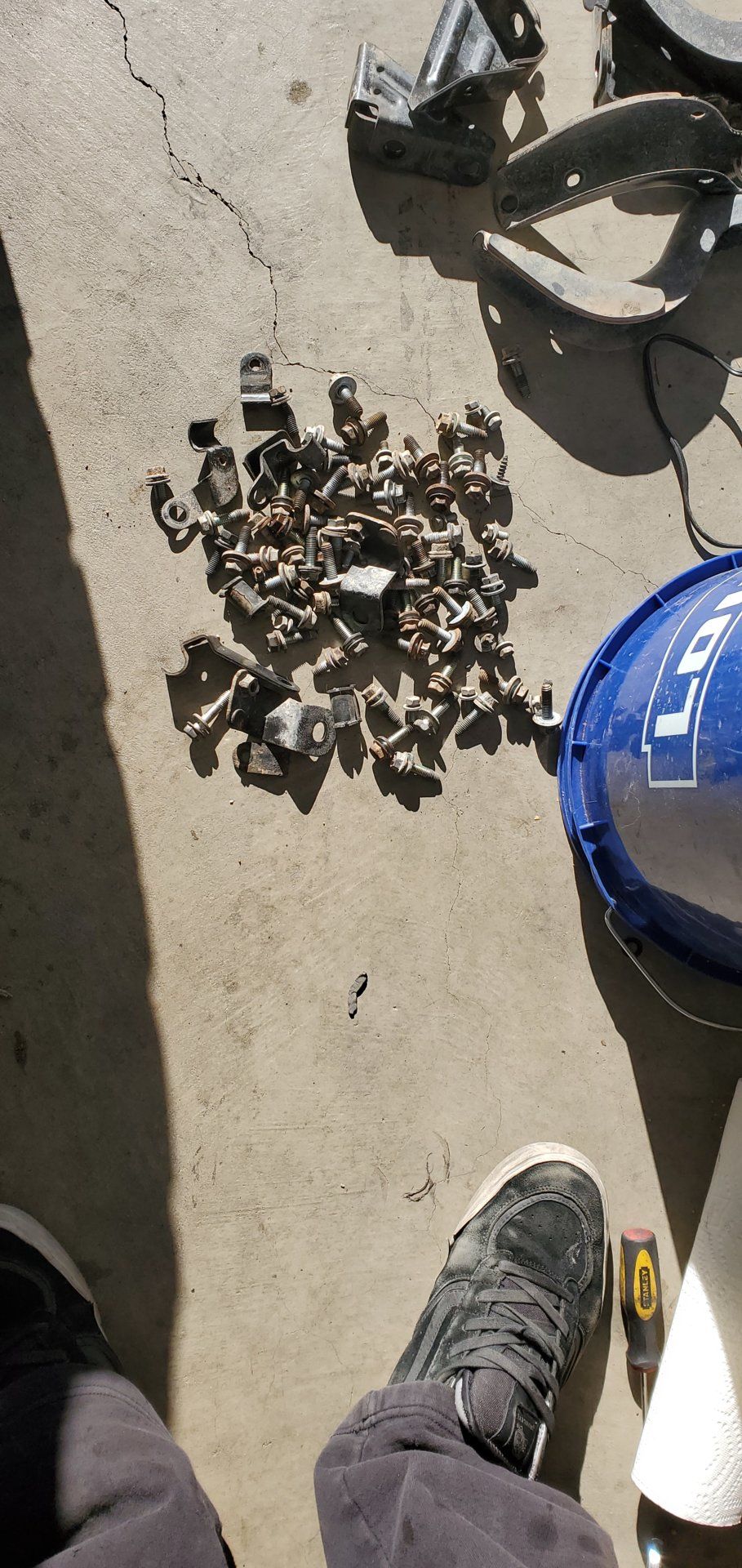

Dropping all the ahc junk.
Silly amount of bolts holding everything together..
Will you be able to snake the hard lines out without destroying them? Could be good info in the event someone needs to change on in the future.
I don't think you can snake them out. The lines appeared to be put in place before the body was dropped onto the frame.
I cut the front ones out and looks like I'll need to cut the rears out.
The hard lines are pretty thick walled with rubberized coating.
