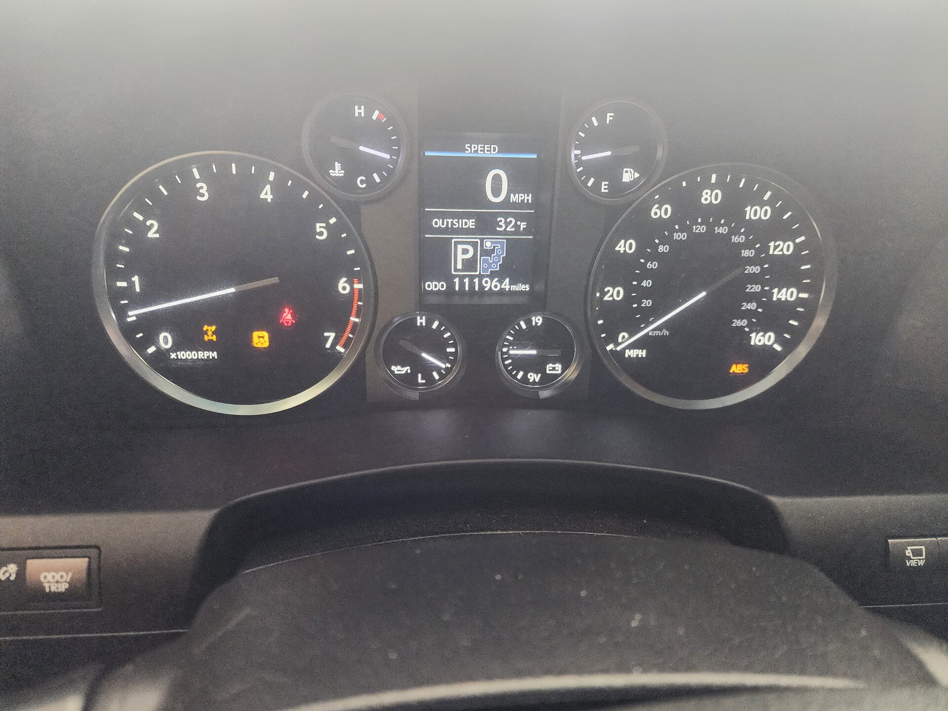

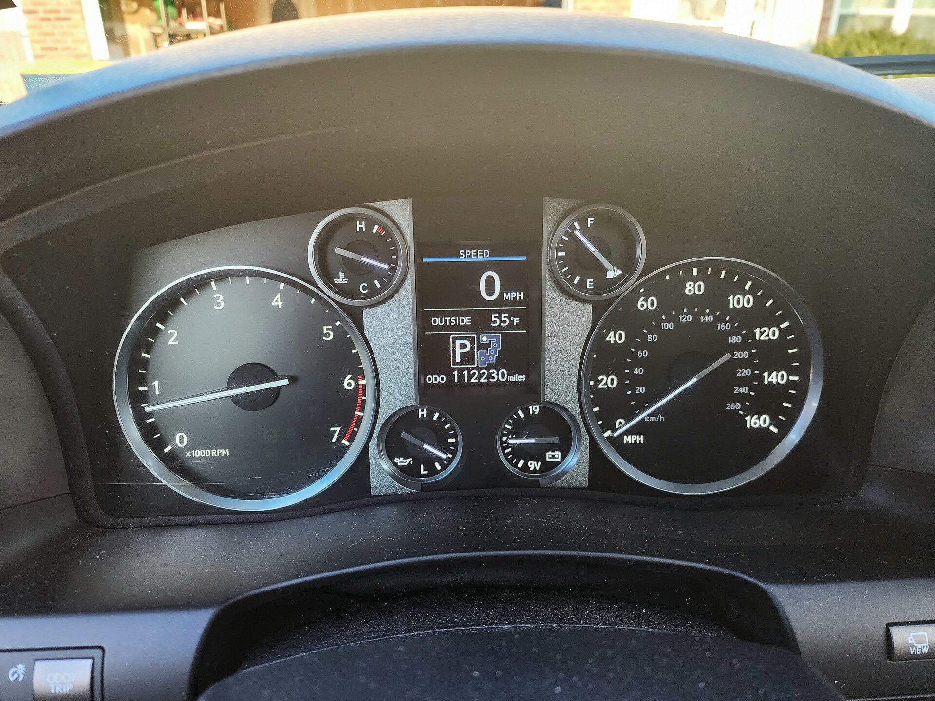

My CDL is blinking, and my VSC & ABS indicators are showing as well, but not blinking. I just ran a fault test on my OBD II via the Torque app and it says no fault codes are stored in the ECU.
Is there another way I can troubleshoot to find out what the issue is?
Even with these icons on the dash, the car is driving like normal.

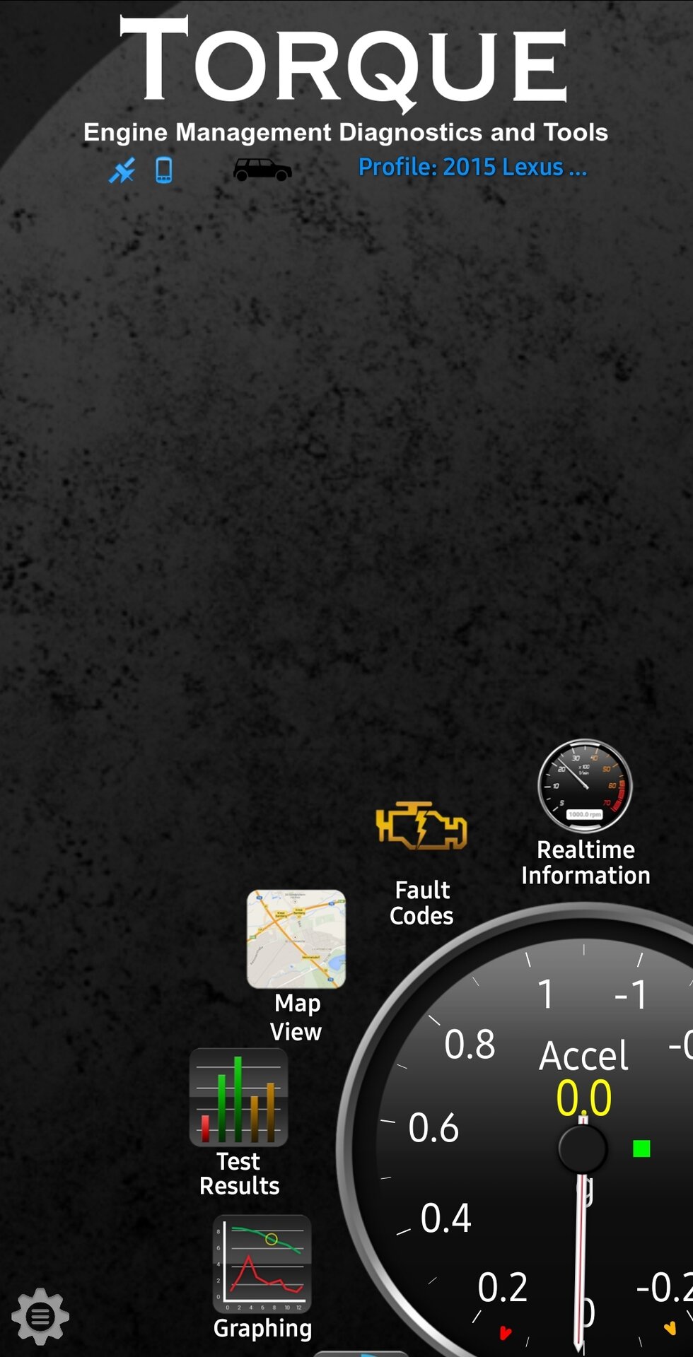

Also yes a bluetooth reader and torque app may not get to some of the codes stored. Which adapter module are you using? I know the carista app has displayed SRS codes for me but I haven't tried it for ABS/VSC, that's a different computer that it may not have access to. OBDFusion may get it, or finding someone with techstream.
You are probably just dealing with the common issue with the electrical contacts within the CDL/4Lo actuator. See teckis thread about it.. it does seem periods of battery disconnection are somehow correlated with problems, as to why this came up when it did.

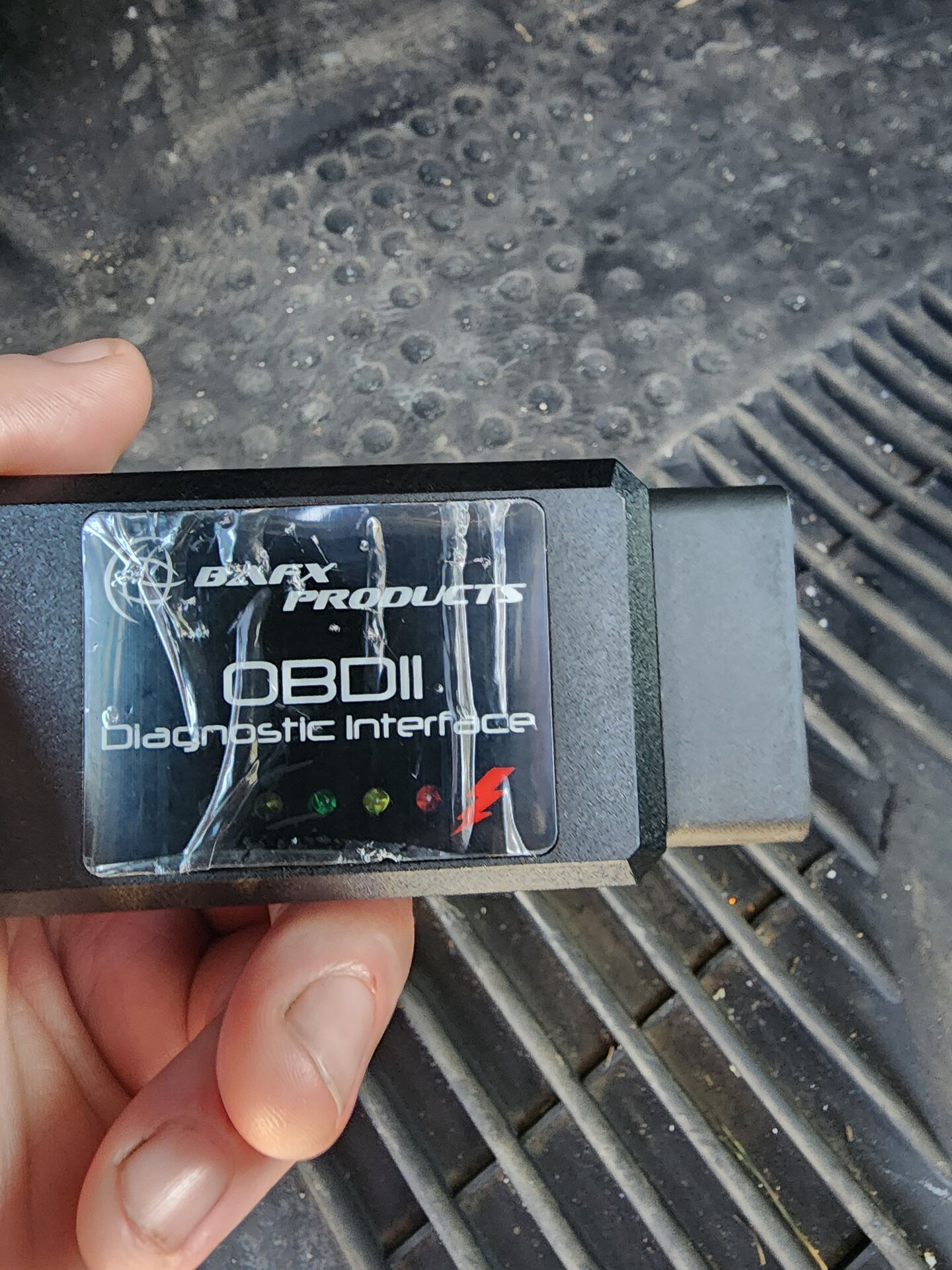

Here is the app & OBD II that I am using. Is there a techstream app, or download that can be used thru the reader I have?

AFAIK torque is a good app but I haven’t used it. Clearly it won’t pull ABS codes, I think OBDFusion does but it’s worth researching before paying for it, and whether your Bluetooth adapter is actually what’s limiting the ability to see ABS modules. I personally use the Carista adapter and it has been great so far.. but I still prefer techstream if I’m not on a roadtrip, and even then I still bring it sometimes.

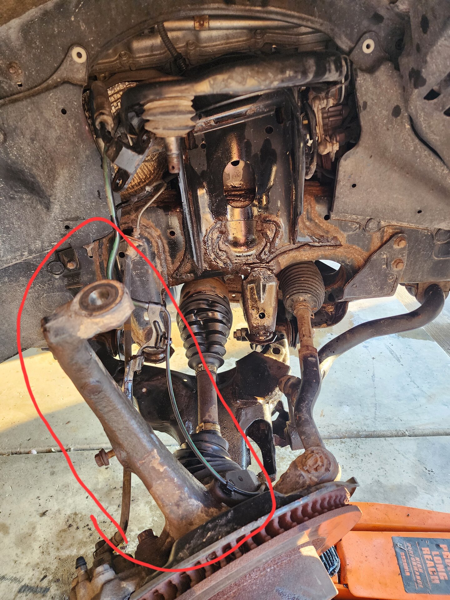

When you say spindle.. you mean the steel part that connects the upper and lower control arms and the hub is mounted to? The knuckle maybe? Is there any chance the thick black wire that goes up and onto the UCA got stressed when you had this alignment issue? That’s for the ABS sensor on that knuckle and a problem there would definitely trigger ABS codes.
Techstream is the official Toyota PC diagnostic software, for which you can buy cabled adapters and cracked registry keys on ebay. Avoid miniVCI adapter kits with TS, they aren’t full feature. The VCX nano adapter seems to be the one to pick at this point.
Yes the knuckle sorry. Notice how it is resting in the picture. It flopped out into that position after I removed if from the UCA, and it wouldn't go back into position until I rotated the rotor bringing the knuckle closer to the UCA.
As far as the black wires go. I will run the car ona few dirt roads in 4Lo and see if that might do something. If it doesn't, I will get into the front wheels wells and inspect the ABS wheel speed sensors and the wires. If I do need to replace these, how much are the parts, and on a banana level how hard is the job?
I’d avoid driving your vehicle until you verify the inner CV is assembled correctly.
Most likely the reason it wouldn’t go back until you rotated things is your inner CV came out of socket. It is possible that when it went back in it didn’t do so correctly, and you absolutely do not want to drive it this way.

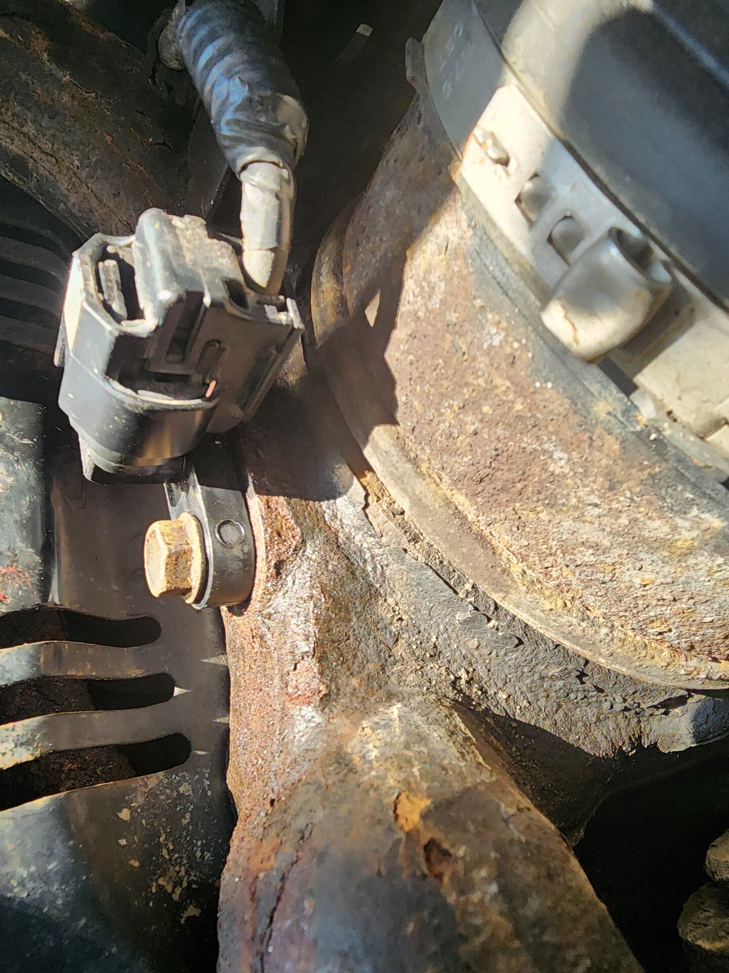

That shouldn’t still cause the ABS/VSC issue though.. I’m wondering if the wires are ok. You really need to read the codes.
Edit: I just verified the Carista app and adapter can check the ABS computer for codes. Maybe see if their app works with your module, and if not just order one of theirs.

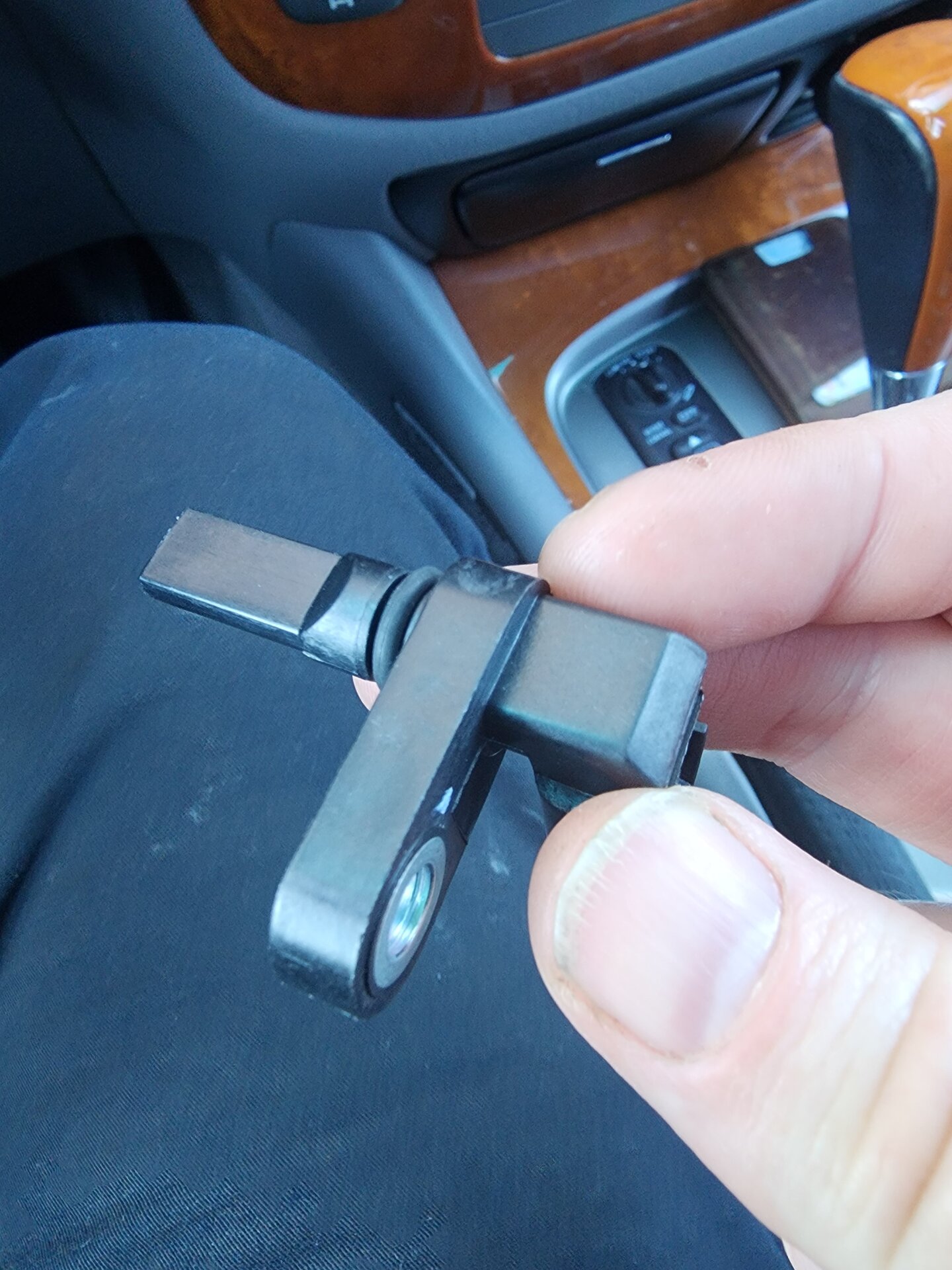

UPDATE: My dash is now all cleared. Went to AutoZone this morning, and they were able to scan for an ABS code.
-C1405 & C1445 popped up.

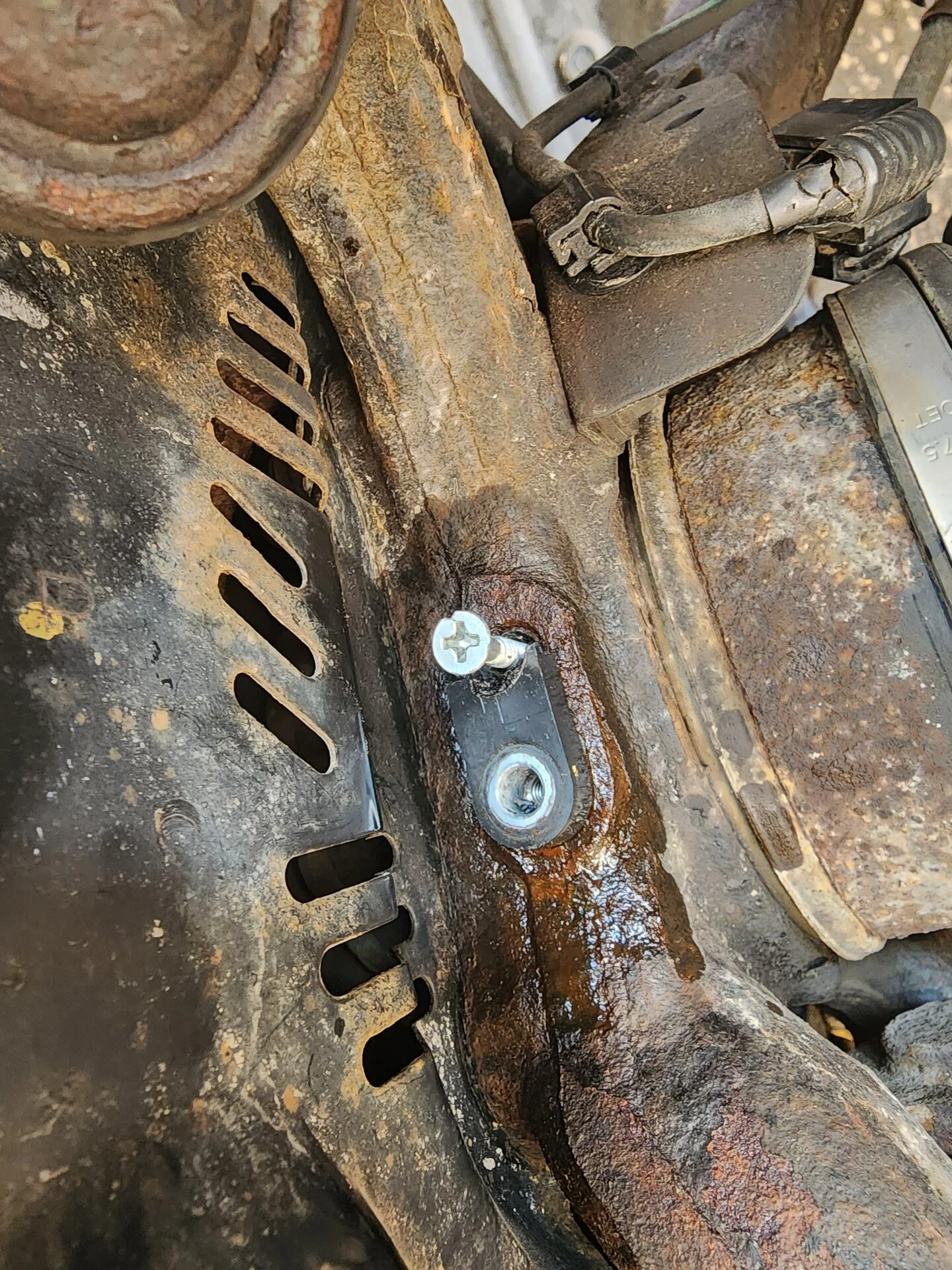

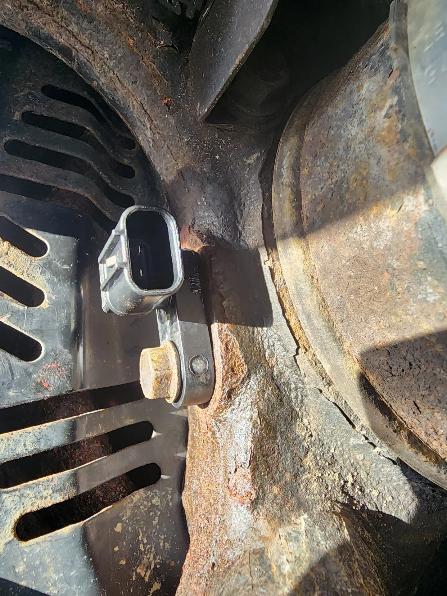

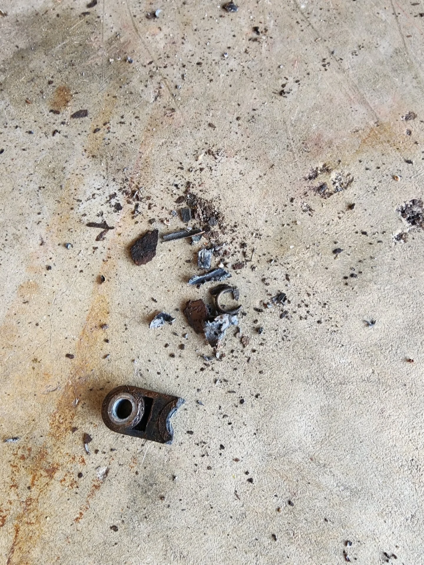

Swung by the dealership to grab the ABS sensor wire I ordered. When I got home and got the wheel off, and found the ABS wheel speed sensor was my problem. It didn't help that the sensor pretty much broke flush with the hub. I ended up having to drill thru the sensor, and pull some out with a screw, and pick the rest out with a dental pick. Luckily, the local O'Reilly 's had a sensor in stock. I soon as I started up the car, the blinking diff light & ABS light disappeared. A few feet later the VSC light disappeared as well🤘🤘🤘
My guy you should really remediate that surface rust. Not dealing with it just took out your AHC. That scale will flake off with a knotted wire wheel and then treat with your favorite seasonal rust preventative and top coat.

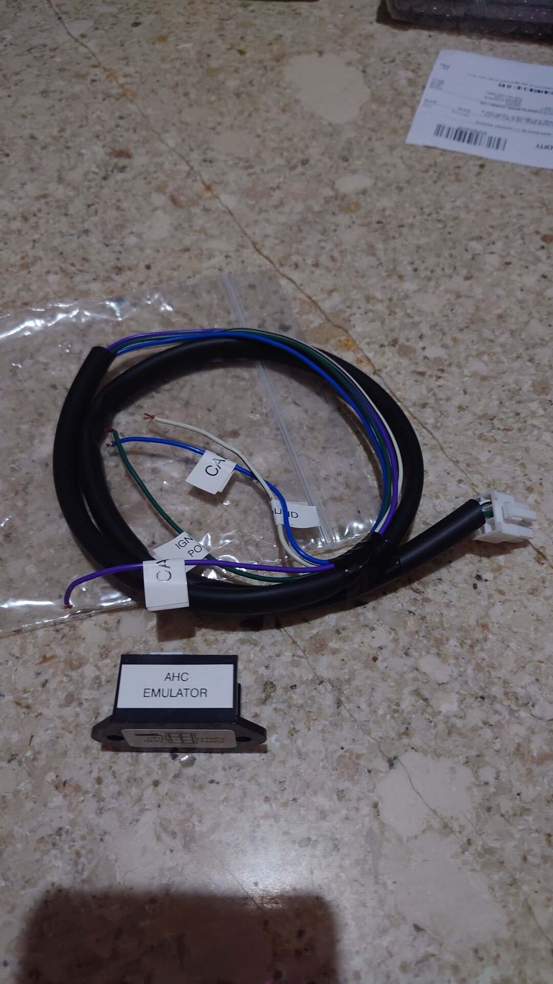

Just as an update, I've finally managed to clean up the AHC error on the 2016 LX570 with King shocks. a few things I found out:
1. the headlights in 2016 use full canbus for managing the beam leveling and receiving input from the steering wheel stalk (save for the turn signal).
2. the Headlights ECU needs to "see" the AHC ECU and receive input from the AHC height sensor to be able to determine the auto beam leveling.
3. removing the AHC ECU will trigger a "fixed" error light on the cluster for the headlight leveling ECU and unless the AHC ECU is connected for the headlights to see the sensor the error light will persist. if the AHC ECU is installed, the headlight error light will be gone but the AHC error light will appear.
4. the only way to remove the error light is to have a can-bus emulator emulating the AHC ECU signal to the cluster and Headlights ECU (informing that the AHC ECU is present and sending the height sensor data).
Andrew Todd from AGT Engineering has developed the Canbus emulator for the 2016 up LX570 AHC that can send signal to the headlights ECU making it happy in the absence of the factory AHC ECU. The device is small and easy to install, you just need to connect it to the canbus wire from the AHC (2 cables for can hi and can lo) and also + and - wire (can also be taken from the AHC ecu wire).
so far very happy and no more errors on the dash.
Cheers,
Bonie
Cheers,
Bonie

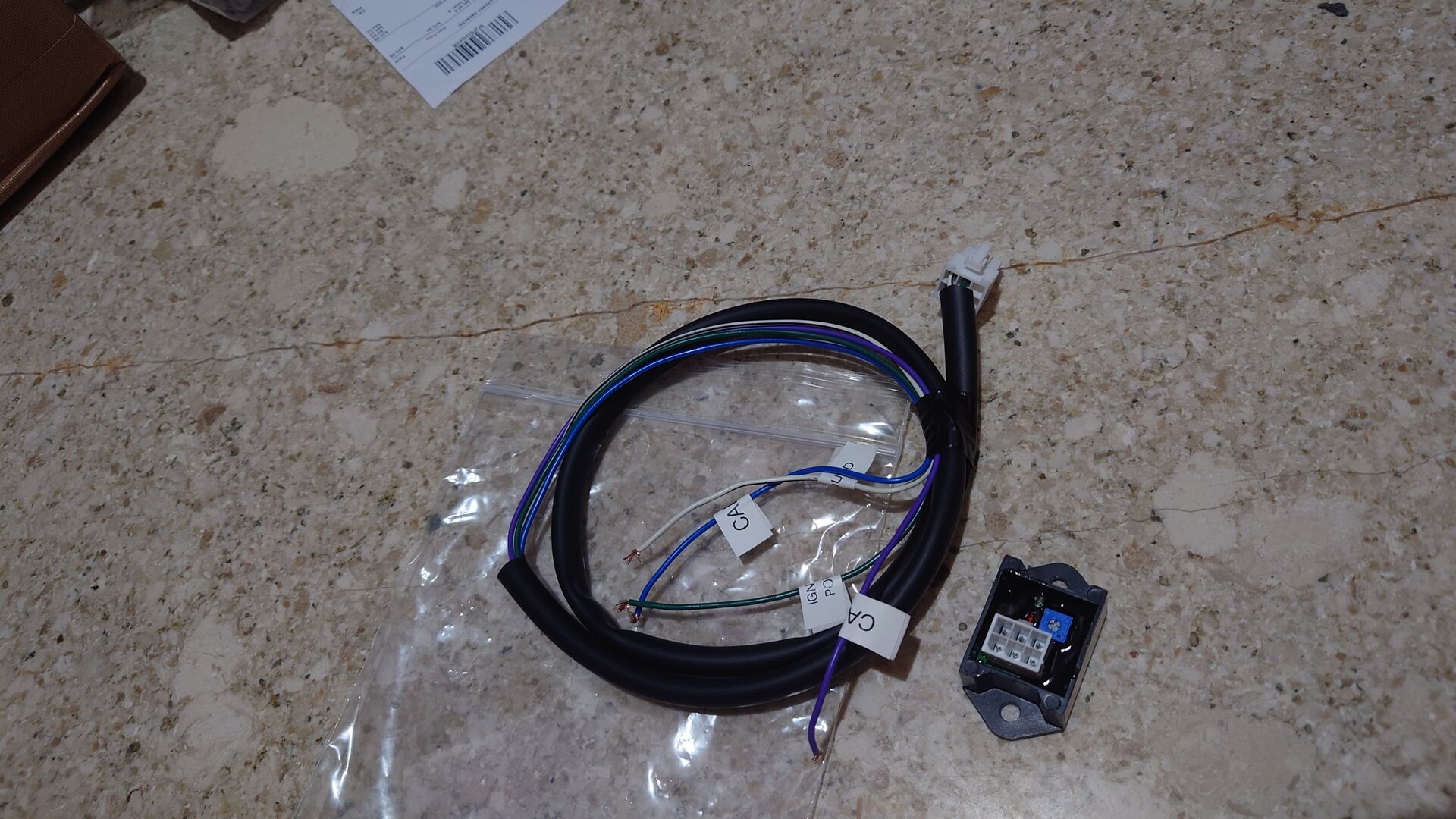

There is actually a box from Japan that may be able to address this issue. So box allows you to fine tune the ride height in a far more detailed manner than that AHC switch can. It can give you up to +70mm of lift and -40mm of lowering.
This is the control unit
Data System Air SUS Active Suspension Control Kit - ASR681II - RHDJapan - https://www.rhdjapan.com/data-system-air-sus-active-suspension-control-kit-asr681ii.html
This is the wiring
The way it works is that it taps into the AHC sensor wires going to the AHC ECU via the adapter harness and modified the signal going in and out of it.
I have bought this one for my dad 2018 LX570 but didn't have the chance to install and test it.
