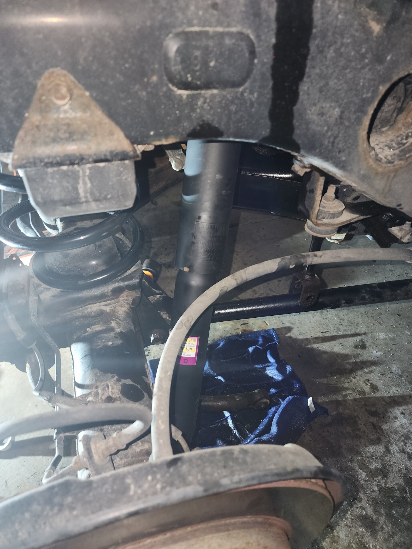

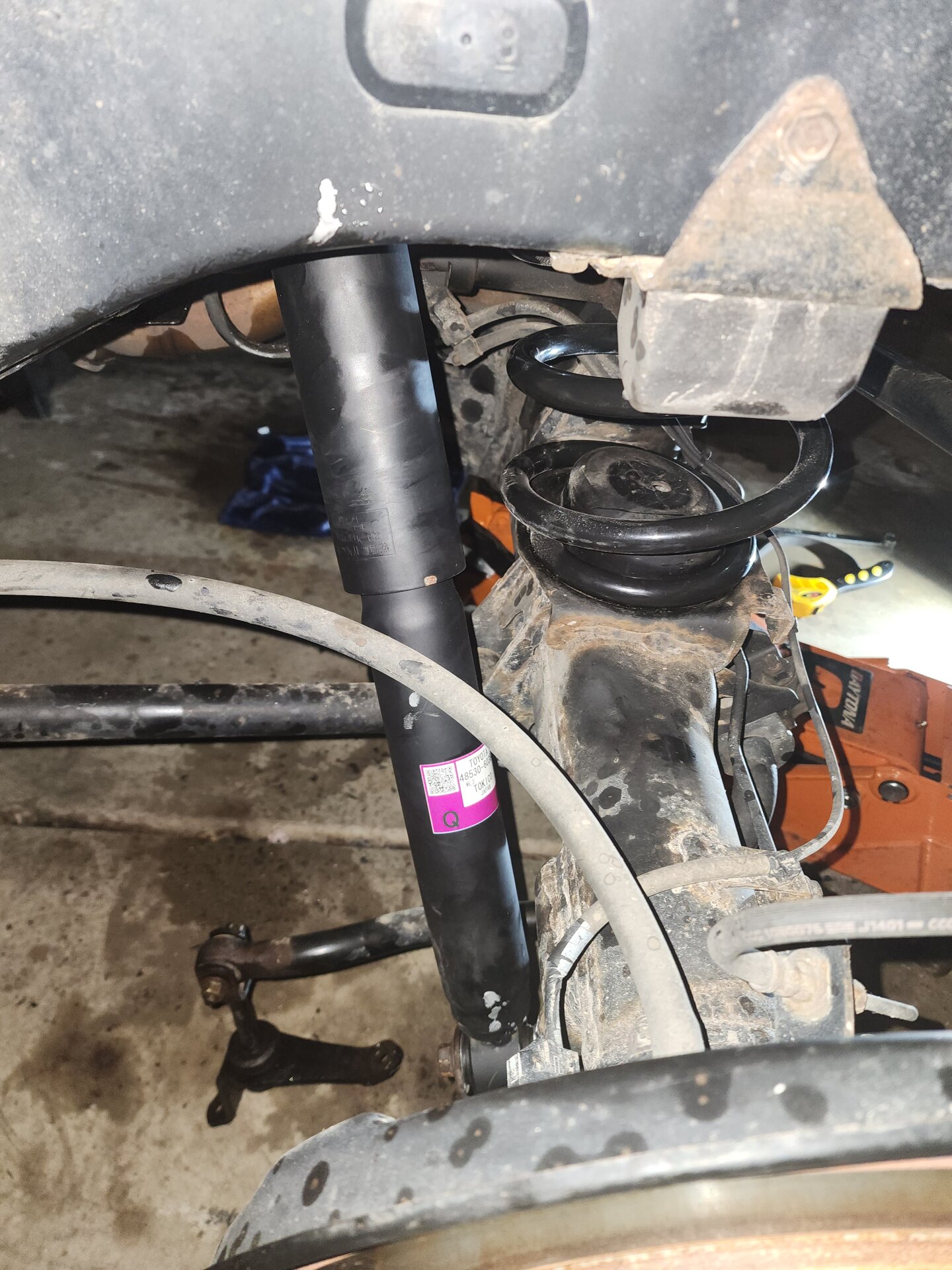

Cutting at the red line would still require another cut to get the top of the shock shaft out. Make your cut at the white line, which is a rubber bushing around the upper shock shaft. It should all come apart at the top mount then.

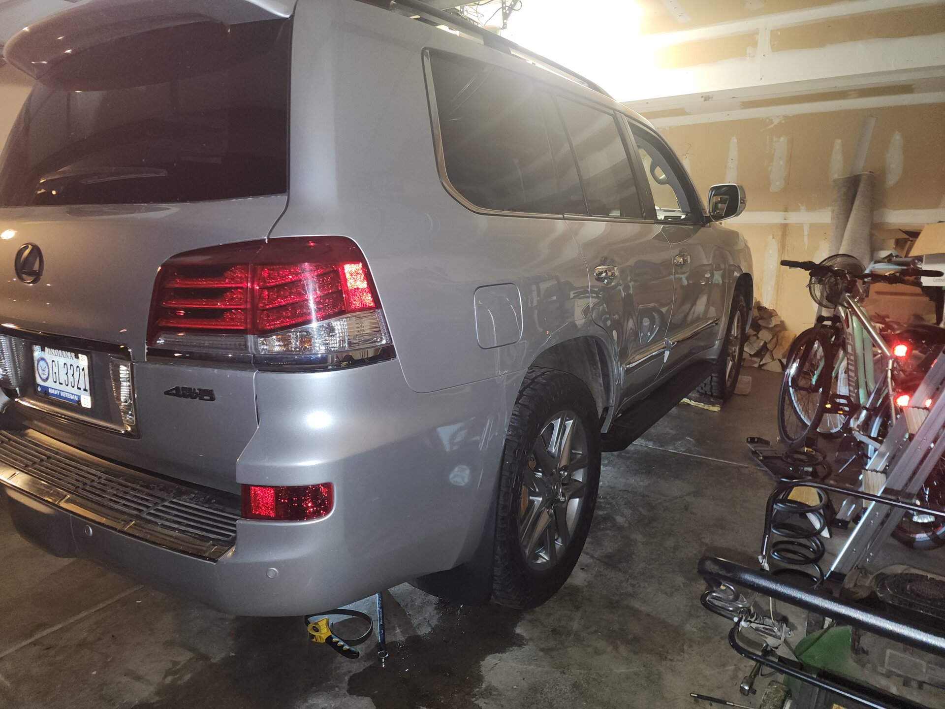

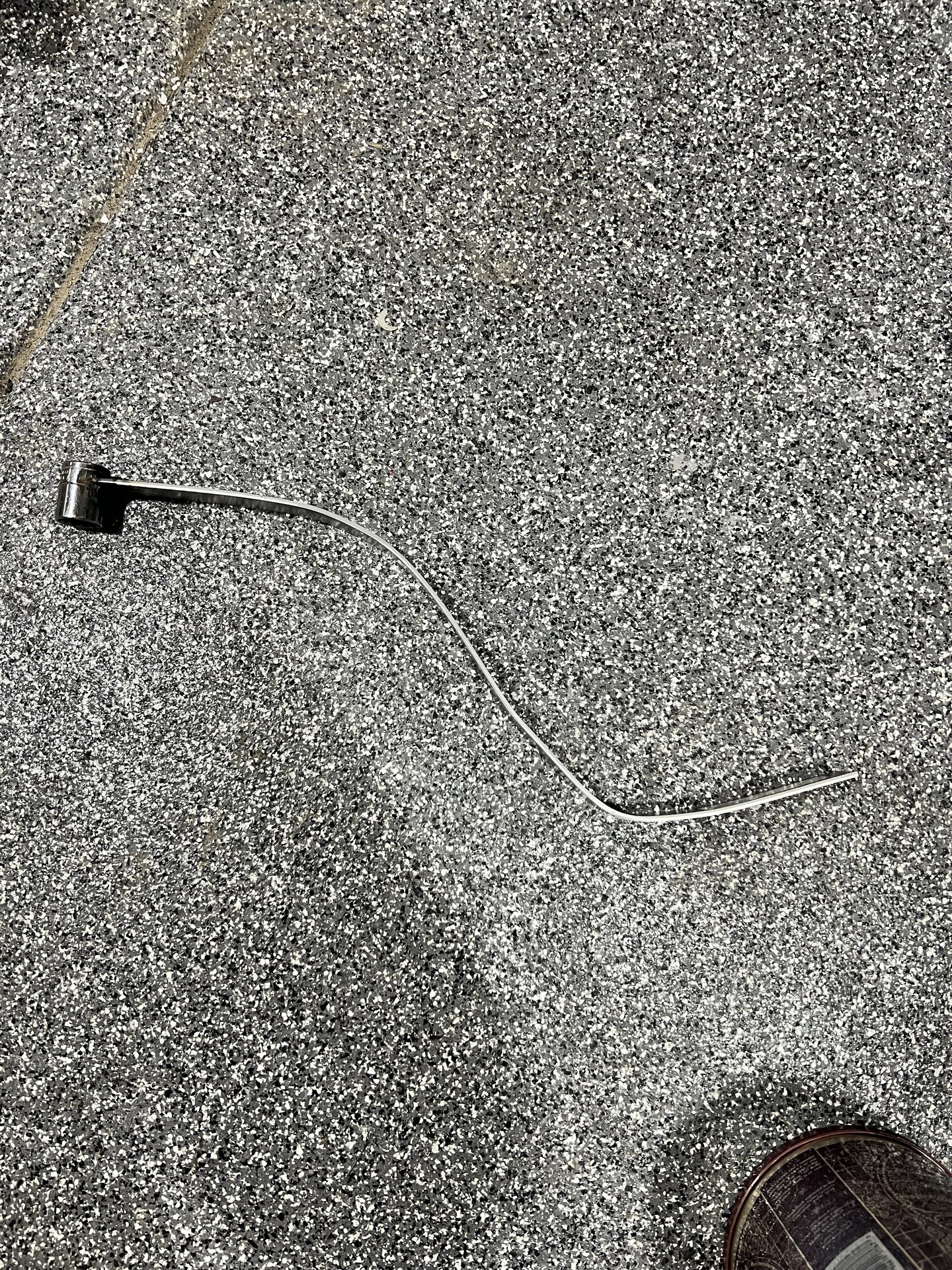

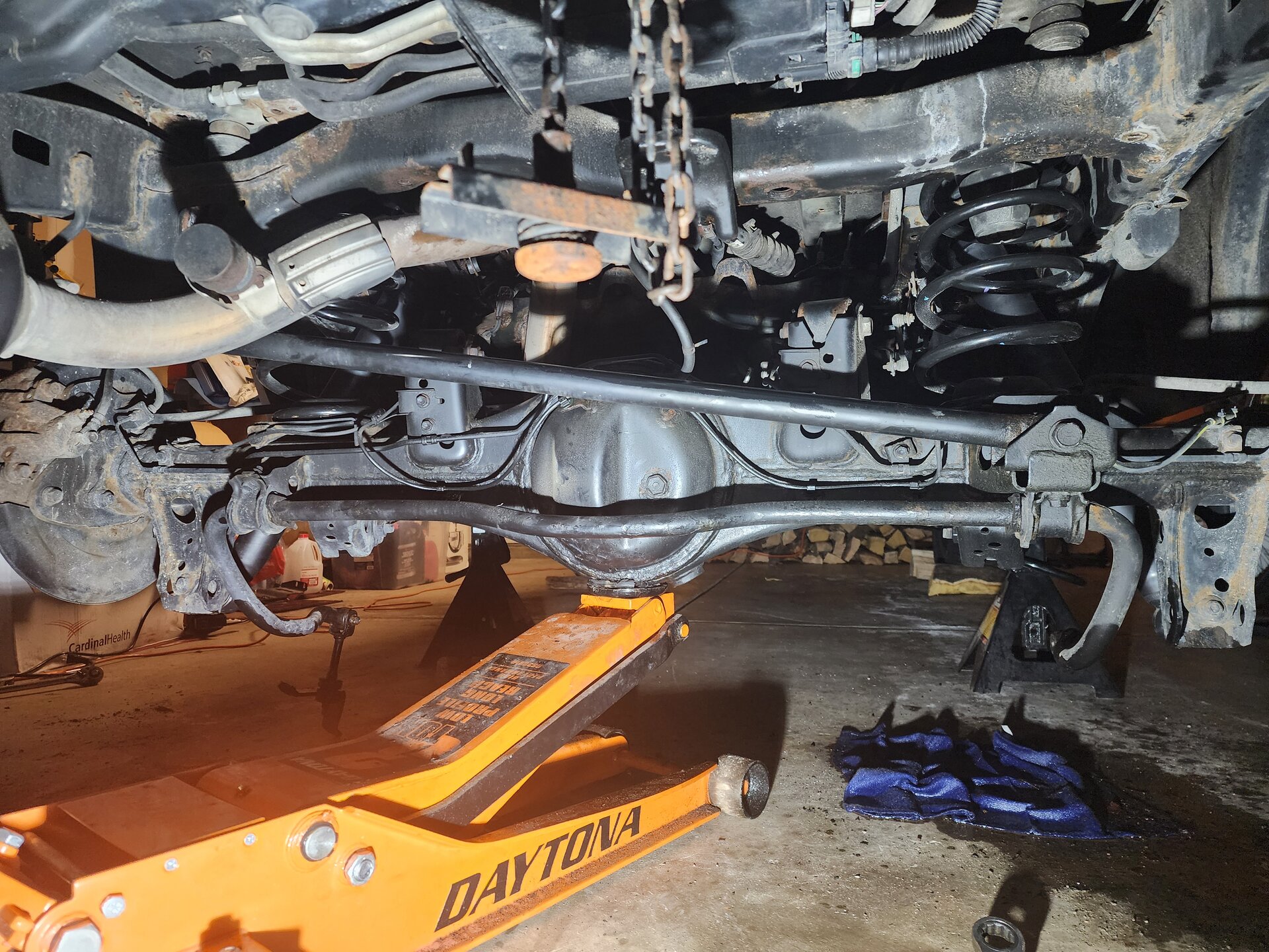

Somewhat wrapped everything up yesterday. I just need to torque everything to spec. Huge shout out to @Wafflroo & @B Hans for recommending the diy breaker bar. All you need to make this concoction is, take a trip to Lowe's, purchase a 22mm standard socket with a 1/2" drive, and a piece of 1-1/4" x 1/8" x 3ft welding steel. Weld it together, and BAM! I also purchased an additional 22mm w/ 1/2" drive socket, and cut off the head of a 14mm bolt and welded it to the top of the socket, just to have on standby.
Unfortunately, as good as these diy tools were, the nuts on my rear shocks were seized on, and I ended up bending the breaker bar. I ended up having to cut the nuts off. The nuts on the LX570 are actually easier to cut off than on a 200 series L.C. With a 12" sawzall blade, from the wheel well with the tires on, you can cut right above the washer before the bushings, and you will cut the nut off, and have no issues removing the shock.

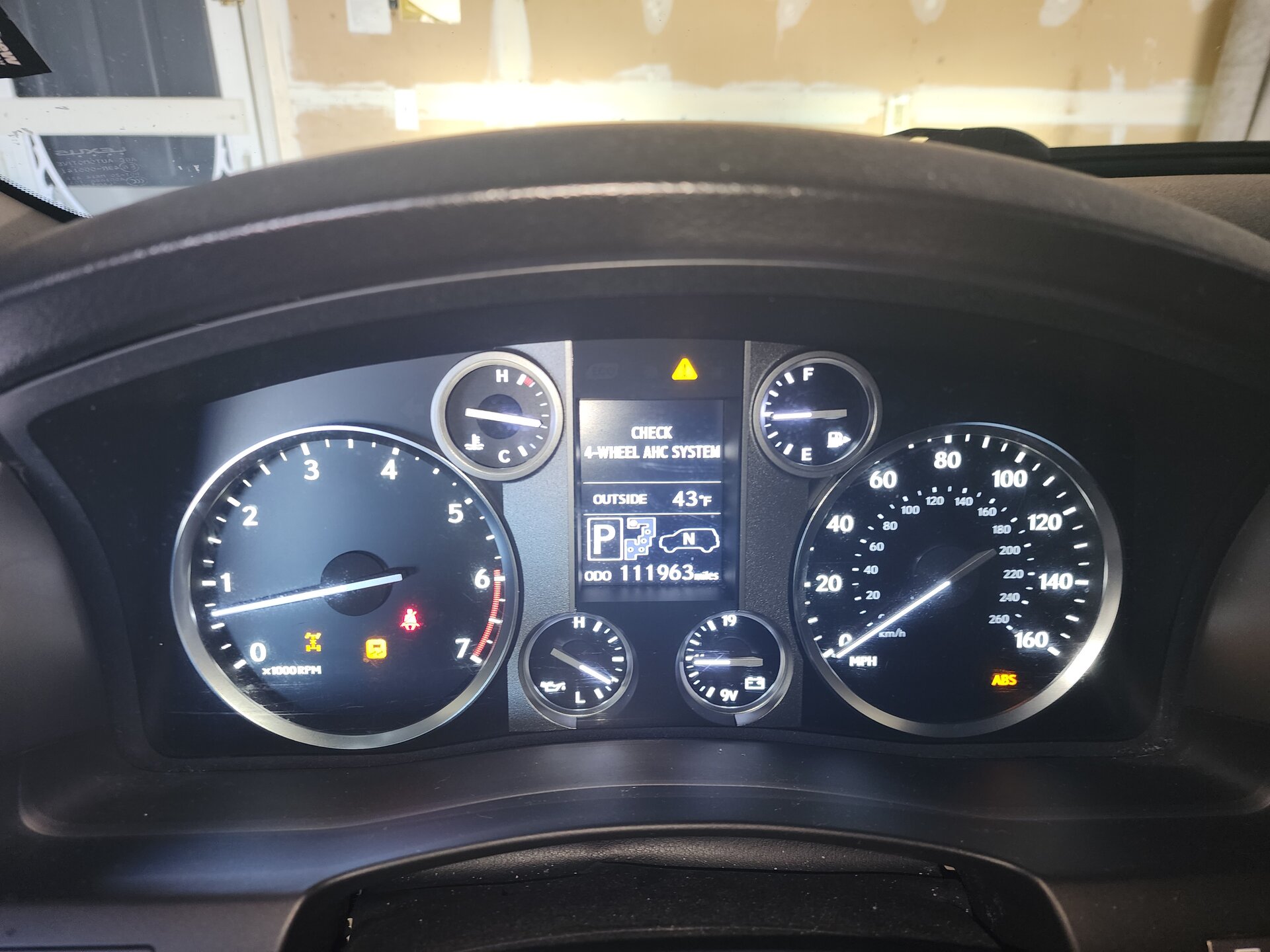

It looks like I am going to have to go back into the front suspension, and remove the OEM spacers because the front is sitting higher than the rear. I also noticed when I turned the car on last nite, not only is my AFS light blinking, but my CDL light is also flashing. This caused my traction control & ABS light to come on as well.
Has anyone had this happen, and if so, what was the remedy? I have not unplugged my battery, anything from the AHC ECU, or the passenger side fuse box yet.

Have you pulled it out of the garage yet? Due to the LCA angle the front suspension binds when setting it back on the ground. It’ll settle quite a bit once you drive it a few feet.
The factory 10mm spacer should level a rig on stick springs nicely.
No I haven't. I'm getting ready to go out there, and remove the 3rd row seats, and unplug the AHC ECU, and pull the two fuses in the passenger glove box.
I forgot about the settling part. Will the front settle more than the rear, and will removing the 3rd row seats help give some lift in the rear?
I also read somewhere on here that the later 200 series models were made to sit more level and that you technically didn't need the front spacers. Do you know if there is anything truth to that?

Settling after being put on the ground doesn’t impact the rear because of the solid axle. I haven’t heard about later ones siting more level.. in fact one of the rear springs didn’t change from 2011 all the way to 2021, though the other did. Third row removal will also increase height noticeably.
Looks great! I'm curious what code is causing the light. Have you reset the battery since deleting everything?
Yes. I disconnected the battery, then pulled everything and let it sit for about an hour while I torqued what I could. I guess I'll just use my OBD II reader and scan for codes and see what it says.
