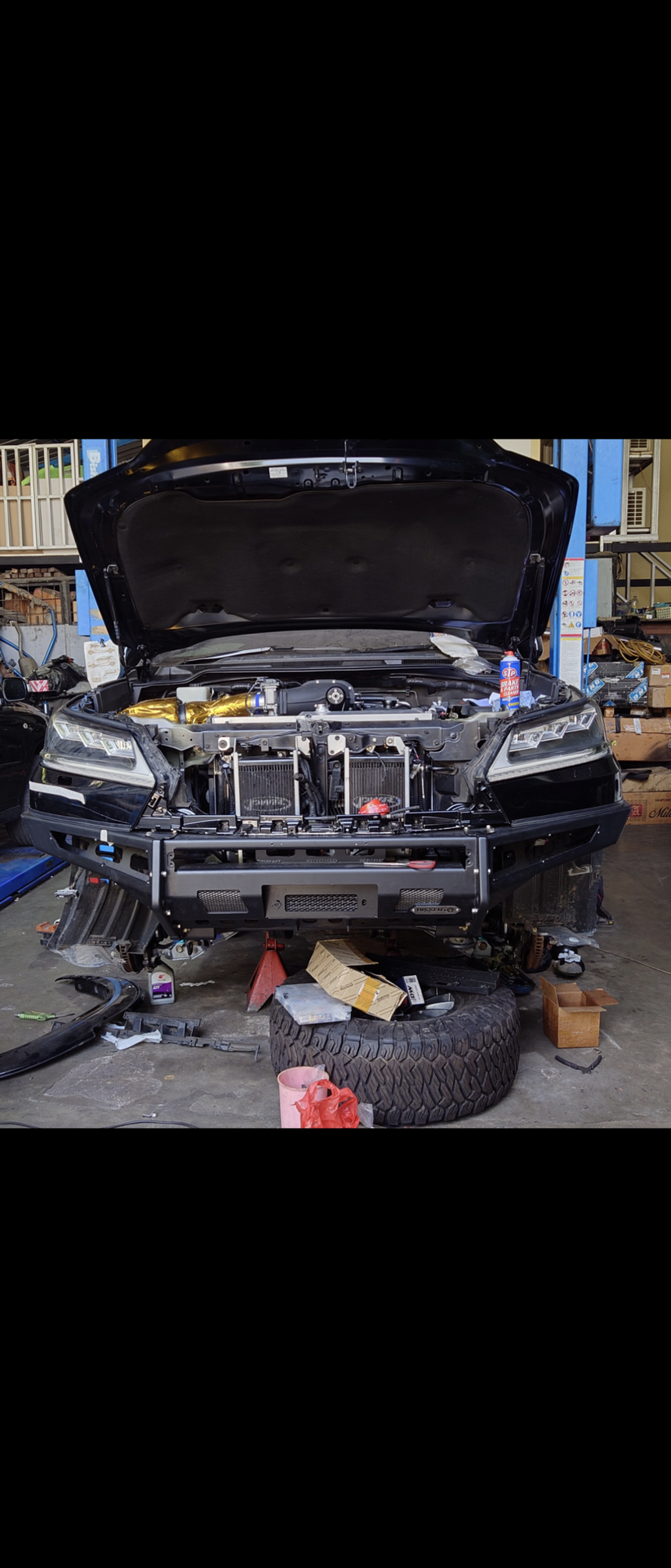

Hi,
I'm in process of building a 2016+ LX570 with 6.0L stroker kit (BC) and Harrop TVS2650 supercharger. Shocks are removed and replaced with King Off-road racing suspension from filthy motorsports - one thing I found out is that the headlights beam leveling piggyback on the AHC control unit's height sensor via lin-bus system to automatically level the beam - if you remove the AHC ECU you will get headlights system error message in the dash - if you plug in the AHC ECU with the relay pulled off, you will have the AHC error message pop-up in the dash. I'm in a bit of predicament so if there is anyone successful in removing the AHC ECU off the 2016+ MY please shed a light on it 🙏🏻🙏🏻
Hi,
can't wait to see more. It might be different with 2016+ but folks have kept AFS by keeping the height control sensor on the UCAs. Have you tried that? Sorry if I missed it.
Interestingly the 2016 does not have an AFS fuse, and the height sensors are also wired in the control unit through 2 sockets as opposed to 1. The ECU communicates the height sensor to other control units via can-bus network, including the headlight leveling system. so the choice right now that can figure out is that:
1. unplug AHC and have the headlight error pop-up in the dash with beam leveling not working; or
2. plug the AHC and have the beam leveling work-ish but have an error for AHC pop-up
I'll do some more experiment and share it here.

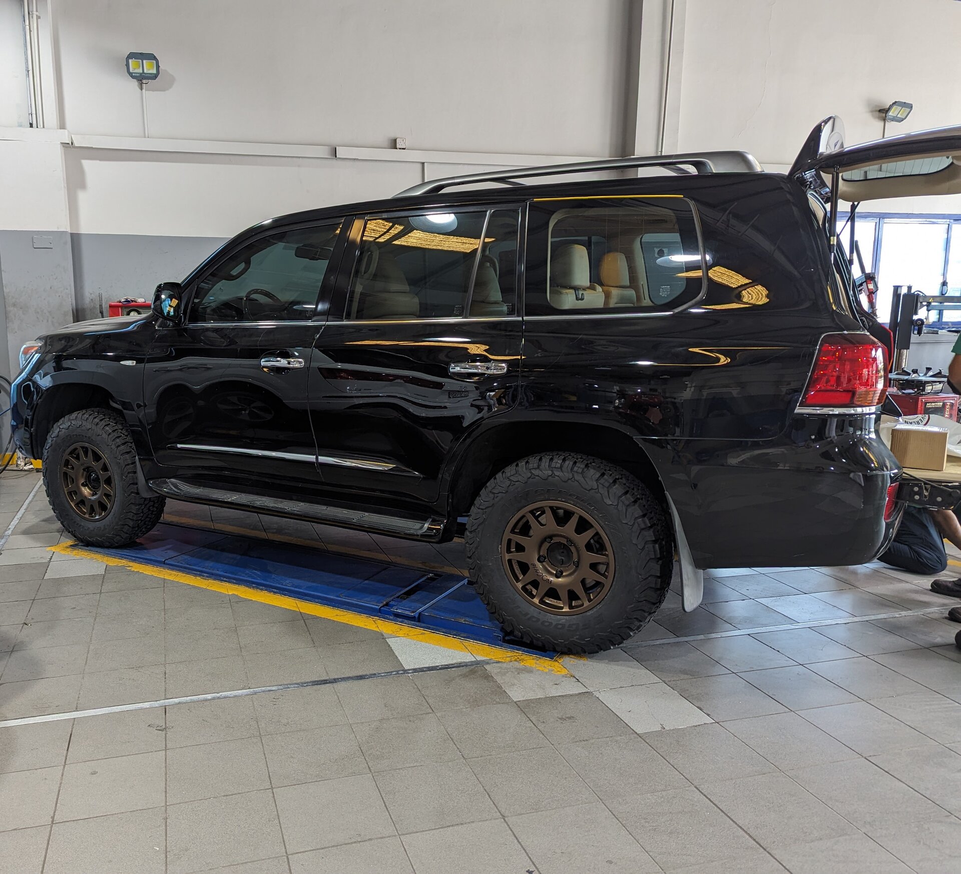

I recently completed AHC Delete on my 2010 LX, and can help clarify a minimum viable configuration for successful deleting. This may vary depending on the desired height of lift, year of lx, and brand of suspension purchased. I personally went with a ~2" lift from a Bilstein Kit which is designed to utilize stock UCA.
I'll list out the parts I purchased, as well as the tools I used and mark them either required or recommended.

Overall I had a successful Delete with 0 lights on the dash and functioning AFS. Truck was able to be aligned and rides great with a slightly stiffer ride at low speeds (similar to the old high mode) but with improved steering feel and handling on the highway.
**The only issue with the install is that the design of the rear shocks do not work properly with the rear sway bar, and I am currently looking for a drop kit, which only appear to be available in Australia (Rear drop kit example) the rear sway bar does not contact, but it it a bit close for comfort. I deleted it temporarily and the vehicle handles fine for now

Going to pick up my kings from filthy Motorsports today. Excited to rip apart my lx and be done with ahc. I’ve enjoyed ahc since I bought my lx just over 4 years ago. Never felt like it was as good as it could be if Lexus had optimized it for off-road use. I think it’s meant for street use mostly. Not trying to stir the ahc pot, I know people have very strong opinions on the subject.
I bought lc kings for mine, so nothing crazy with extended travel or swapping the front end to tundra control arms and coilovers. Has everyone who swapped to lc parts kept their brake lines stock length? Or am I going to need to address the length of the lines (swap to some extended lines)?
