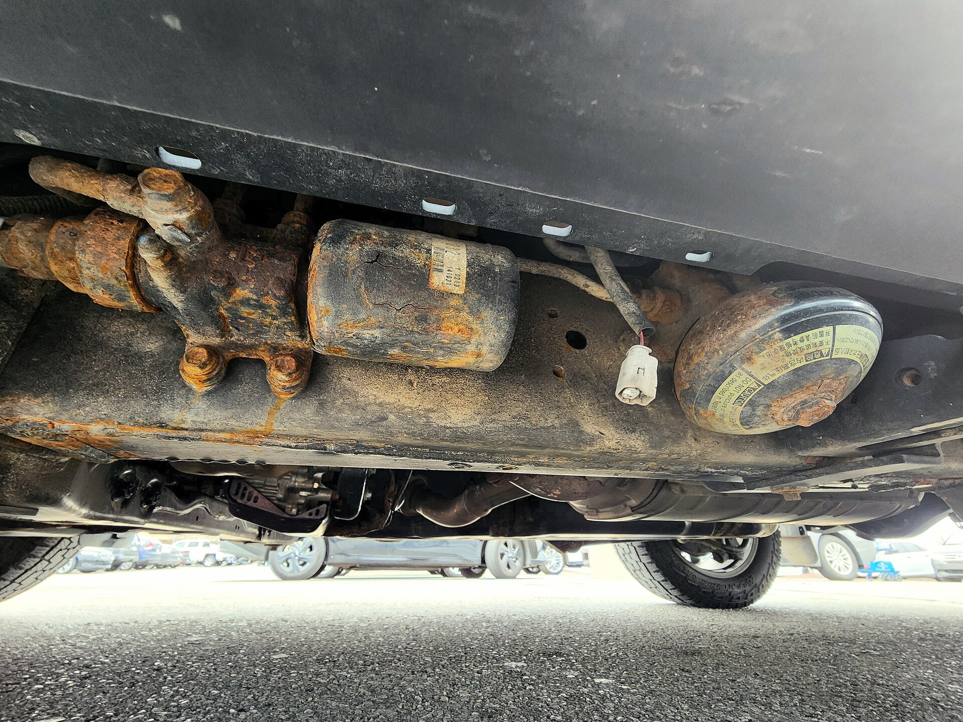

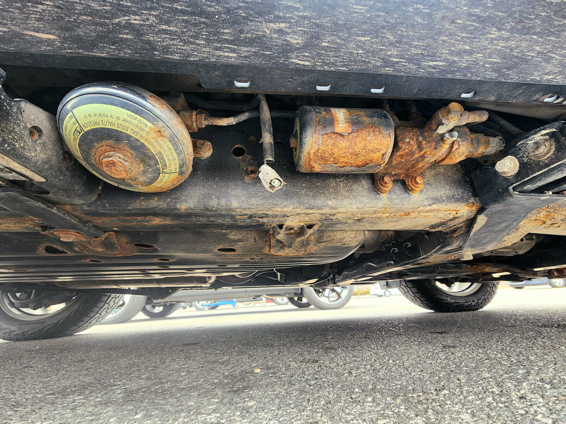

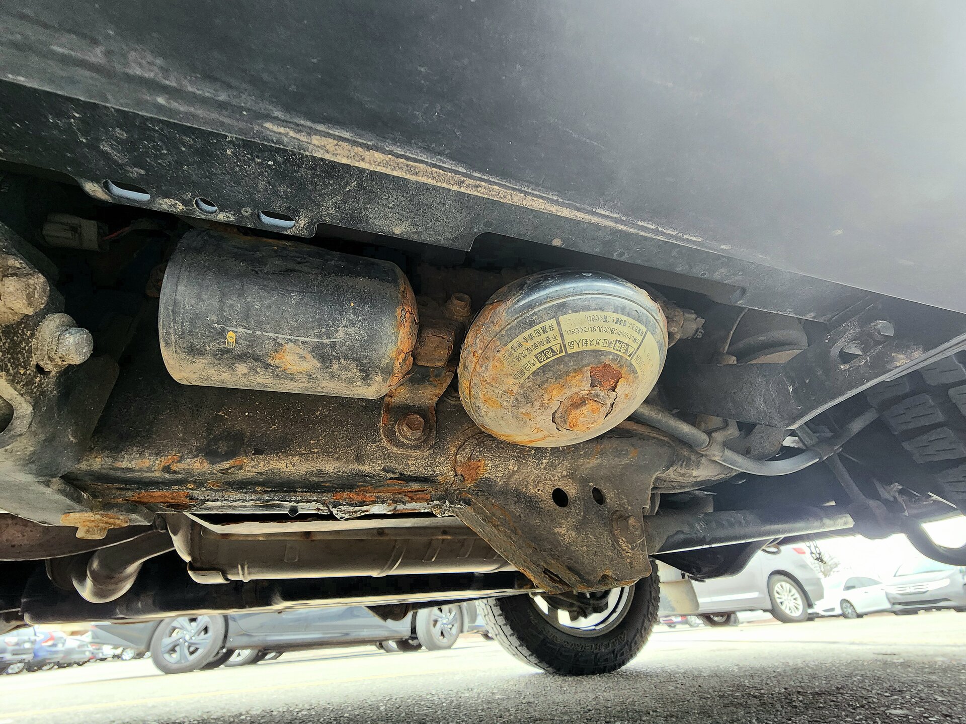

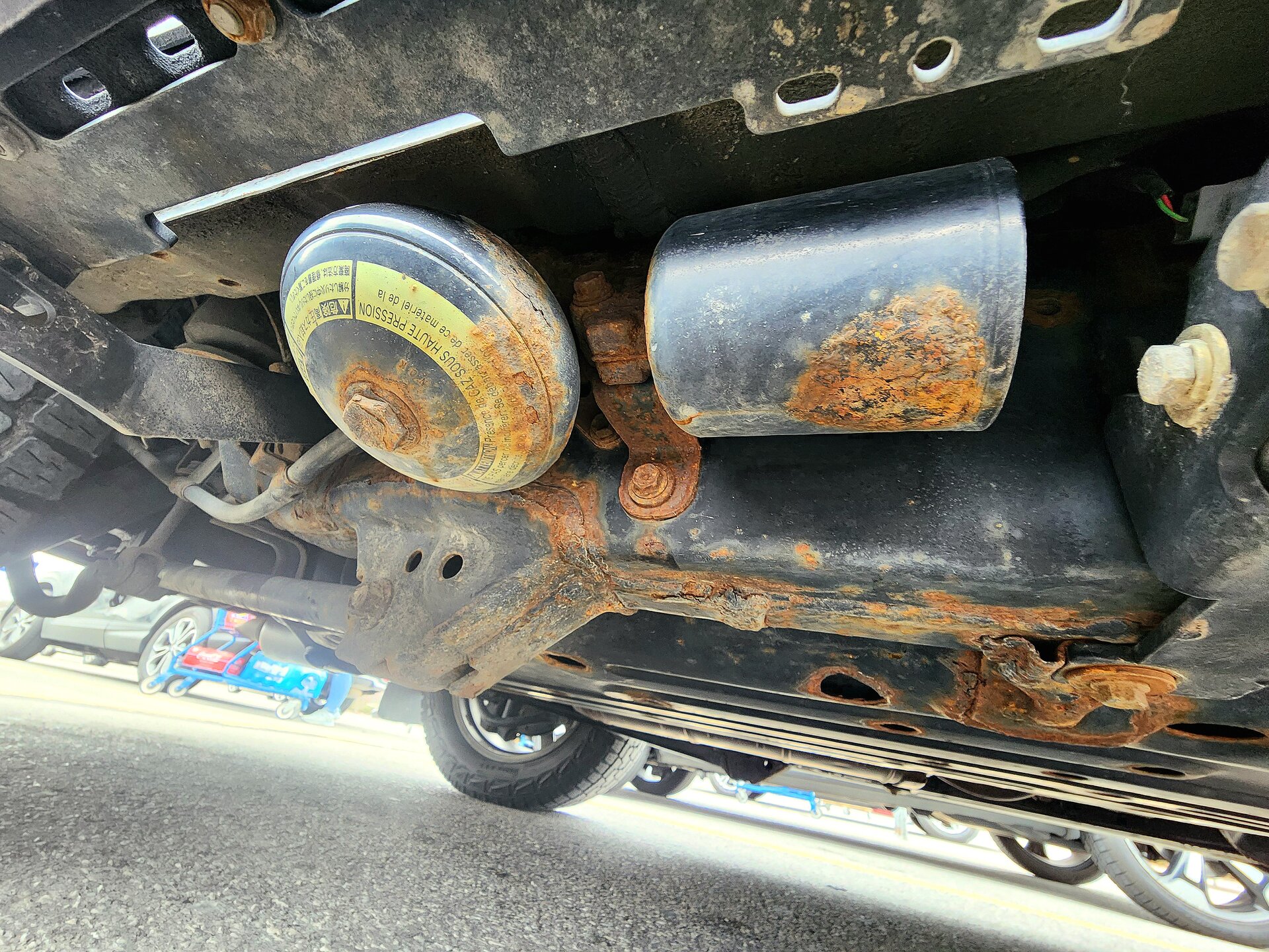

I know a few of you encouraged me to just change out the line that went bad, but I spent 4hrs in the garage last night, wrestling with this line that needs replaced, and it will not budge! The connectors on both ends of the line that needs replaced, are so seized on. But it's not just line.
After removing the plates from the Slee rock sliders, and actually being able inspect the accumulators, and bleeding valves, and being able to climb under the rear to work on the busted line, it's blanantly obvious that $6k-$7,500 was not spent replacing anything on this suspension system. Everything suspension wise is rusted! The rear passenger side shock, has a hole in the top of the shock.

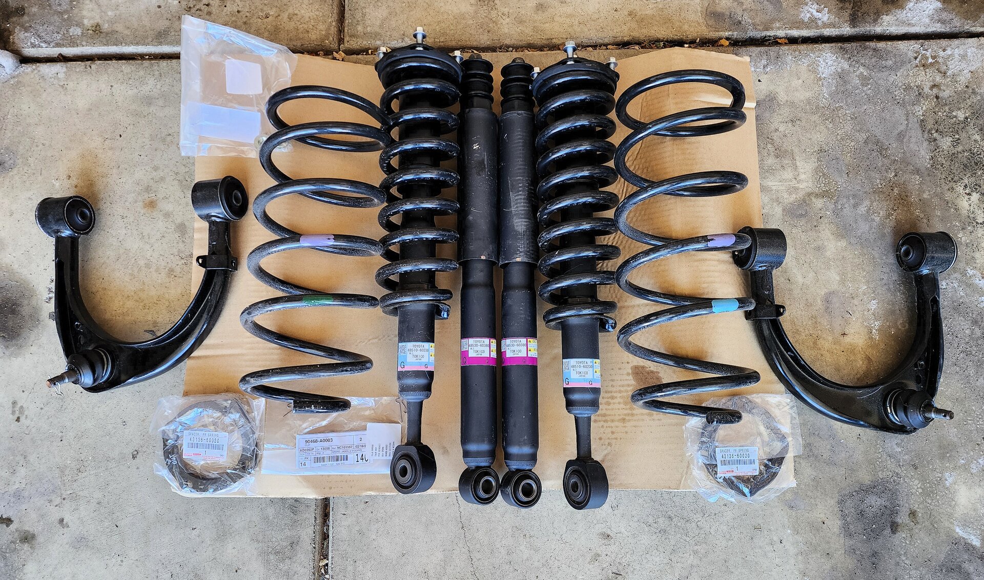

I ended up getting a pretty great deal this past Friday on a set of 200 series L.C. suspension that has maybe 5 miles on it. The Cruiser it came off of had OME BP-51's installed on it fresh off the truck at the dealership before the Cruiser went out on the lot. It may not be a set of BP-51's, Icon's, or King's, but it will get my Lux back on the road until I can get a suspension system installed that matches the comfort the AHC suspension had.

Decided to take advantage of the nice sunny westher we had today. Took 3-1/2hrs to remove the old AHC shocks, and install the new 200 series L.C. shocks & OEM spacers on the front.
