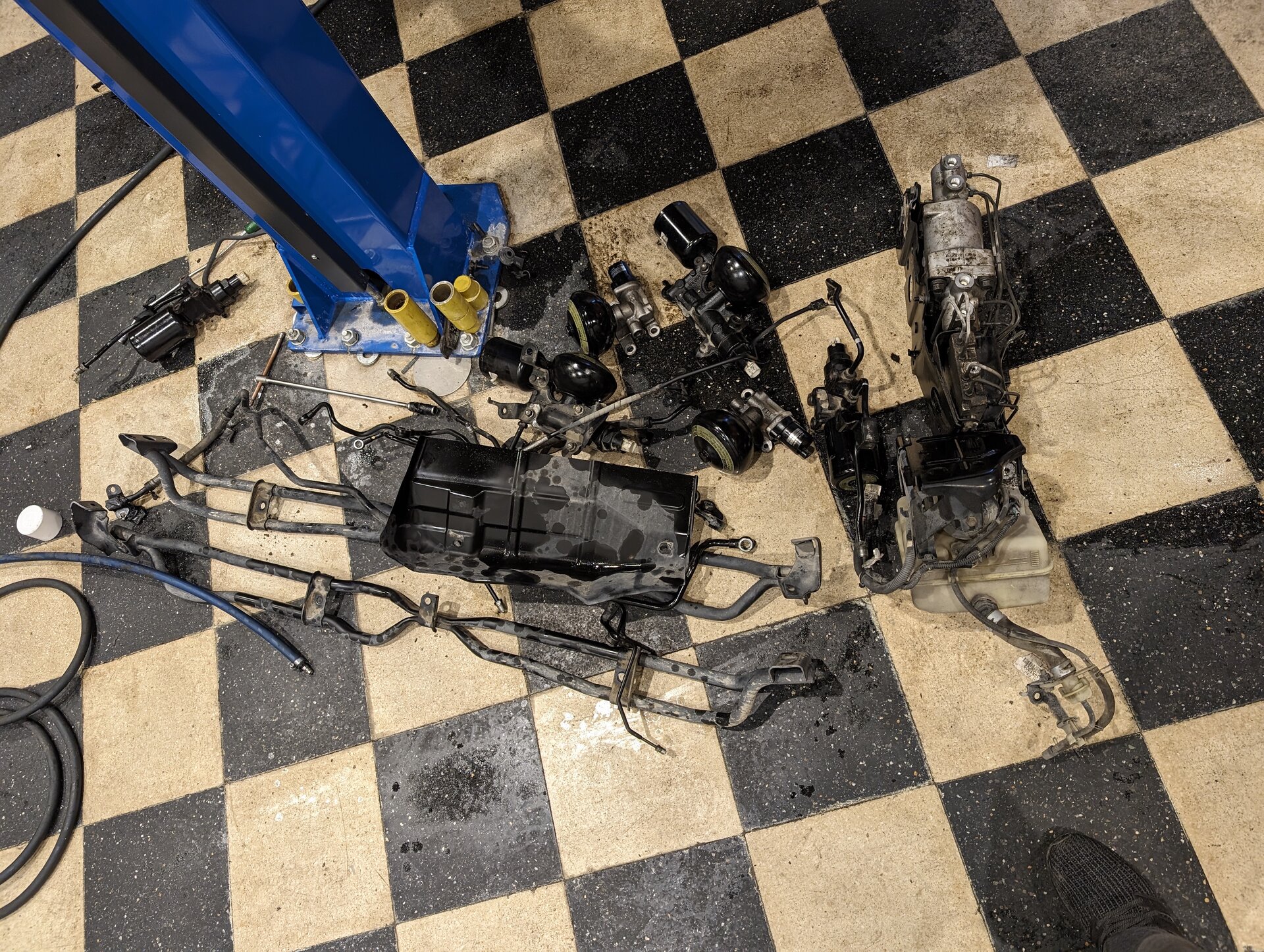

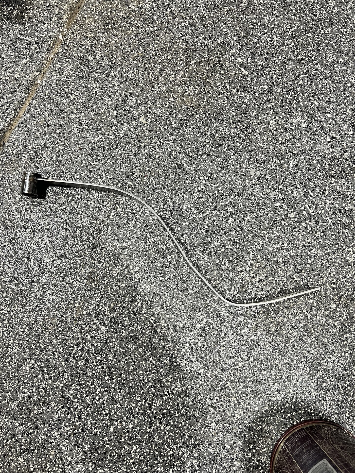

Got to take out all AHC parts today, only kept three lines: two going from the main AHC pump on the driver’s side over the gas tank crossmember to the passenger side, and one from the passenger rear shock to the frame rail. Any one managed to remove them without drop the fuel tank ? @turbo8 @B Hans

Keep the main switching valve please. These are very hard to find and usually rust damaged. It’s the box on the right with many little lines looping back to it. Please put it up on the buy forum

I already sold the whole system damaged as is months ago. just kept the parts as I didn't have time to remove them.

I believe I got all the lines out, it required cutting the lines in multiple different places.
How much does that pile of AHC weigh?
If I had to guess, somewhere around ~330lbs maybe

As I remember a couple of the trickier lines that run over the tank are actually multiple pieces and could be taken apart. I don't think I had to do much cutting but did require some creative bending and pulling pretty aggressively to remove some of the more stubborn pieces. But I was able to eventually remove everything. The big hang ups are some of the clips that hold the lines to the frame, some of them are pretty well hidden but once released it becomes somewhat easy from there.

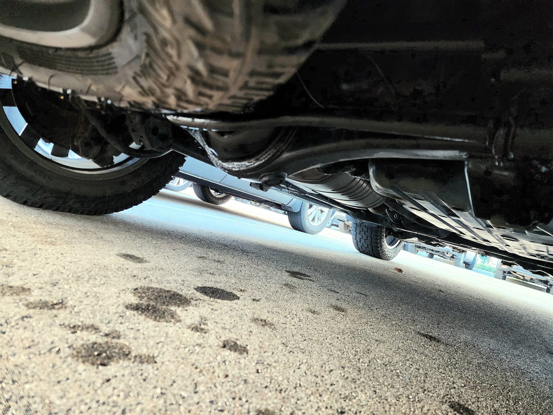

Got a picture of an oil stain in the driveway, from my girlfriend while I was at work earlier this week. Went outside to my LX to inspect it on my dinner break, and I noticed fluid leaking from my rear axle. After prodding around, I found a leaking suspension line in the rear that runs over the exhaust. As soon as I pulled up to the 4 way stop by my house, the warning light on my dash gave me the confirmation. The AHC was nice for the 7,000 miles I had, but I'm not shelling out the coin to get it fixed, only to have another issue pop up down the road.

That line is a common failure point and is replaceable. A full delete will be more expensive than replacing that line and bleeding the system.
