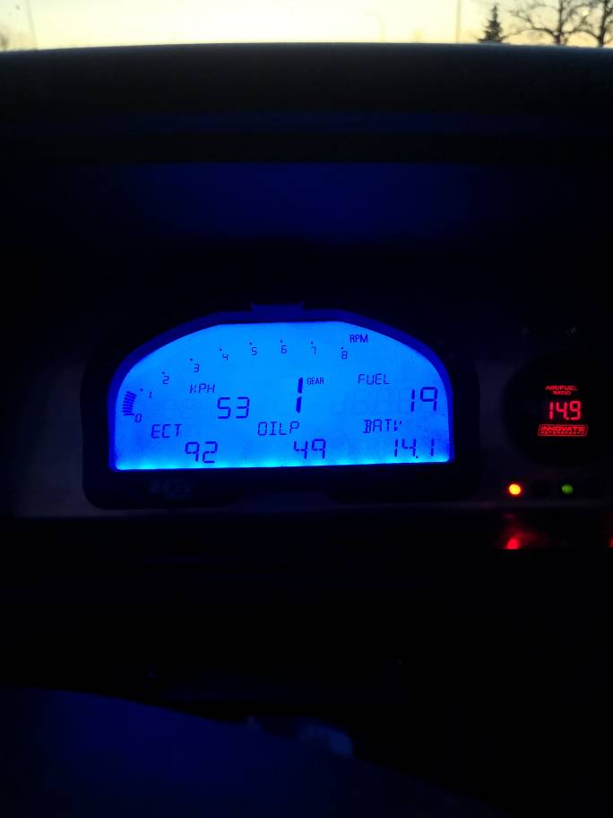

sorry to bump an old thread but I finished my racepak setup and got a few miles on it! Other than the blue being a bit distracting at night its really nice, i do wish it was a little bigger

I himmed and hawed back and forth for like month on staying stock and using some actual gauges or just going full on with a racepak. Im really happy with my decision to go with the racepak, every morning I wake up to the sound of an american V8 roar and a racepak that displays "good morning joe" hahahahahahha
All in all, its a luxury not necessary to all, but I dont want to lose my 8-10k built LS to low oil pressure relying on a bar gauge

So when it says 19 on the gauge for fuel, what does that mean? Does that mean 19 liters left in the tank?
percent, though I could scale the gauge to work however way I want! Its a custom measurement system, Ill probably drain the tank this weekend to get a true calibrations but I set it up based off the FSM 3 ohms is empty 110 is full, just builds a chart based off the resistance
however the 2 buttons in the top right I can enter calibration mode and when its empty or full I can set it, this next fill Ill do a full calibration to be positive
the gauge has a factory 499 ohm pull up resistor to convert it voltage
