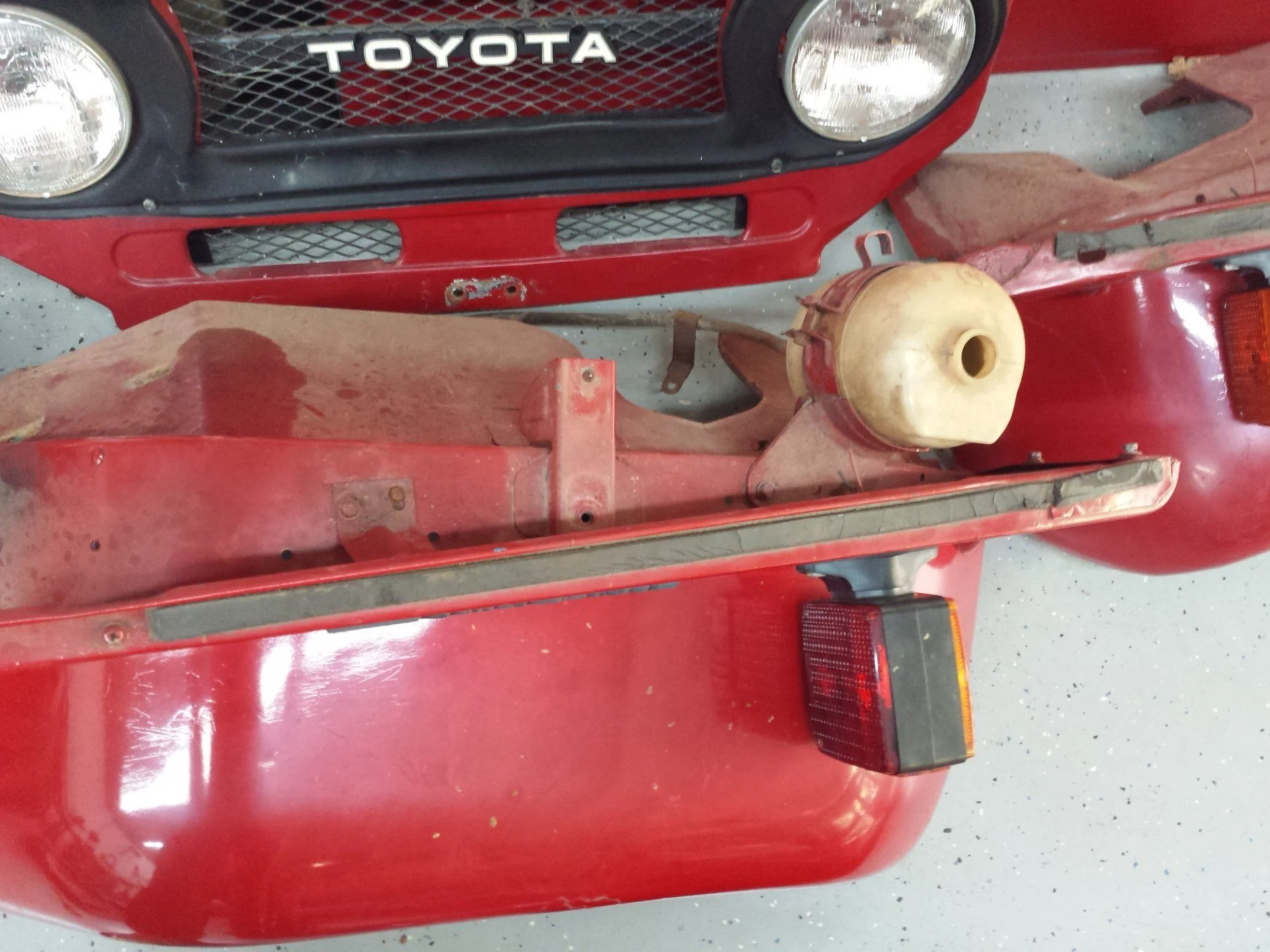

This was my 77 coolant bottle prior to restoring. It appears your fender has these holes. I can take some better pictures tonight if that helps. The coolant bottle is available from @Racer65 as an aftermarket replacement. My 77 had the wiper washer on the driver fender near the firewall. I think later models had a wiper/coolant bottles mounted together near the radiator. HTH

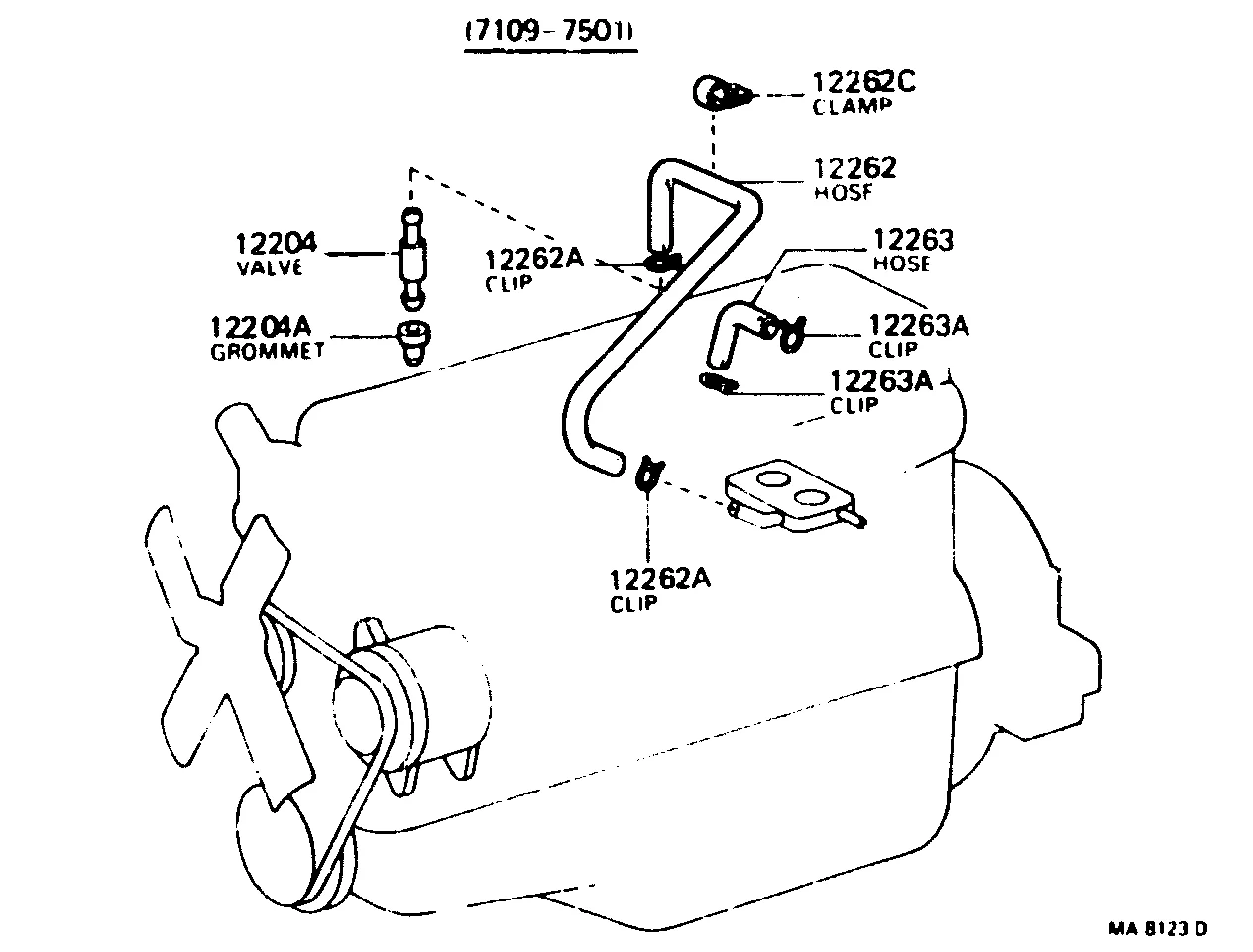

The hose you pictured appears to be no. 12263 from the diagram below, connects the F engine valve cover to the air cleaner horn. I would like that as well.
The other hose, shown below, 12262, is one I need as well (and I thought it was red in color, but I may be wrong.) If you have the clamp, 12262C, that would be great to have as well.

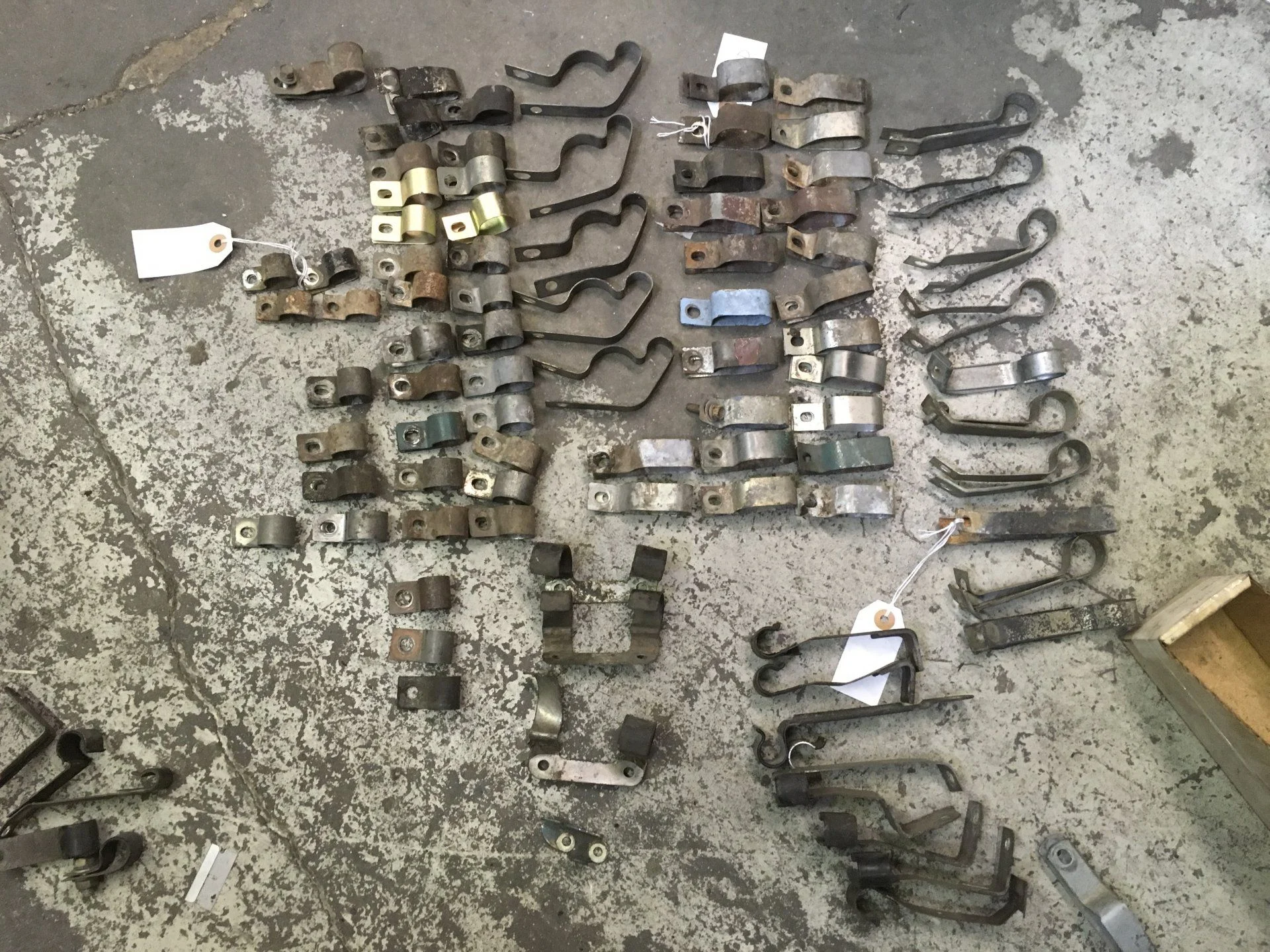

I pulled out four bin boxes of clamps from three different parts of the shop ( I think there are at least two more) for this pic. Like I said, the five 'B' shaped ones in the middle were stock for '73 with air pump. The ones to the left are candidates, but are heater hose size. And an 8mm bolt will not pass thru them. Finally found 8 of the PCV hose sized ones.
