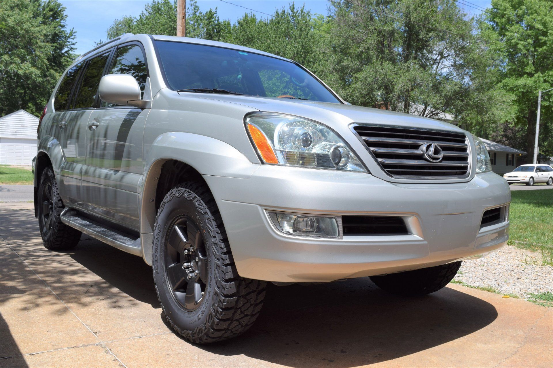

The first of the big ticket mods showed up today. 265/70/r17 Kumho MT51's
I also stopped by the powder coaters and picked up the wheels done in satin black. Like most people I don't like the factory GX wheels, the painted aluminum just looks cheap on these vehicles. I also don't like the thinner spoke aftermarket wheels as they just look a bit off to me. I was looking at a friend of mines Tacoma and kept thinking that the big face of those factory wheels would look good paired with the large side profile of the GX.
I'm hoping this will make for a nice looking combination.
Are you running spacers with those wheels?
