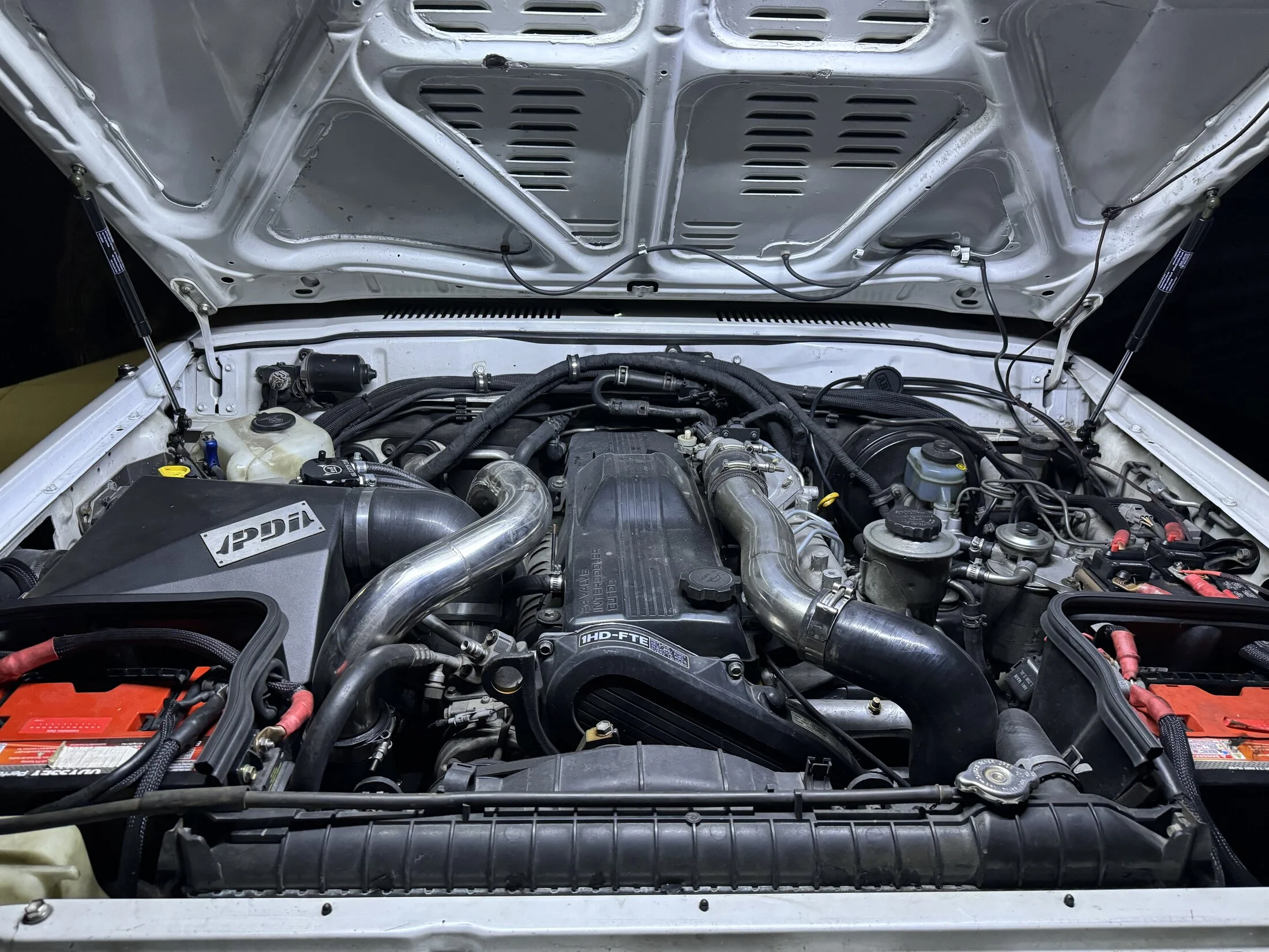

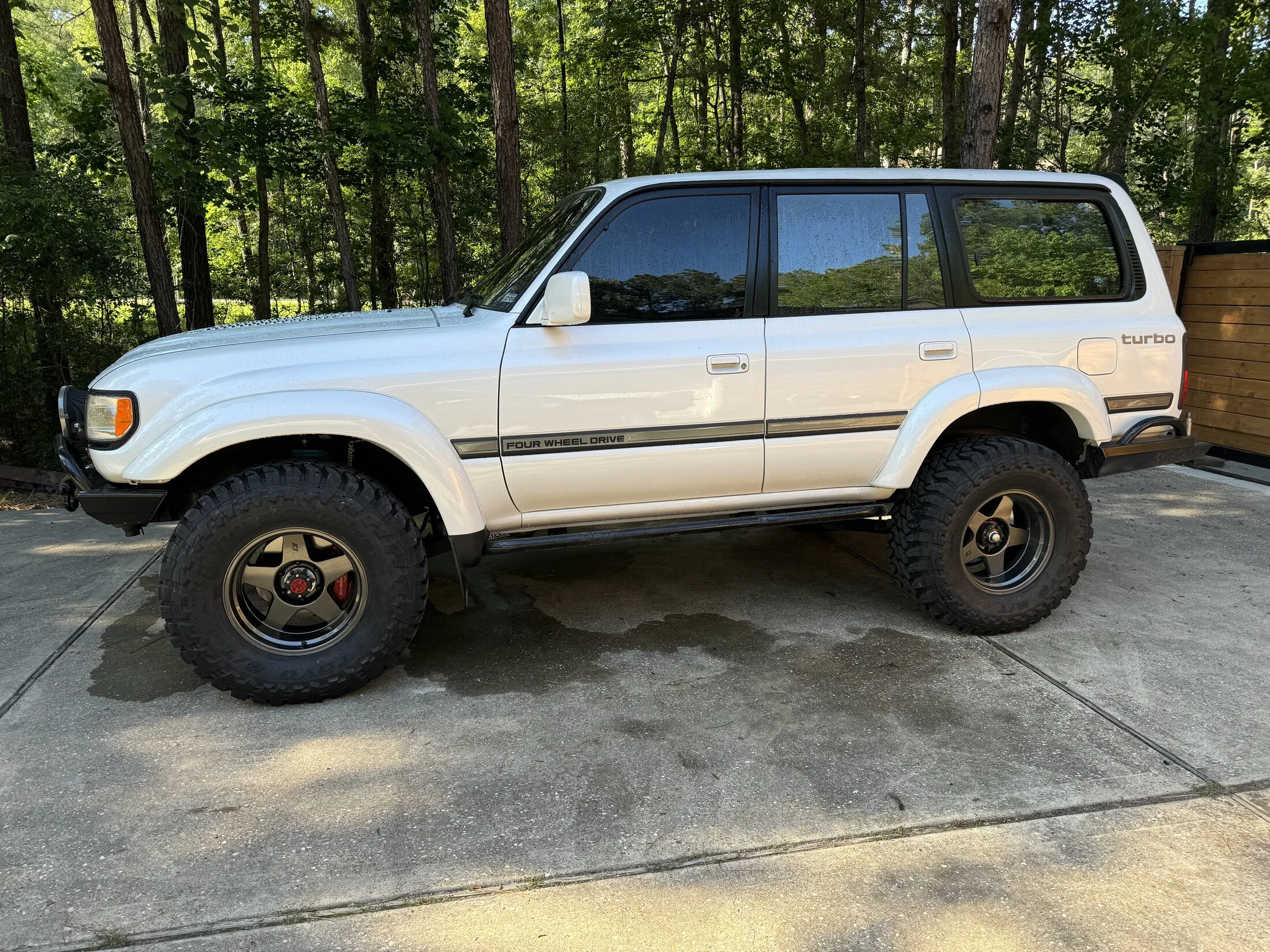

1997 lx450, decladded & debadged
1hd-fte, ARP head studs, crossover delete
New hdj79 ECU
PDI FMIC and airbox
gturbo blue wheel & +70% injectors
Unichip piggyback
http://1hdfte.com.au harness
HDJ81 radiator
H152F 5-speed / part-time case
e-locked axles w/ RCV 30-spline chrokoly inners and birfs, AISIN hubs
Dobinsons variable rate springs w/MRA shocks
Whiteline swaybars
35x12.50R17 Toyo Open Country MTs on 17” x 9” SCS wheels
Scheelmann front row
@Bellfab spare mount
@Lutz Auto multigauge clock replacement and speedometer correction
Tom Woods rear driveline
@Delta VS panhard bracket, radius arms and consoles
Manta 3” exhaust
HID headlight conversion
Slee Short Bus front bumper
IPOR sliders
Slee rear bumper
Powerstop calipers & rotors
LRA 42gal aux tank
Next steps:
Dissent rear bumper
Custom front bumper
Hd81 tachometer
Enable cruise control
Enable electronic boost control
Find/fix the exhaust rattle
Thanks to @samc2447 for all fixups
