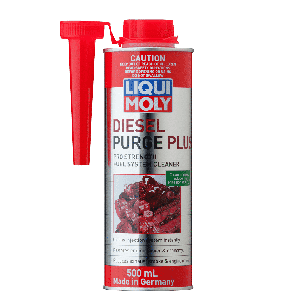

  • I prefill my new Fuel Filters with Liqui Moly Diesel Purge Plus
  • I run mineral two stroke oil at a 200:1 ratio in my diesel
I have no science behind this, its just cough medicine. I like to think I'm doing the fuel pump and injectors a favor.
There's also a Liqui Moly Super Diesel Additive, no idea the differences between it and the Diesel Purge
What is Diesel Purge Plus? can't find it on their website.
This is not an additive, its designed to be run directly into the injection pump
I use the "Diesel Purge", and pour it into the fuel filter. Maybe this is the same stuff but more potent.

Liqimoly is to clean your injectors and pump, not as an additive.
