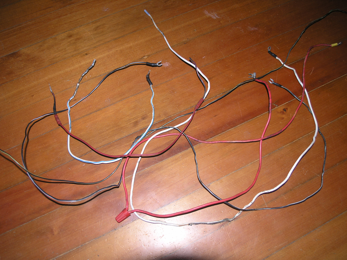

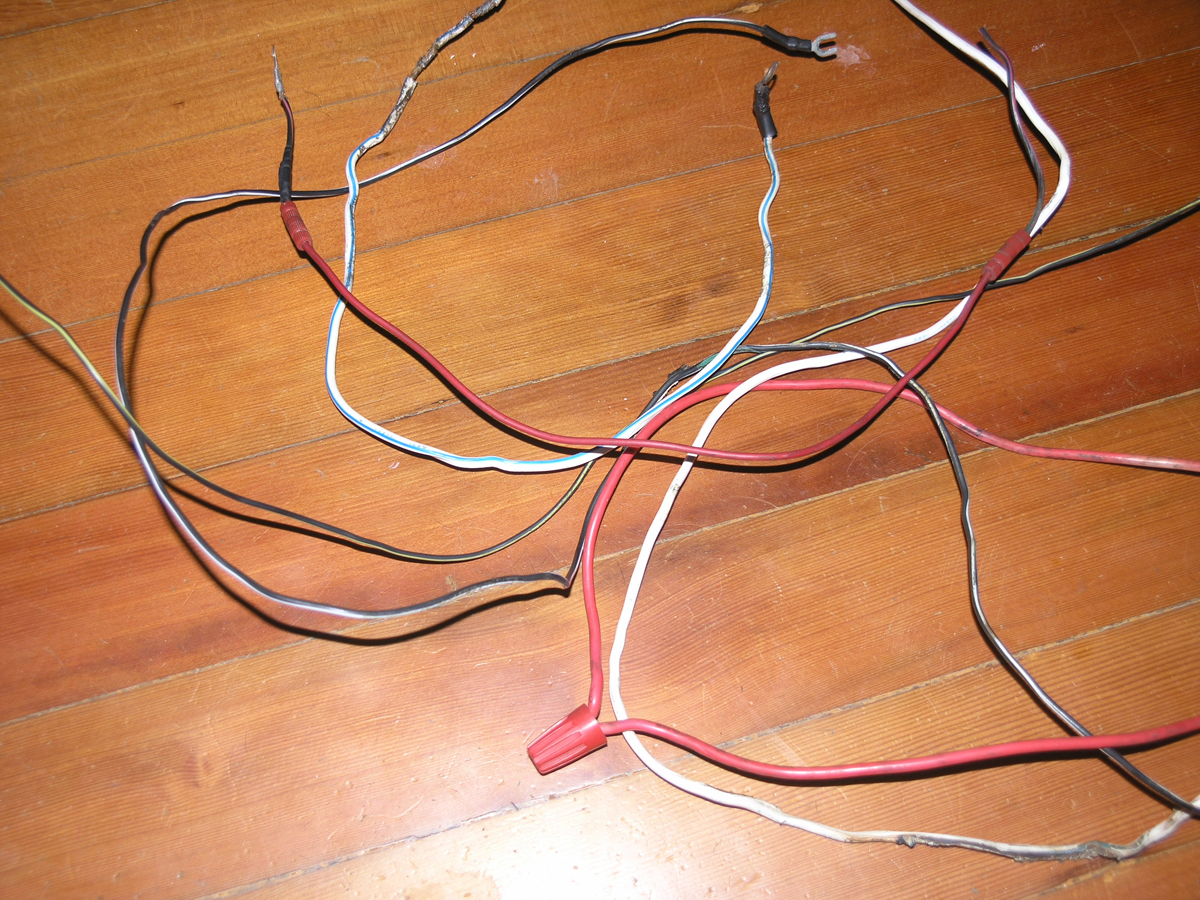

here where the power and ignition wires i replaced to eliminate any weirdness from that, man they were ROUGH looking :)

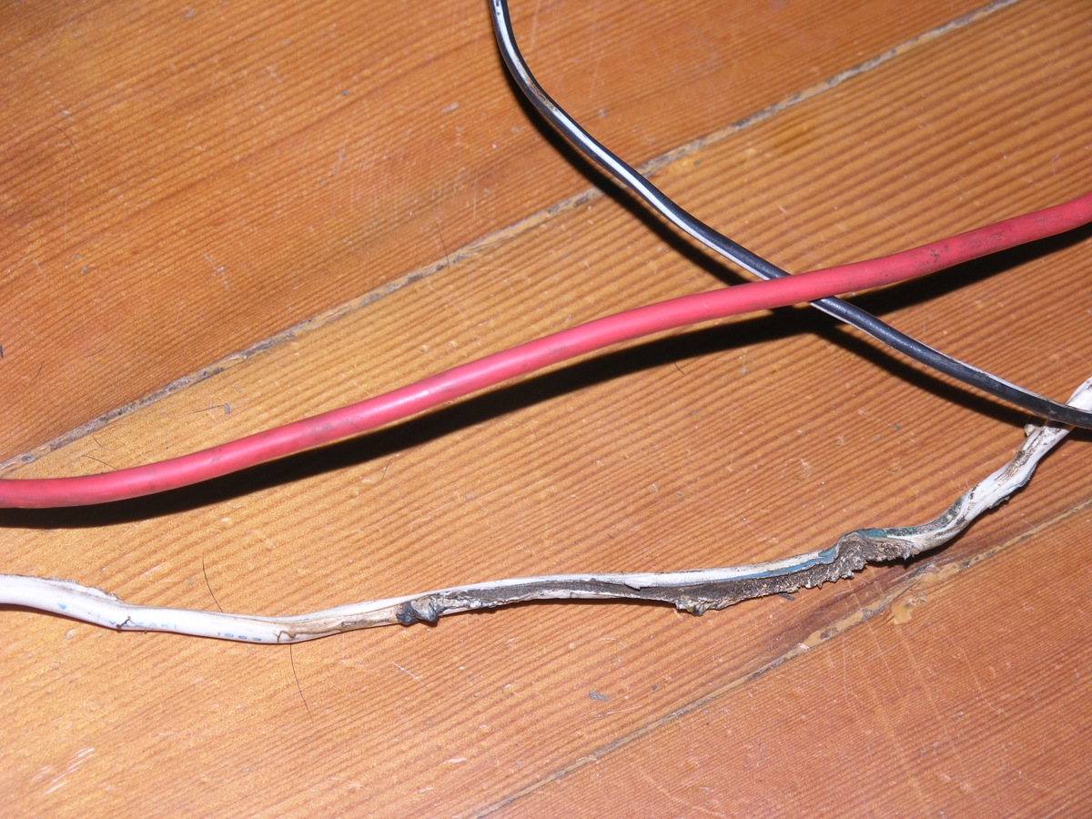

this is how nasty my min power wires and ignition wires were before i replaced them haha
there where funky splices and wire core exposed, pretty skanky :D
was the PO Joseph Lucas ? :)
haha i know right?
Can you believe the splice and twist connector on the main power wire to the fuse box?
jebus!
I might buy some colored wire from cooler man and rewire from the generator to the voltage reg too, just to have fresh wires delivering current to the system :)
but man, changing the main power wires an ignition even made my display lights brighter!!! headlights etc :)

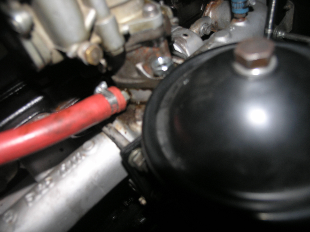

well replaced the manifold studs and tightened the carb on well ( the shop put aircraft seal between the manifold carb insulator, dunno if that is weird or not )
But the hesitation is still happening, it is like it is not getting fuel or something.
Site glass seems full when i look.
When the engine was all heat soaked I went out and started it and it was idling weird, vacuum fluctuating like like 4 inches of mercury, you have to rev it out and it eventually becomes stable agin, but it is weird as hell.
It is like it is not getting fuel or some vacuum leak?

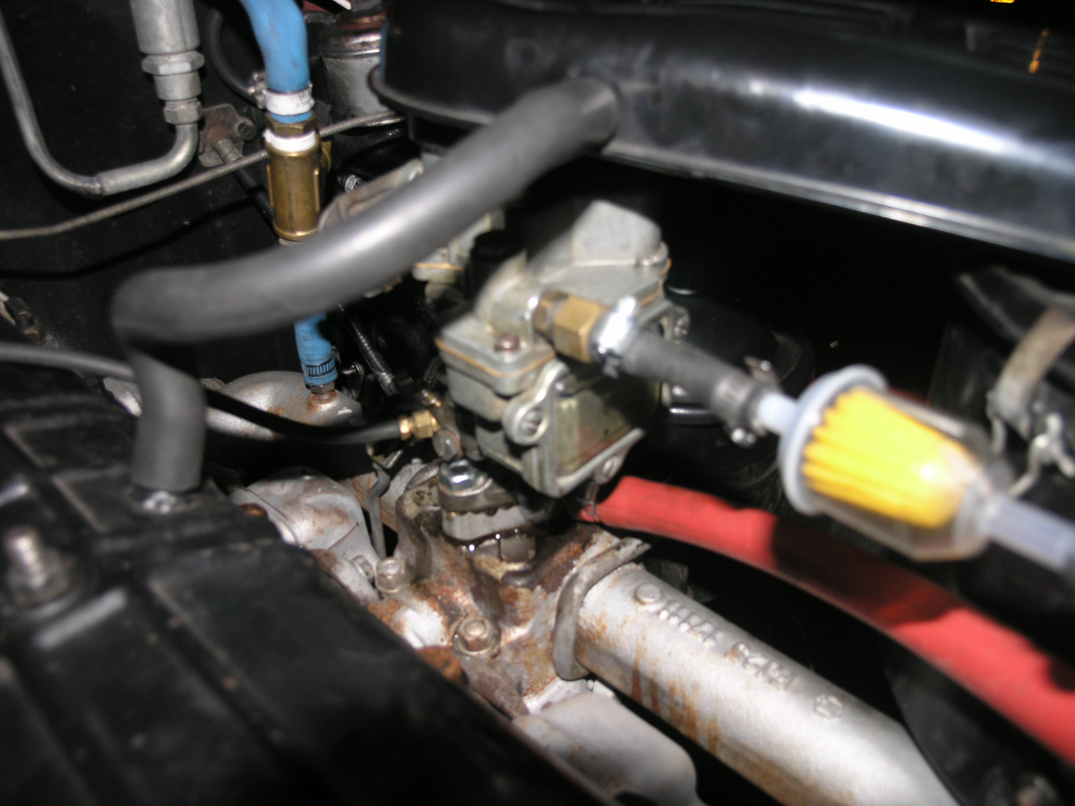

ok took it out for another ride just now, was running great then at a stop light it died on my ( like it was getting no fuel jsut kinda stuttered out ) Look at the fuel bowl, and it is at the line in the site
Cranked with the pedal all the way down a few times and it stumble stutter and started and a i revved it to get it through the light as is stuttered and stubled and i pulled it over left it idling ( idles ok now )
I reved it out and the stumbles started to go away, then drove it home and it ran ok.
WTF
Do i jsut have crap in my tank still from the body shop ( I flushed that tank like 8 times, but body filler dust and sand etc could be still in there, the filter picks up some now and then still )
Is it as simple as me just getting my tank reboiled and relined and running new lines?
Tired of spending money and not getting to enjoy this truck, or even being able to count ion it for big fun trips.

Yes, I think so, you have some dirt in your fuel system,
would chance the fuel filter more often.
Buy such cheap plastic fuel filters and chance them often.
When all the dirt is gone, you can switch back to the old school
Landcruiser filter.
Cheers
Peter
x3. Sounds like you better drain your carb and see if there are any floaties (or sinkers :)) in your float bowl getting sucked into your jet.
