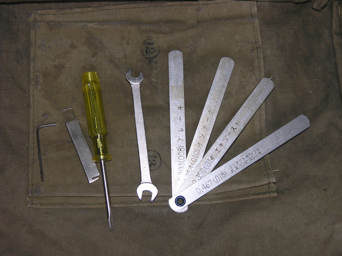

Before i was not lubing the cam on the distributer where the point cam follower "follows" the cam, and i think it basically wore down the cam follower on the points, because my point gap was TIGHT, like .012 haha. I changed the gap, checked the timing, readjusted the idle mixture and made sure the rpms were spot on...

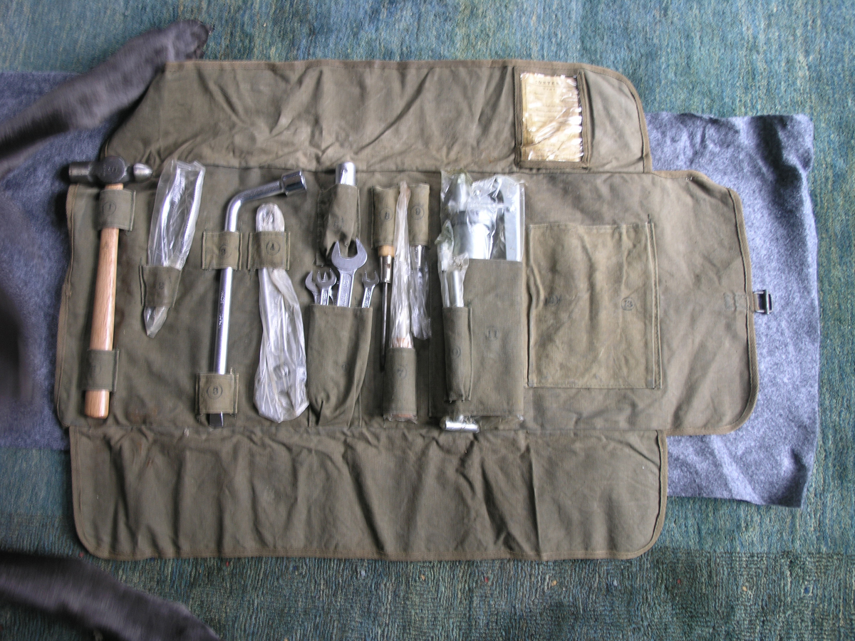

If the tool wrap gets here soon i might take a drive up the back roads around mt hood :)
