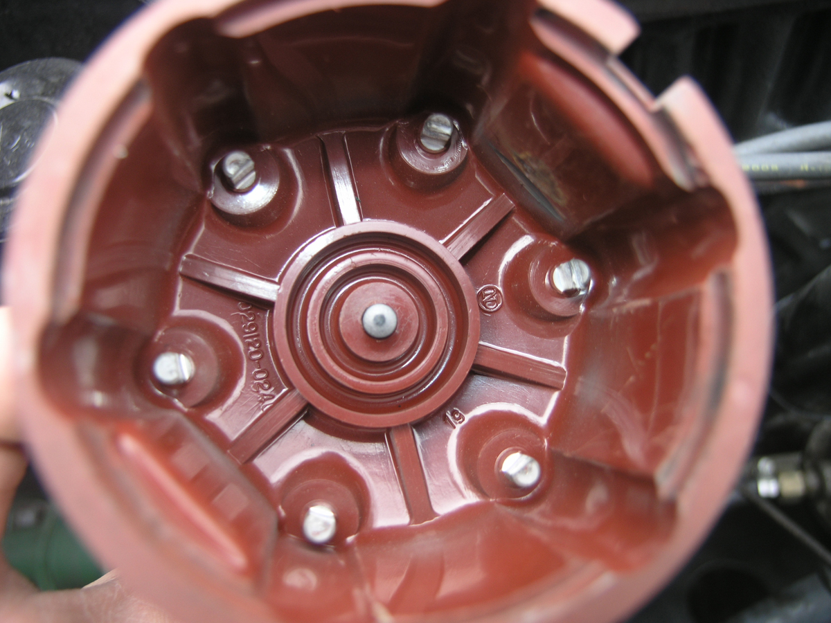

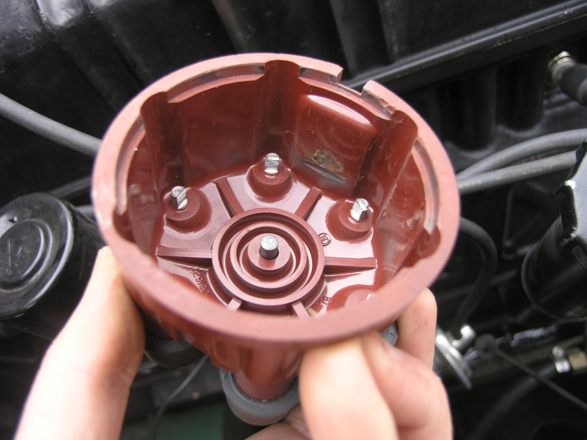

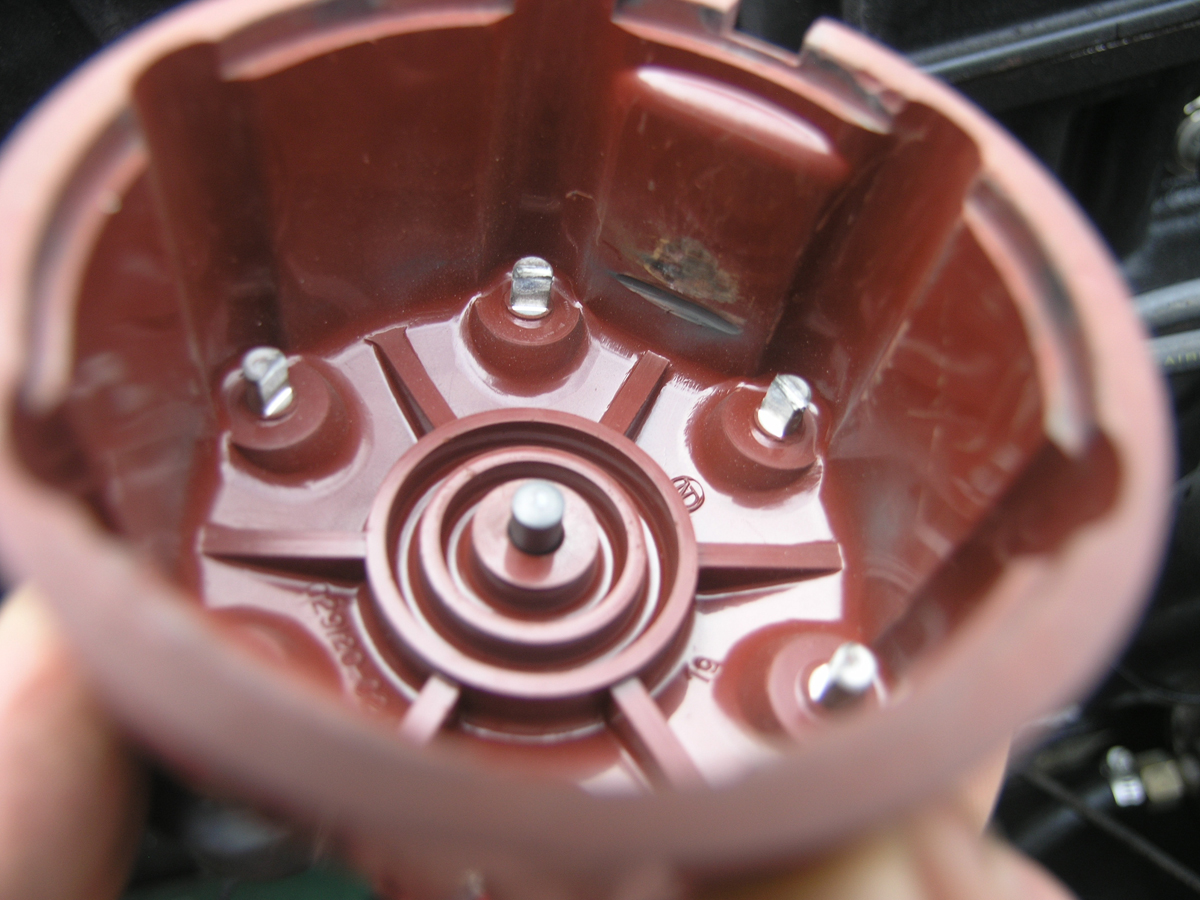

Hi guys
Been messing with my rig and i have this damn illusive miss that fires preiodically i Can not figure it out, pulled the dist cap to check my points, looks good.
THEN
I look inside the cap, and holy fxxxing gouge, the plastic is gouged and it look like a few of the metal points in the cap are being chewed up on the same side ( 3 of em peep the photos ) The dist cap is new OEM vacuum advance

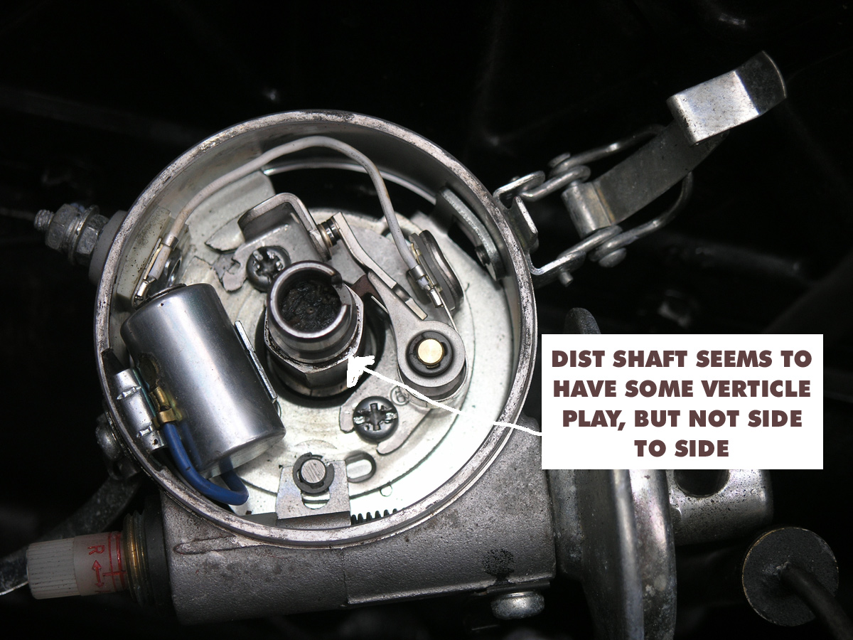

The dist shaft does not appear to be wobbling side to side, but it does have some play up and down vertically when ya pull up on it ( slight )
The dist cap did have some movement to it, but nothing I would think that would gouge the hell out of the cap.
SOOOooo bad cap, or do i have a larger problem?
I have an extra OEM cap, but i do not want to put it on until i know for sure what the problem is...
Thanks guys
Hi guys
Been messing with my rig and i have this **** illusive miss that fires preiodically i Can not figure it out, pulled the dist cap to check my points, looks good.
THEN
I look inside the cap, and holy ****ing gouge, the plastic is gouged and it look like a few of the metal points in the cap are being chewed up on the same side ( 3 of em peep the photos ) The dist cap is new OEM vacuum advance
The dist cap did have some movement to it, but nothing I would think that would gouge the **** out of the cap.
Thanks guys
Looks like the cap was poorly fitted, could have been at an other time and put right when they heard a noise. Vertical play is normal for an older dizzy, you can check for a bend shaft.
how do you check for a bent shaft?
It is a new OEM dist, but it might be bent, ****
Take it out and spin it (not to fast) with a drill from the bottom or put everything on and listen if the rotor hits the cap (with dizzy taken out).
You might be able to see the dwell angle woble when running idlle but I think it runs to fast to notice.
Ok, gonna have to wait for a nice dry day and pull it out and give that a whirl.
I do not have my garage space iwas renting anymore hehe :(
Would those worn metal points in the cap cause the secondary missing i was getting ( or possibly a bent dist shaft ) ?
Hard to say, does it occure at high or low revs?
