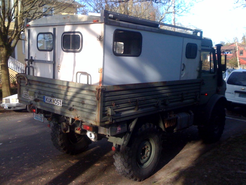

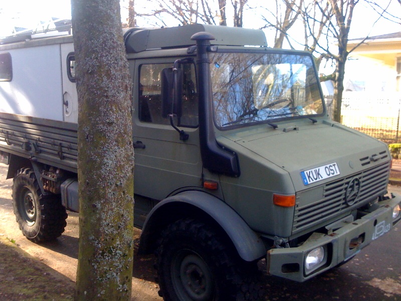

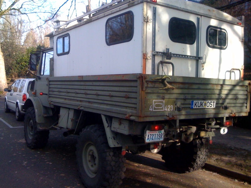

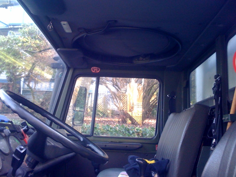

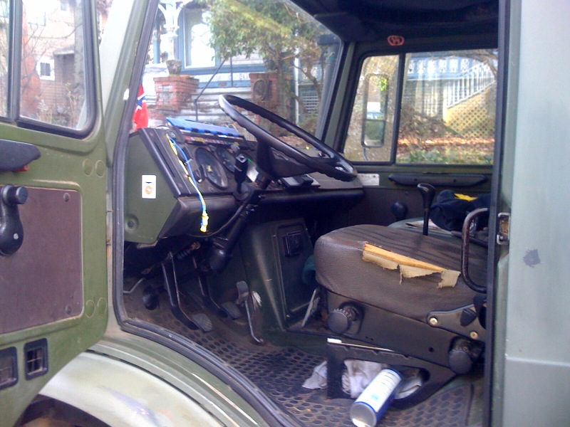

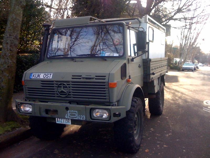

Oh and the neighbor was moving and had an awesome rig posting photos soon!
