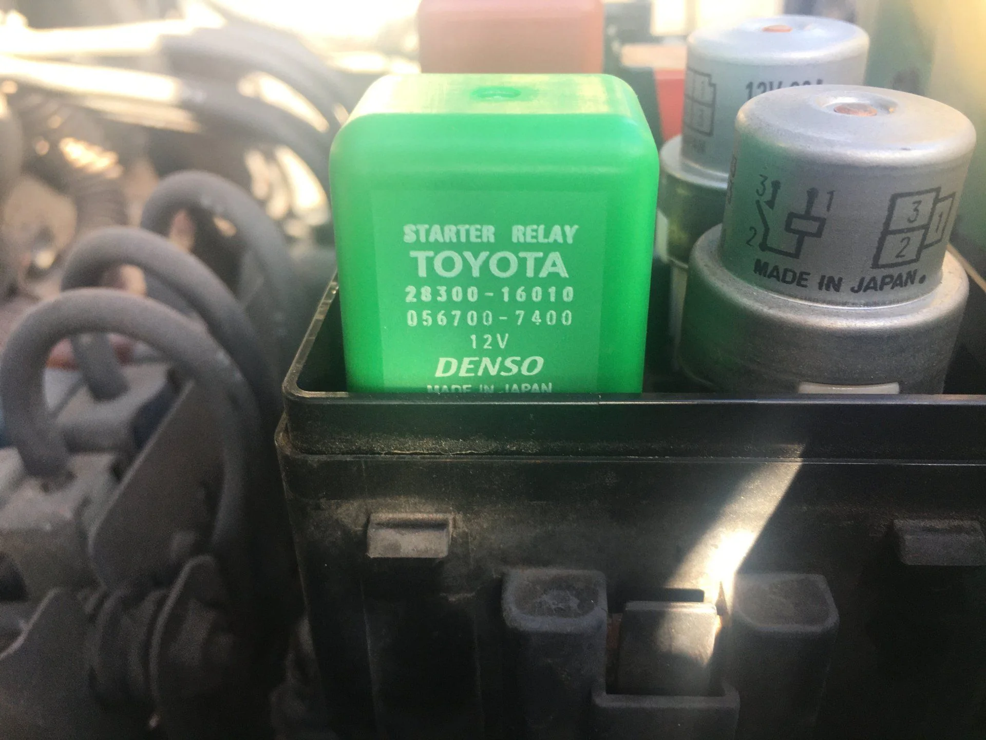

I replaced my fusible links first when this happened to me, but that did not correct the problem. I eventually (through the expertise of jonheld) narrowed it down to my EFI Relay. The only thing that is not similar is that my LC never died while driving. I would pull into a 711 in Japan, get some grub, and then it wouldn't start back up. Used to take my EFI Relay (OEM Metal relay) out using gloves because it was so hot and go put it in the 711 freezer to cool it down. Always started up right after that. In the end, swapping to the camry (corolla?) plastic EFI relay that jonheld recommends completely eliminated the problem for me. I'd recommend at least trying that.

Also don't want to go off track, but here is a picture of the relay I got that solved my problems
