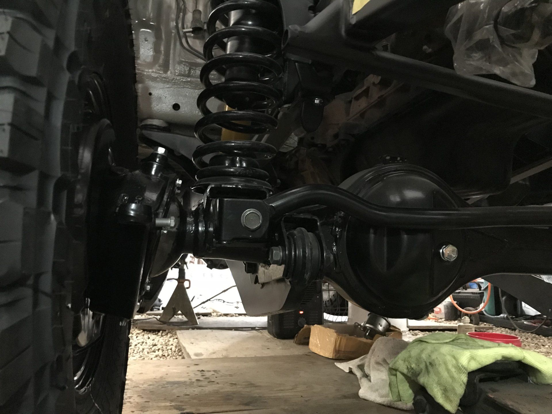

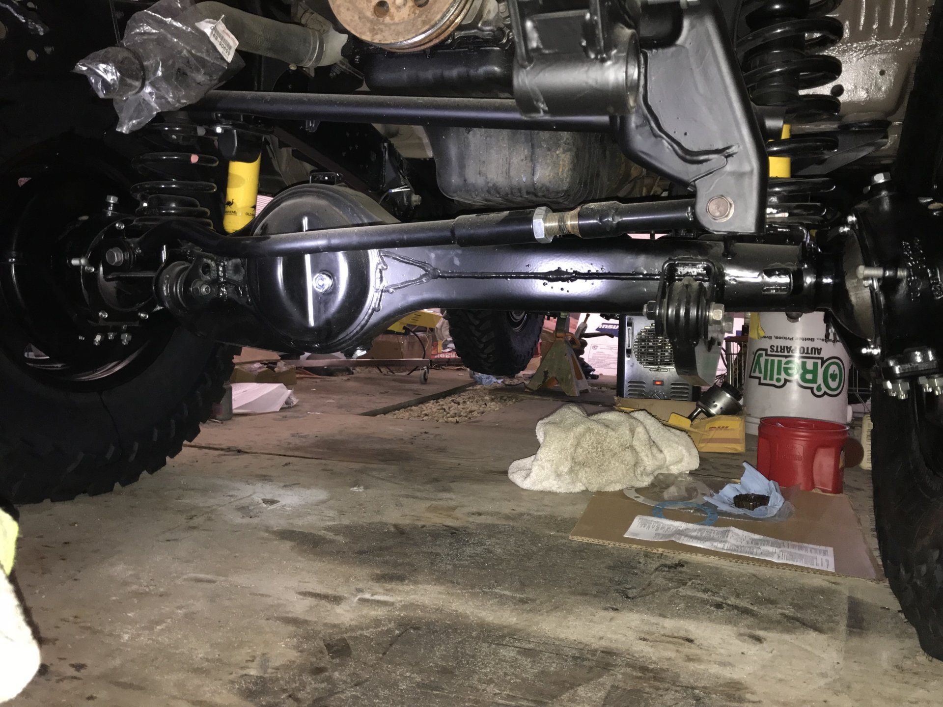

Here are mine for my build. 4 Degree custom powder - 4" TourFlex lift.

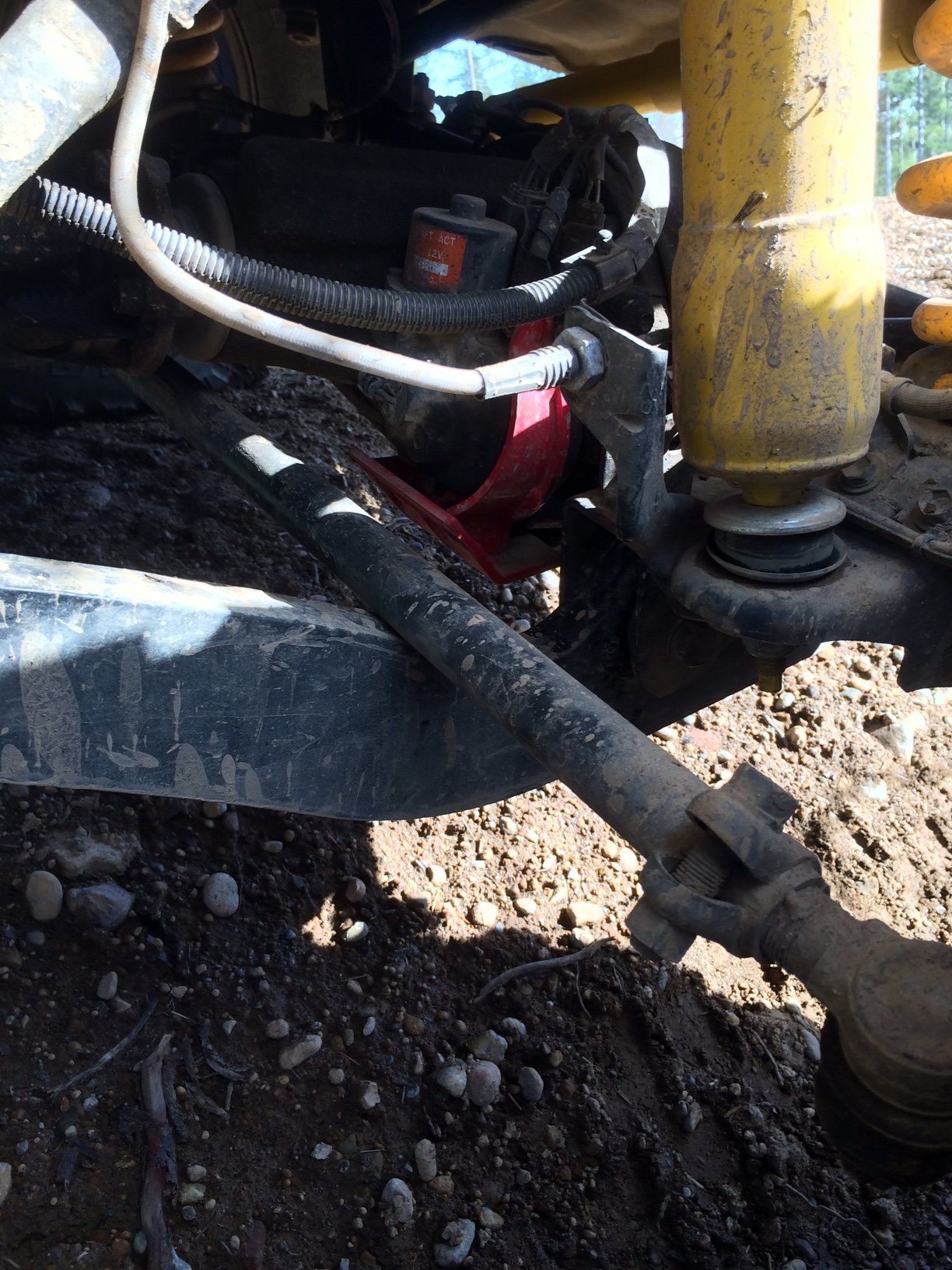

Stock tie rod arm just barely making contact on my 4" delta arms at full droop (wheels straight), I could grab the bar and still turn it hearing it rubbing a little but imagine at full lock wouldn't be possible. Was thinking of upgrading to the marlin hd arms but probably wont now.

Hmmmm. Is left wheel stuffed? Any way you can reproduce this situation and take some pics of the other side too? Maybe email them to dave@deltavs.com?
Edit: what springs do you have and how much height difference between panhard bolts at ride height?

I should clarify I meant one side only was drooped fully the other side was stuffed. will have to check panhard bolt height difference tomorrow. My setup has tjm 2'' springs and 30mm spacers which have netted me around 3.75" actual lift.
Ok, please do. As @baldilocks noted, wheels forward is the worst it can get (steering components move up as they get closer to steering limits), so as long as it's not interfering (if you can turn by hand it's not interfering), you should be fine.

Sorry long day at work and decided to wash the mud off the cruiser when i got home. Measuring from level ground to center bolt hole on each panhard bolt and subtracting the difference i am right at 4.5" difference. It's good to hear that my circumstance would have produced the least amount of clearance though the thicker bars like marlin crawler or slee's would make things that much worse still. Would a longer shock make the issue that much worse? Was originally thinking about upgrading to the dobinsons tapered springs front and rear once i get a little weight on the vehicle and their 6" shocks in front, currently run their 4" all the way around. I know baldilocks run them on the front.
When first I flexed out the Delta arms I made sure to droop the long Dobinson shock all the way while the opposite tire was, for all practical purposes, fully stuffed. The tie rod is a thicker one made of 1.25” dia DOM and the contact between the rod and the arm on the drooped side was very light, in fact, I could have slide a piece of paper between them.
Be aware that the the narrower arms coupled with the tapered coils and long shocks will cause bushings at the axle to deteriorate much more quickly if you use the new found axle articulation often enough. My last set were two years old when I removed the stock arms to install Delta arms and they were in worse shape than I figured they would be.
I’m thinking that the tie rod to radius arm interference will become more of a problem as the bushings wear and become more and more sloppy. Next up; high steer. It never ends.......
