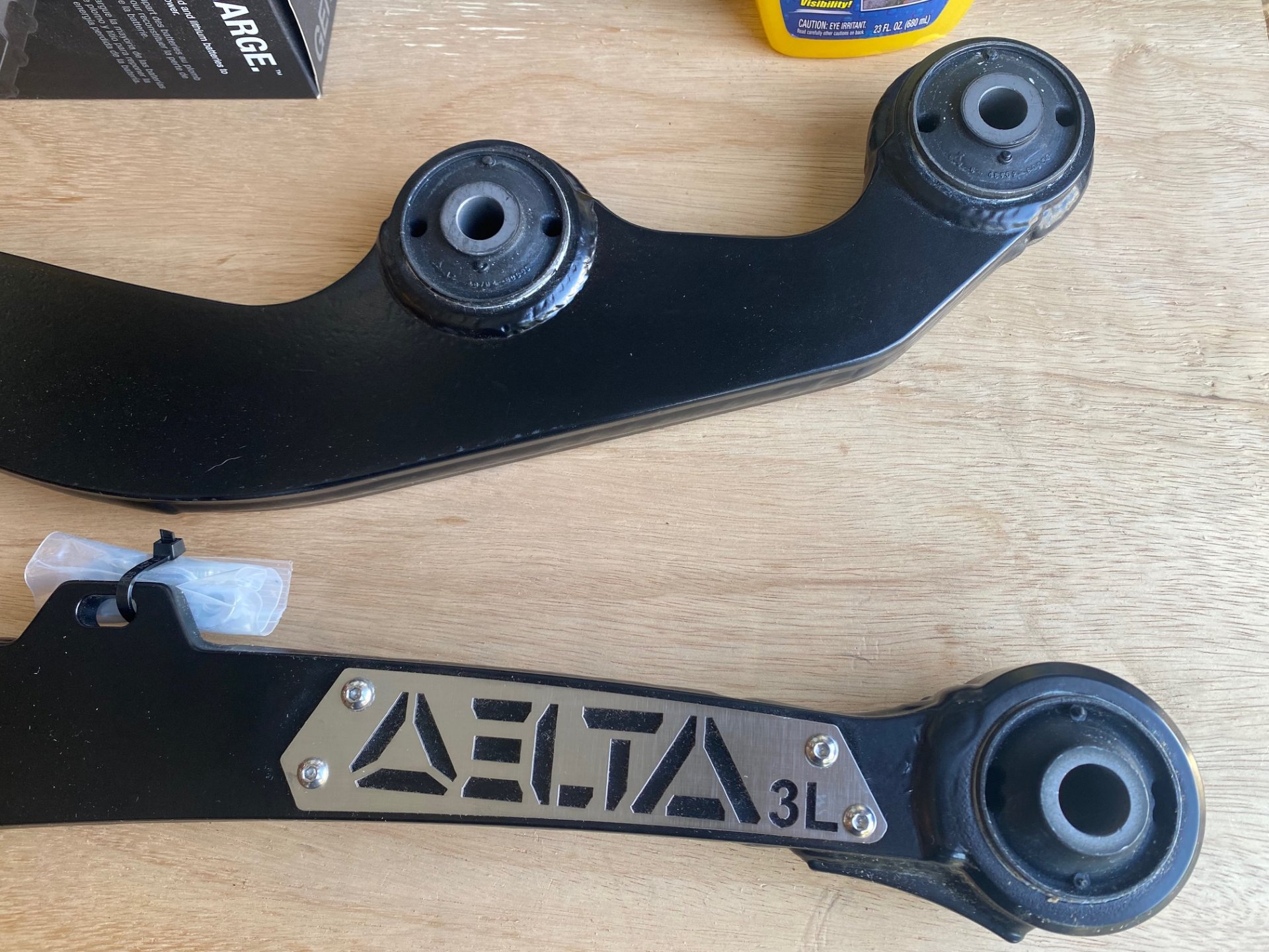

And the obligatory delivery photo. These radius arms are stout, I ordered the 3L flavor.

So how do you determine if you need the long or not? I've just installed dobinsons 2.5 lift (ended up closer to 4" from old worn out springs). I need to correct the caster. Was going to use the bushings with various caster settings but leaning towards just replacing the arms.
From what I read, the "L" version will move the axle approximately 1" forward. This option is typically for those who run larger tires (37"+) and want to move the axle forward to provide more room between the front fender pinch weld area and your tires. I believe caster correction is the same between the regular and "L" versions, someone can chime in if I have that incorrect.
In your situation, sounds like you gained 3" lift (+1" over the sagging old springs). If you don't plan to run larger than 35" tires, the "regular" version of the arms would do the trick.
