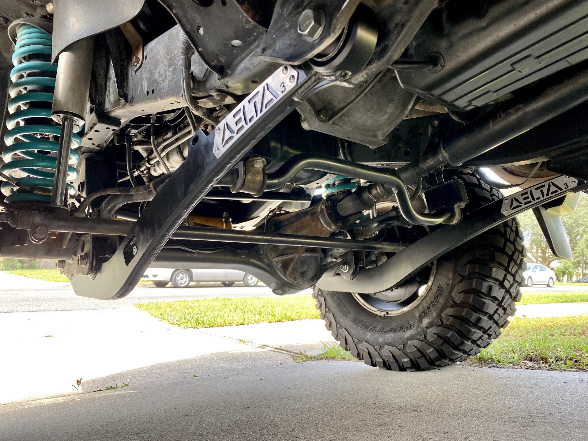

How tight is the clearance between the arms and the trailing arm on the steering linkage? I ask as I recently updated to Marlin Crawlers HD setup. I’ll likely be in the 2-3 inch range.
Should be plenty of room. Not familiar with that particular setup but plenty of others have installed HD links without issue.
Many of us run a 1.25” tie rod with plenty of clearance at the arm. These arms had clearance issues in version 1.0. I’m one who switched from V1.0 to V2.0 after we provided the necessary info to Delta. Zero tie rod/leading arm interference now.
thanks DVS

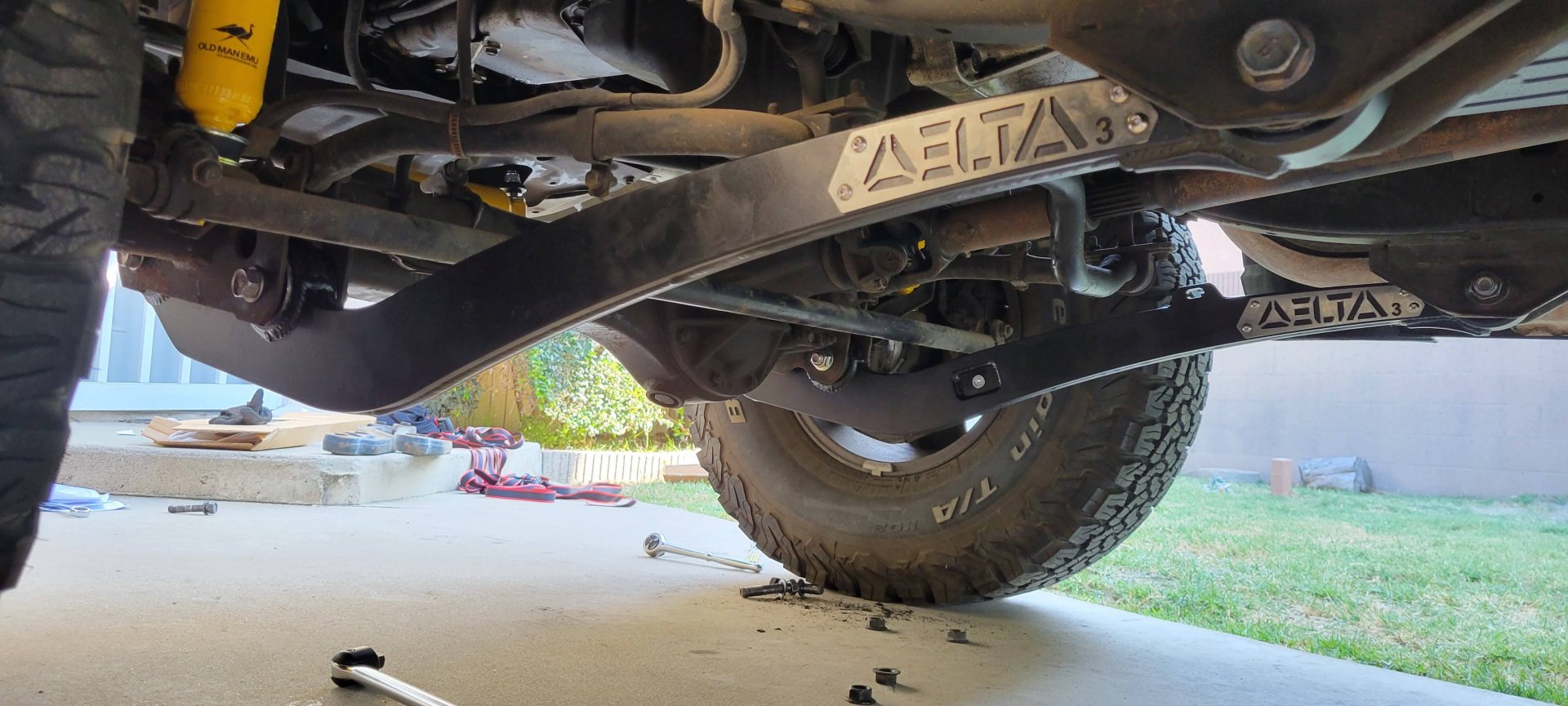

I got my "3L" arms on today, to dark to take pics though.
Pulling out of the drive I could tell they did increased caster from the previous 2" emkieth brackets.
Steering is a bit more heavy & retuned to center faster. :steer: :bounce::bounce:

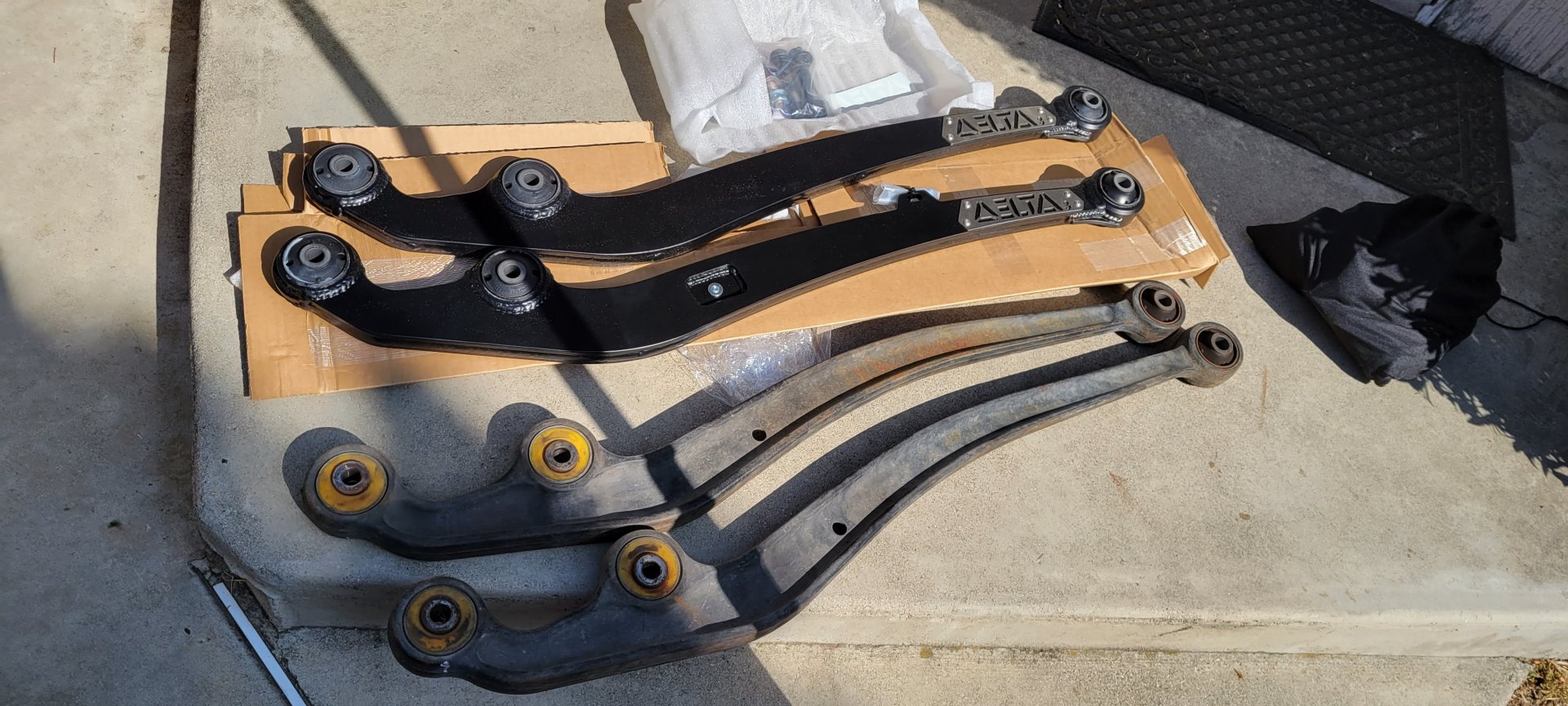

I did overlay stock arm on top of the Delta arm with hitch pins to line them up.
Quick tape shows about approx. 35/8" of correction.
They defiantly have more room for the tie rod then my altered ground down stock set.
You can also tell they are longer. A quick tape was 37.2/37.25" which is 1" longer then stock.

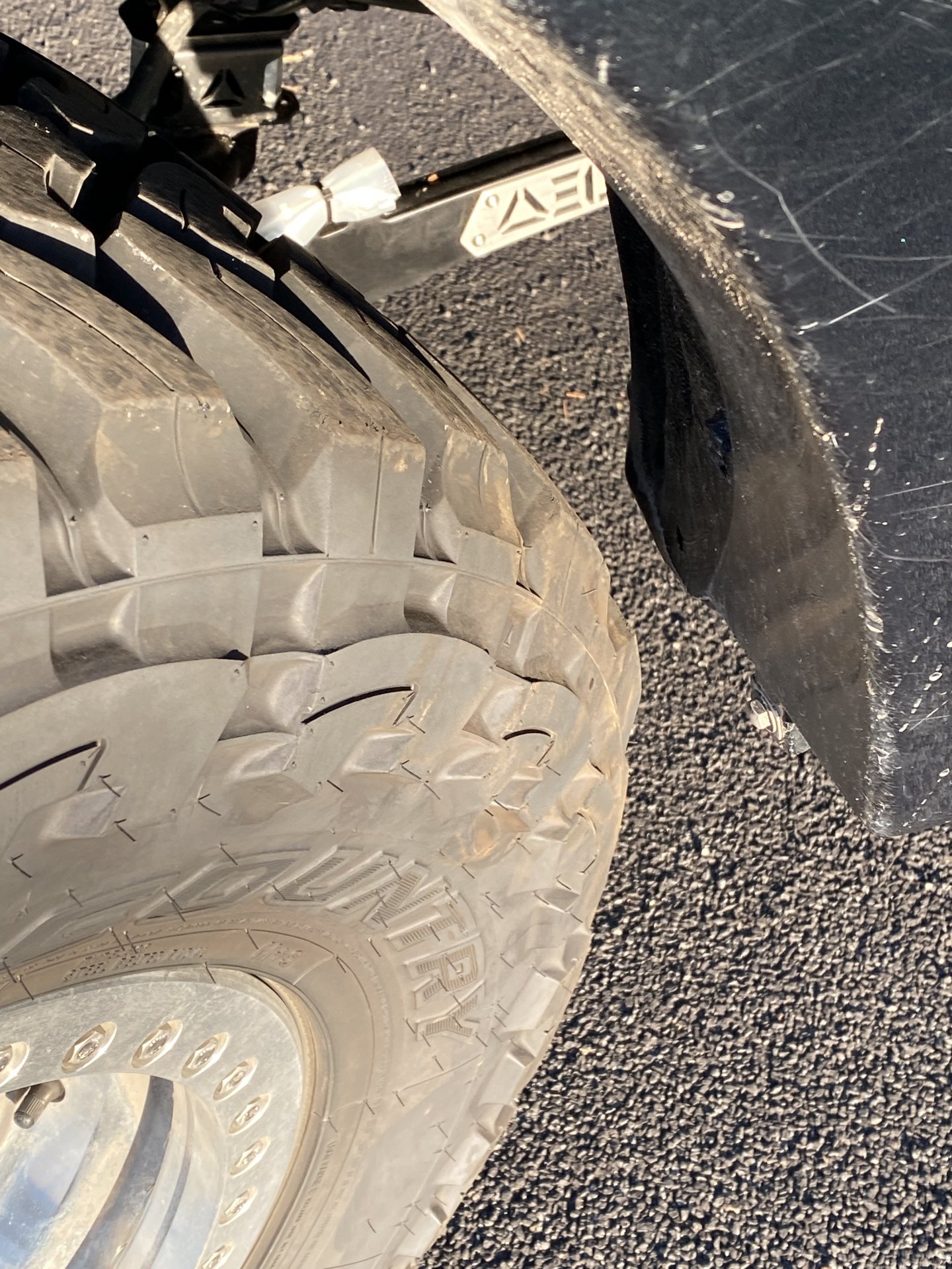

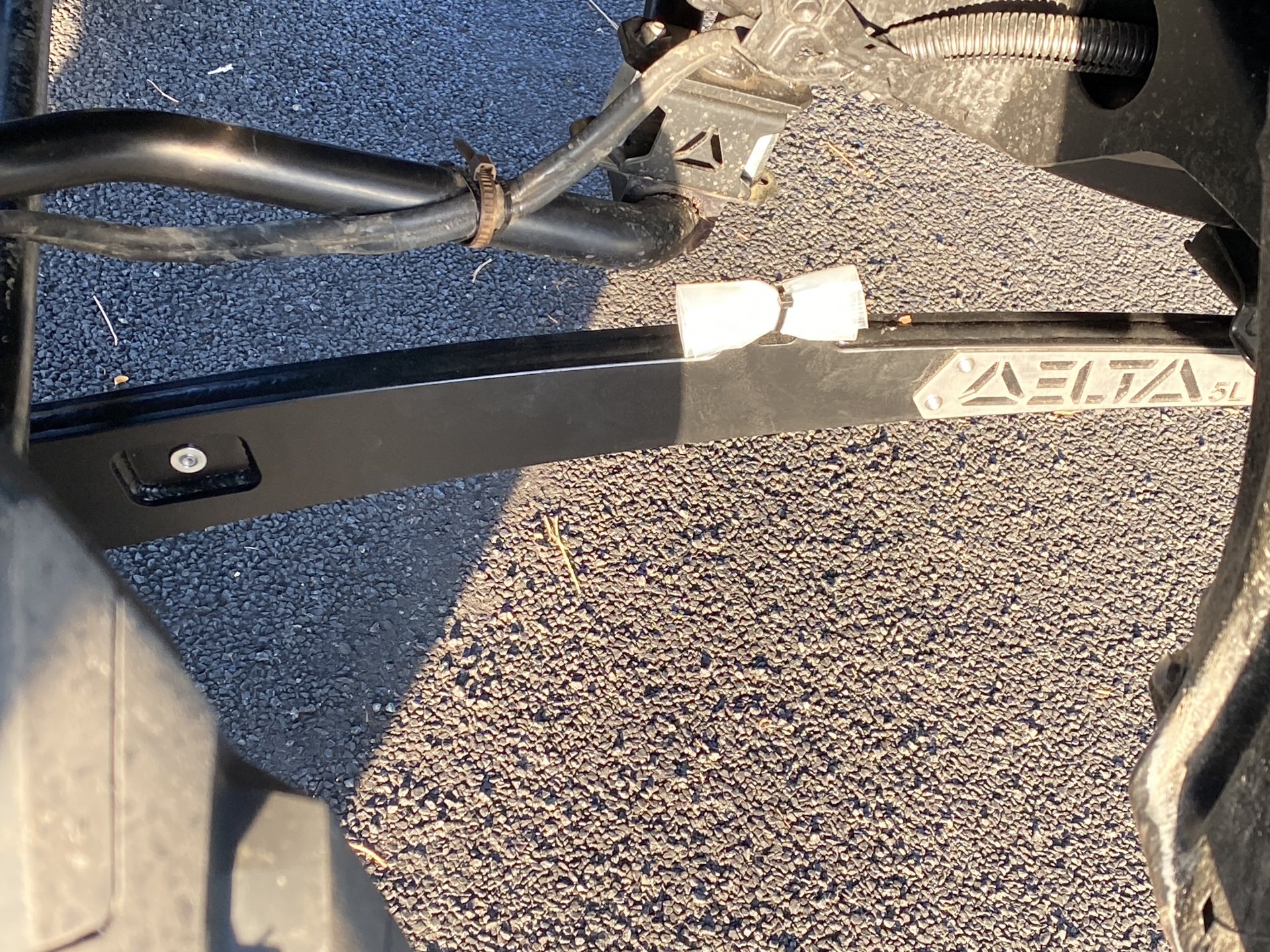

Isn't it normal for paint to flake off when you hit rocks with it? Am I missing something?
You are correct but I only take my rig to the local mall to shop for shoes and eat ice cream.
The curbs are tall at your ice cream shop...
I agree and I’ve spoken with the mall manager about accommodating my need for lower parking lot fixtures.
You would expect a higher quality finish for the price we paid for these. :rolleyes:
