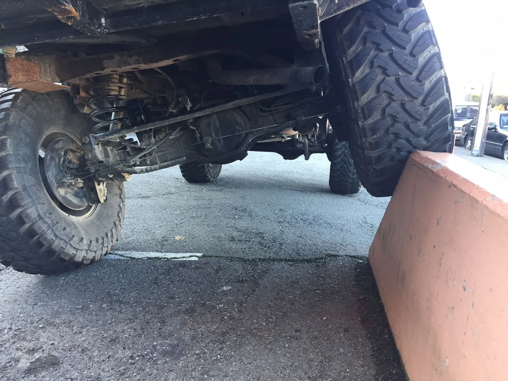

I have the better part of double that lift but if the differences are half of what I've noticed in a short period of time, yes worth the coin.
Edit - I don't know the geometry side well enough to know if it's linear or exponential in regards to benefit gained. If it's linear my comment stands, if it's exponential I'm not qualified to comment. I'm sure others are.

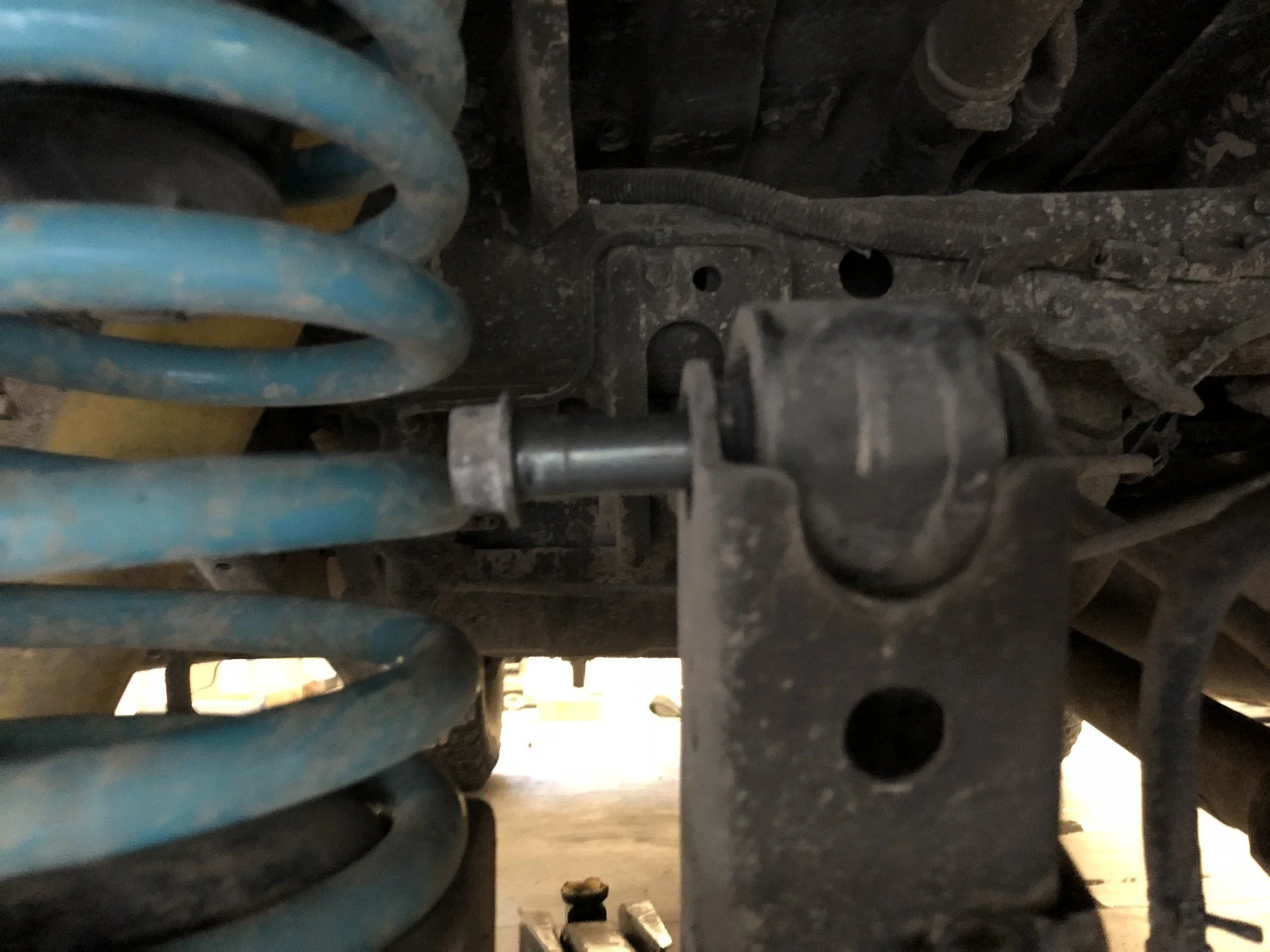

Good enough for me. Thanks. Now if the upper link bolt wasn’t conspiring with the coil to get me:

How'd you end up getting your bracket on? I had a little time yesterday and tried to install my bracket. I ended up having the same issue with getting the bolt around the spring with my Slinkys. I tried using the hi lift jack but the top of the Slinkys would expand so much that those bottom coils didn't want to move. I tried using a floor jack to compress the spring but couldn't move the coil enough either. I'm considering trying to find someone with a lift or just pulling the coil. Not sure which one is easier.

Pulling the coil was the easiest solution for me.
