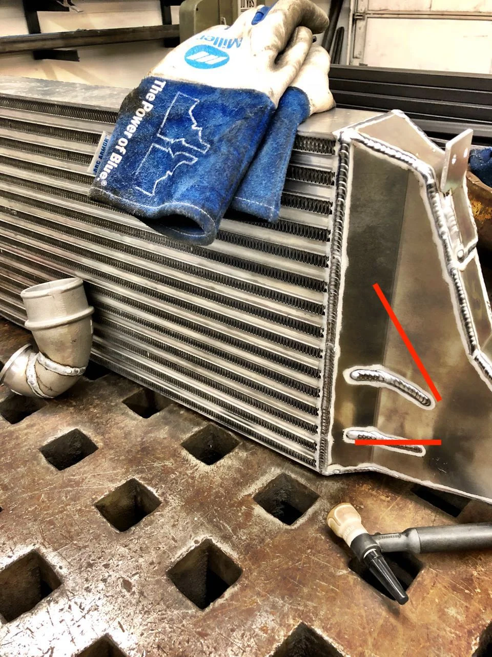

And I hope Delta doesn't mind, I know every kitchen has too many cooks, and this isn't criticism just a suggestion. But Since they are running internal stiffeners in the end tanks it would be really cool to see them change shape just a bit to act as air flow guides as well as stiffeners. It directs the air up into the top of the IC using the entire core instead of just shooting it from inlet to outlet.
Something kind of like this?
You can see it a little more clearly here:

That is indeed a Garrett core. 24x12x3.5. We wanted a 3.0 but none were in stock. Will get some more pics today st the show for you. It’s in the stock radiator location, with the radiator pushed back a few inches. Chose this route since there is still a mile of room in the engine bay because the 2.8 is so short.
