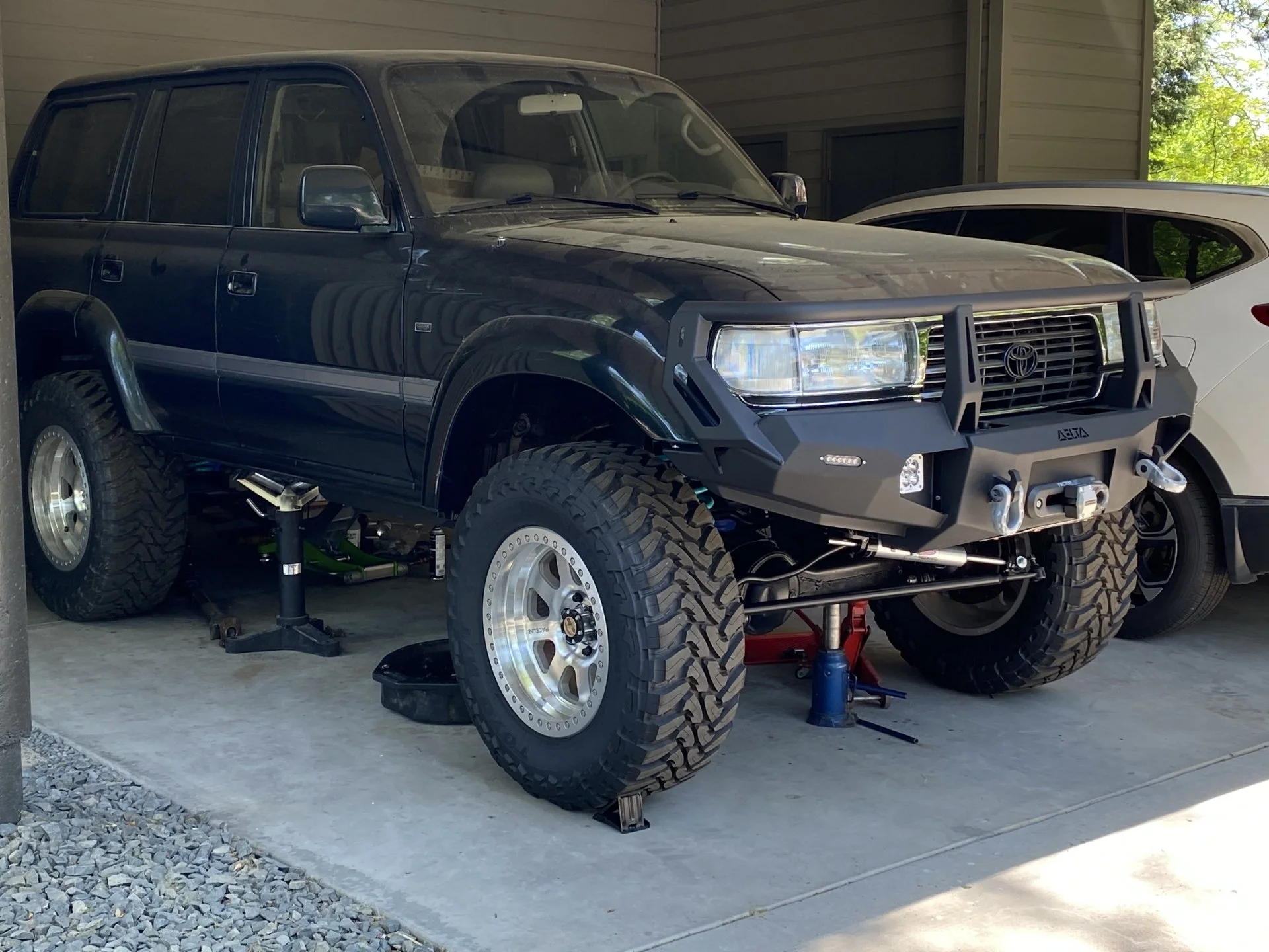

Thanks for posting the comparison pictures. I have the ARB and can't wait to replace it with a Delta. Still undecided on whether to go for the full grill guard or not. What compelled you to change?
It is a hate it or love it bumper. I think its a bit big unless running 35's or 37's and probably wouldn't look right for 33's or under but what do I know. These guys put a ton of thought into them, so much more that ARB had. They are a classic around for a long time tho.
I agree, Delta makes amazing parts. Like you already said, it is a bit bulky for what i do with the rig, i need all the clearance i need. Also too futuristic....but to each of its own.
They launched the full guard weeks after I got mine. Liked it more and had a buddy get into an 80 so talked him into kitchen work for the bumper. Win/ Win, it in my mind is much better than the original hands down but everyone is a little different.
That, and I had to pull it to add shims correctly, you can see its a little crooked with the help from a boulder on Schoffield pass. It also had to come back off to add a winch so I thought WTF :meh:

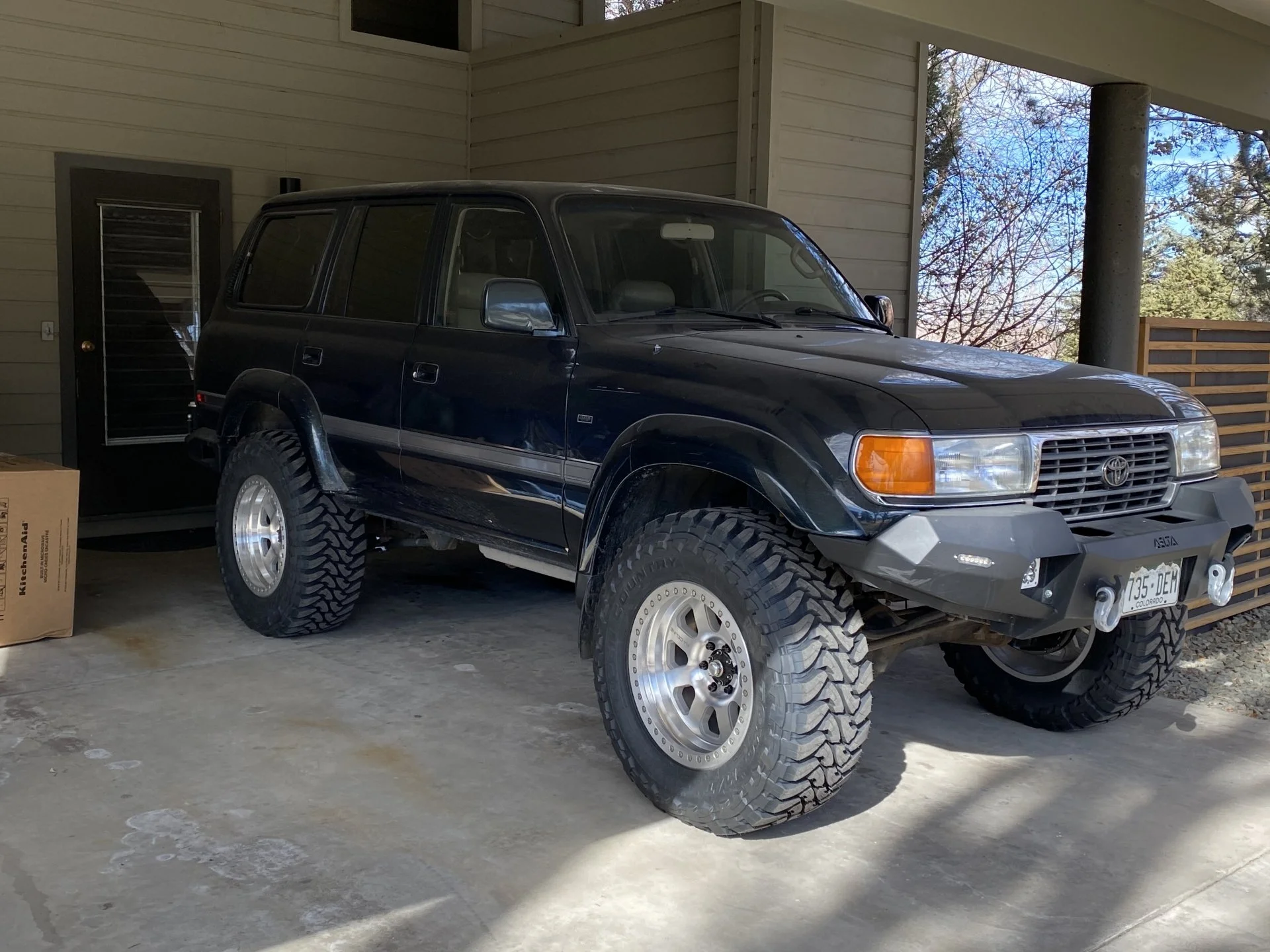

Nobody can argue taste, but please do keep in mind our bumper has waaaaaay more clearance than an ARB bumper, in all directions.
some guys like fat girls and some like skinny girls!
Tons of clearance
I get up to an obstacle and I'm always surprised, she clears it easy.
This photo is on slick rock trail off highway 4

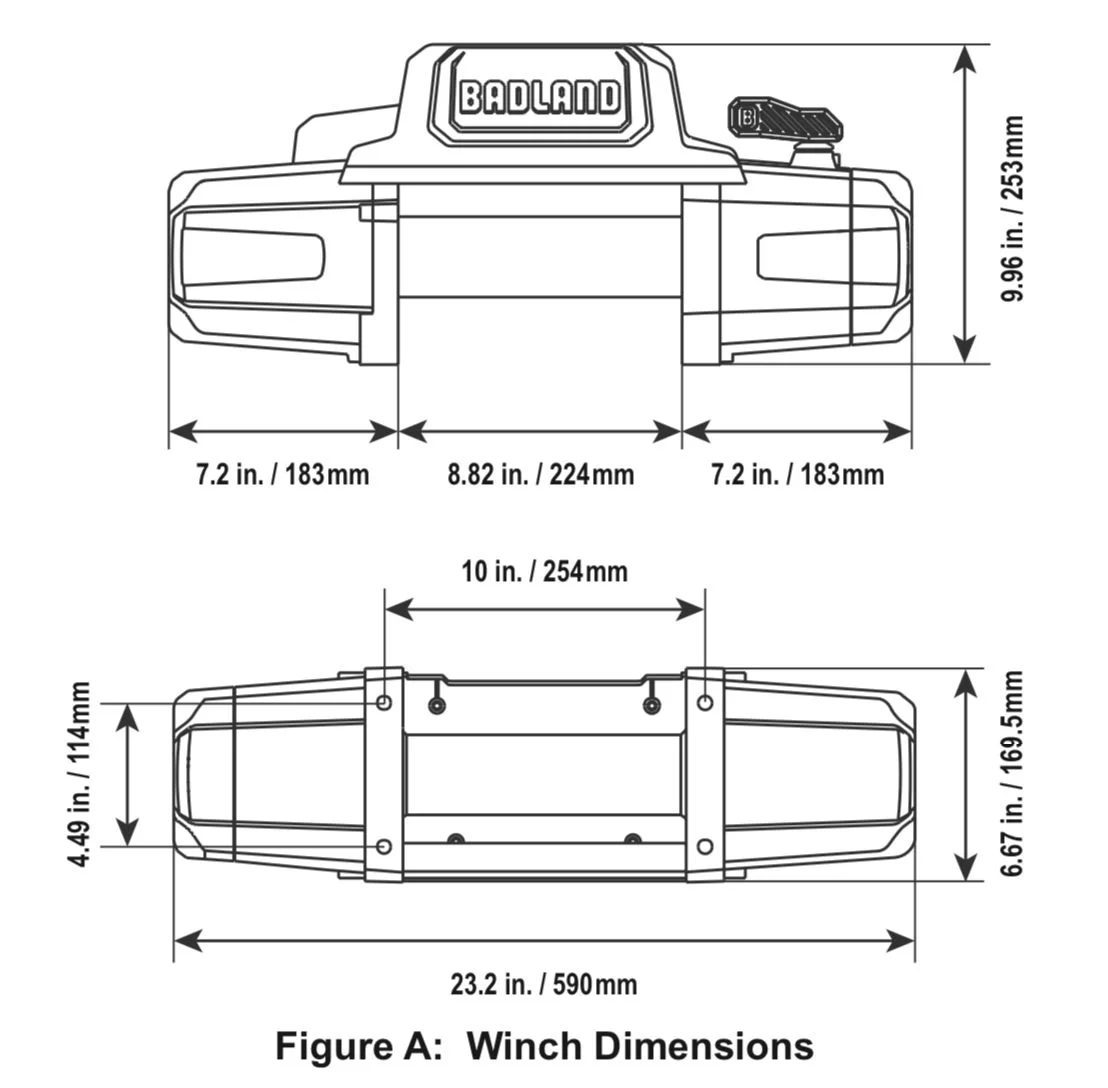

As far as mounting of Badlands, can you get a measurement of total height? From mount surface to top of control pack. I will be able to tell you if it will hit core support or not.
As mentioned, the bumper was redesigned to accommodate mounting to both surfaces.
I have a 12.5 Comeup on mine, mounted feet forward, and have pulled the ever loving isht out of it. I have not had any issues to date, and anybody who's been on the road/trail with me knows I'm there to test our products to failure.
Thanks Dave! I hope that I don't pull the ever loving s*** out of my LX450.. but it is good to know I could. 😁
This graphic is from this post Apex 12K dimensions. I did a quick confirmation on my Apex 12K winch and it is <10 inches tall.
41117d64-abdf-4cfe-9490-1b1b3007180e-jpeg.2472384
Just went and measured the shop 95, looks like there is right around 9" from the inside face to trans cooler.
