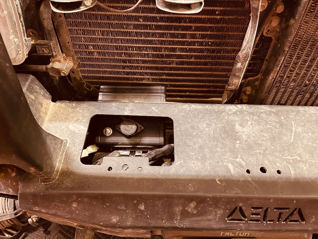

About an inch of clearance between control pack and AC condenser:

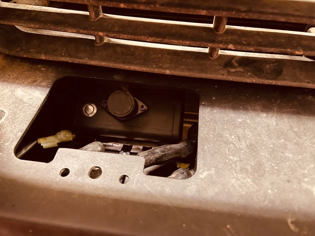

Grille on, showing access. Everything you see here is well below the top of the bumper.

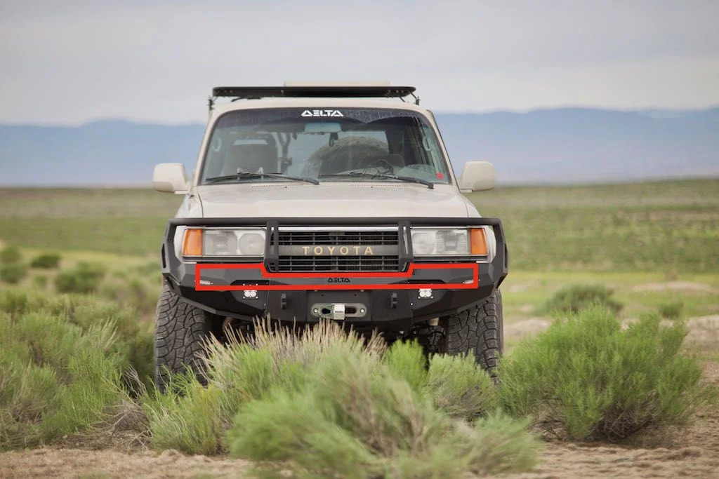

What I think a lot of folks miss when looking at our bumper is that to install it, you remove the valence piece (red crayons in first pic). This is what allows the bumper to have a substantially tall/deep cross-section under the headlights (giving a lot of strength), but also sit very high, retaining plenty of approach angle. Pretty much all other bumpers start BELOW the bottom of the valence, or close to that point (lower red line in first pic here):

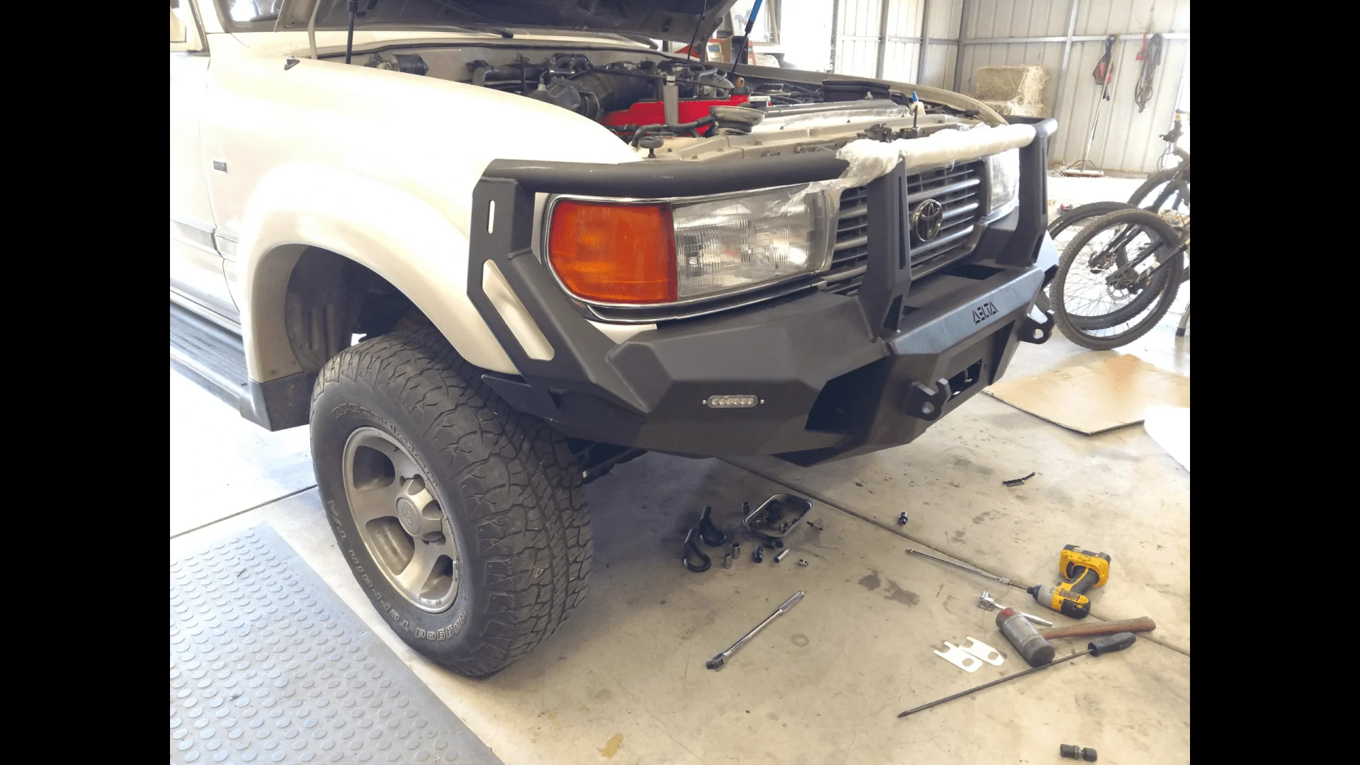

This photo is looking right across the top of bumper, with some more red crayon showing about where the end of the frame rail is:

This photo is across the top of the bumper, as well as a little in front of it.
