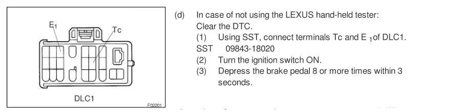

3. Delete all existing DTC’s and fault conditions manually using the procedure below at DLC1 in the engine bay (connect E1 and Tc) or the equivalent FSM procedure using DLC3 (Tc to CG) under the dash. Special Service Tool SST 09843-18020 and 09843-18040 are a simple wire connectors – instead suggest use an unbent paperclip or similar. The purpose is to reduce confusion by clearing DTC’s which may have arisen from previous work and which now may be irrelevant – such as when connecting and reconnecting components. The ongoing DTC’s and fault conditions will be re-established as soon as the engine is started. (Remove paperclip or other connector when finished and hold down for a few seconds the AHC “OFF” switch on centre console to re-start AHC system).

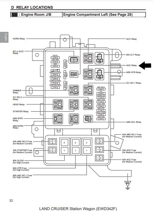

6. Find the AHC Motor Relay in the engine bay fuse box and test using the procedure at Page DI-243 (DTC1741) in the FSM extract attached to Post #952 in this thread,

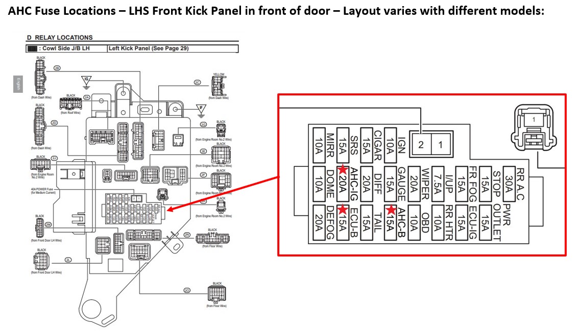

7. Pull and replace (renew if necessary) the 15 amp AHC B fuse and the 20 amp AHC IG fuse. These fuses are not in the engine bay but are located in one or other of the junction panels behind the kickpanels in the footwell forward of the front doors – not sure on which side in your model, expect LHS. The purpose here is to be sure of the condition of these fuses, and also to power OFF the AHC Main Relay (this is different to the AHC Motor Relay in the engine bay fuse box) and also power OFF the ECU – in effect “rebooting” these devices which may be enough to clear a fault. Disconnecting the battery for a few minutes should have the same “rebooting” effect – but it is better to physically check and test relays and fuses,

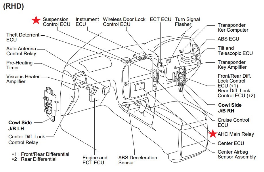

8. Test the operation of the AHC Main Relay – this is mounted on the Electronic Control Unit (ECU) -- see location at Page DI-217 in the FSM extract attached to Post #952 and test details at Page DI-248 (C1743). The purpose is to ascertain whether this Relay is working -- see also pictures at Post #914 in this thread – if not, then no power is delivered to the ECU nor other sensors and controls in the AHC system and the AHC system cannot work,

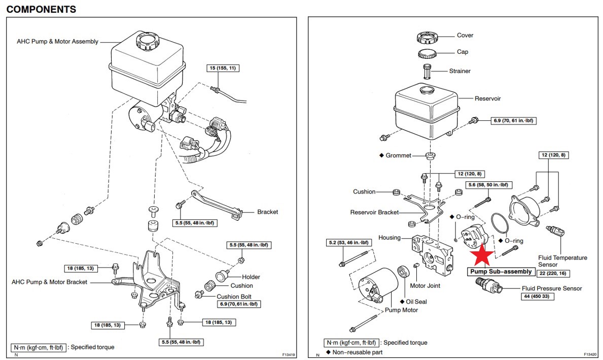

9. Test the AHC Pump by direct connection to a 12 volt source, either directly at the pump connection or by pulling the AHC Motor Relay and using the terminals in its socket. Disconnect the hydraulic line from the pump or lower down at the Attenuator to see whether the Pump appears to be developing strong pressure and flow. This can be messy -- have a container in place to catch fluid discharged by the Pump. The purpose is ascertain whether
-- the AHC Pump is capable of operation if not inhibited by faults in the AHC system which prevent AHC operation, AND,
-- the pump develops strong pressure and flow, OR,
-- weak pressure and flow might suggest a full or partial blockage at the filters/strainers inside the Pump.

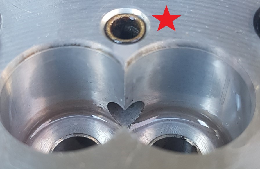

My further notes: If a clean-up is being done, it is worth disassembly of the pump to investigate the screens/strainers which are are located inside the actual pump itself, on the input and output sides of the tiny gears (smaller than a thumbnail) which provide the actual pumping action. Gear pumps usually are specified for high pressure / low volume applications where the fluid is free of particulates. The screens/strainers are intended to keep particulates out of the actual pump. Particulates might otherwise degrade or destroy the gear action.
When an AHC Pump is thought to have failed or a relevant DTC such as C1762 is recorded – meaning that the delivered pressure is too high or too low and AHC response is slow – this may have been caused by clogged screens/strainers rather than problems in the actual pump, unless the screens are missing or have holes which allow particles to pass into the gears. The pump is small but fit for purpose -- it would take something like a stream of sand to destroy the pump.

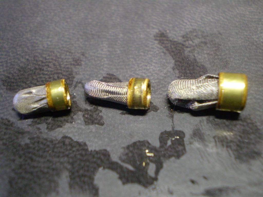

Many pictures of the Pump internals including the screens/strainers are found in Post #67 through to Post #70 in this next link and include my pictures of disassembly of my AHC Pump:
The problematic internal strainers/screens (not to be confused with the strainer at the AHC Tank) are shown at Post #70 in the above thread.
The main purpose of the pump cover with the big "+" on the outside is to contain the pressure which is used to force the pump gears tightly onto the pump body so as to minimise side clearances and minimise fluid bypassing the gears at their sides. There won't be much flow in the space inside this cover but outside the actual pump. It is a natural trap for fluid.
As for many types of oils warmed and cooled over a long period of time in the presence of oxygen and moisture, a gel or sludge eventually will form in traps where fluid is stationary or moves slowly. Some of this gel or sludge may find its way into the pump. If so, it will be caught at the internal screens/strainers inside the pump along with any accumulation of particulates not fine enough to pass through the screens/strainers. The pressure drop across the wholly or partially blocked screens/strainers will cause a loss of pump output pressure and flow.
So a clean-out is a good idea when there are suspicions about pump delivered pressure and flow being low and/or DTC C1762.
A source of replacement internal screens/strainers is not known -- they are not detailed in the FSM and do not appear on commonly available parts diagrams and lists and are not shown on Toyota/Lexus lists. It is not known which of the many suppliers to Toyota/Lexus factories is the actual manufacturer of the AHC Pump. It is suspected that it might be KYB who make the Height Control Accumulator used on LC100/LX470. The FSM deals with the issue only by recommending replacement of the AHC Pump rather than repair.
The screens/strainers could be eased out with a pick as mentioned by @PADDO -- but carefully, do not want any holes in the mesh. A simple backwash may be a safer approach.
Alternatively, and for peace of mind, replacing the pump sub-unit every 15 to 20 years (or 24 years!) may not be such a bad idea – especially where long term neglect (infrequent AHC fluid changes and infrequent AHC pressure checks) by previous owners is suspected. The pump sub-unit is Part Number 48901-60010 – current price example: Partsouq: USD168.19 plus delivery.
Suggest if disassembling the pump to clean the internal screens/strainers, then either leave the tiny gears and their carriers in place, or, carefully mark and photograph their orientation to one another so that all parts can go back together with parts and gears oriented and meshing in exactly the same way. Otherwise, the Pump may not work at all. Ideally, replace all o-rings encountered and also the oil seal between the pump and the motor and the grommet between the AHC Tank and the AHC Pump.
Suggest if using a secondhand pump, disassemble and clean the screens/strainers and inspect the gears before installing in the vehicle.
Also suggest bench testing the overall Pump/Motor assembly with a direct 12 volt supply before reinstalling it in the vehicle.

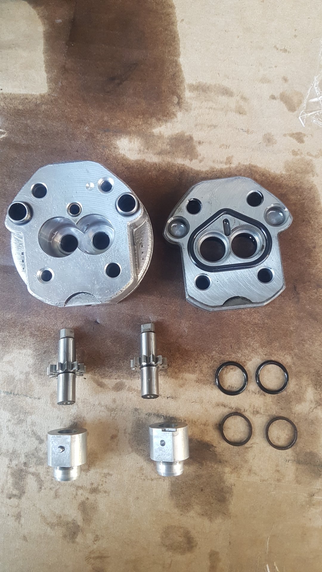

Some visuals of actual disassembly of an AHC Pump internals, gears, etc, can be seen on Youtube. These often are not LC100/LX470 AHC Pump assemblies but instead are LC200 Pump assemblies -- these are distinguishable by the Attenuator (small brown cylindrical object) mounted next to the actual AHC Pump. The Attenuator is located separately below the AHC Pump on LC100/LX470. The LC200 AHC system is quite different -- and the tank, pump, motor etc are mounted in the RHS rear quarter panel behind the RHS rear wheel. The actual Pump internals on LC200 appear much the same (and may be exactly the same) as the LC100/LX470 Pump and the visuals give the idea. However, it is safest to rely on the pictures on the various IH8MUD "100 series" threads.

LC100/LX470 Pump disassembled (picture by @IndroCruise )

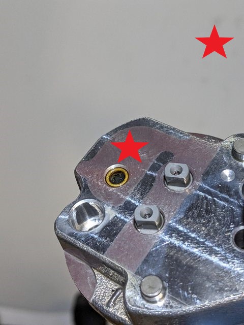

Strainer position -- enlarge to see insider strainer below brass ring (picture by @IndroCruise
Strainer position -- enlarge to see insider strainer below brass ring (picture by @IndroCruise )
Strainers removed and cleaned (picture by @Zel)
Overall layout of LC100/LX470 Assembly of Pump, Motor, Pressure Sensor, Temperature Sensor, Tank:

Now back to the Pump filters;
I tried quite a few methods to withdraw them from the housing, initially without success, in the end however I found that using as perfect a fit of wood screw was a perfect solution.
I ground off the point of the screw to prevent it from damaging the very small and very fine mesh of the filter.
I screwed the screw in very tentatively making sure not to go too far and when the screw had sufficient grip I extracted the screw and filter by mocking up a direct lift cantilever type affair that lifted the screw in a directly straight upwards trojectory. Once I got the “tensions” all as near as I could gauge this actually worked very well.
Now I have read in a few posts that some folk have suggested that due to the difficulty of extraction of these very petite and fragile filters, that they opted to not take them out but alternatively they jetted hydrocarbon cleaning fluid both directions from the inlet and outlet orifices.
I fully understand this decision, but upon my findings I don’t agree with trying to clean this way.
This was because I found it was very difficult to clean the small meshes in these petite filters when I had them totally removed from there enclosures never mind attempting to do so by simply blowing from either end of the enclosure.
I found that the debris which was a very fine sand like material was almost embedded like concrete inside the small mesh and to make it even more difficult these small meshes have small overlaps of mesh that must be gently manipulated by squeezing between your fingers to open up these small overlaps or flaps to ensure that all that dust like grain is removed.
It took me about 10 minutes to clean each of these filters thoroughly.
The degree of cleaning needed could not be achieved if the filters are not removed out of there receptacles or enclosures.
One of the filters was much more congested than the other.
I then took a very fine grade nail file and tidied up the top of the brass collar of the small mesh filter to ensure any scrapes or abrasions caused by my extraction were filed down smooth in readiness for reinsertion back into the respective orifices in the respective pump body parts.
When the pump body components are all thoroughly thoroughly cleaned ensuring that all the internal channels and journals are cleansed with certainty that the unseen portals or journals or oil-ways are absolutely spotlessly cleansed, then and only then the small filters must be reinserted.
I found it was necessary to press these small filters back into place.
I used vice grips with small pieces of rubber to protect the components from any damage.

The gear wheels and gear “axle” are a single unit with the gear wheel and the axle being milled as a single piece.
These axles fit into two small hubs that in turn press freely into the pump housing.
Here I made what could be a very significant observation,
There is a very petite cut-away or “Nick” machined out of the bottom edge of one of these hubs.
It is vital that these hubs are replaced hub by hub, back into the housing precisely back into the position they came out of.
Thankfully there are only two options or ways to instal these hubs into the housing.
For ease of explaining from here, let’s just say there is the right way and there is the wrong way.
However, installing the right way the fluid can flow unimpeded on its proper pathway,
However installing the wrong way, the pump cannot function as the aforementioned “nick” is in the wrong place thus the fluid cannot flow unimpeded.
I know I may be wrong here but so far I have never heard anyone mention this small “Nick” and boy is it not a vital part of the pumps mechanism. I have read and studies hundreds of posts as well as watched many videos but to date I have never heard of or been told to look out for this petite “Nick”.
Now as I admitted earlier I didn’t take notes or photograph indeed I took no actual records of the disassemble as I should have done.
Boy did I have a problem here,
“How do I know which way to re-instal these hubs”
In the end I did a miniature mock up of the assembly and using a fine nozzle and compressed air, I blew the air into the inlet hole on the housing, and indeed yes my first attempt was wrong as the air was not getting through. So now I knew to insert the hubs the alternative way.
So by the skin of my teeth I got past this hurdle.
I however could not get out of the next slip up so easily.
I hadn’t marked and recorded exactly where the teeth of the gear wheels met, tooth by tooth.
In this my friends I was defeated.
I had to proceed and hope that the pump would function for me with just a random guess with positioning the two gear wheels.
I wish to share another idea here if I may.
When I was assembling the components of the primary pump assembly I set up a very clean plastic jar in which I filled with AHC fluid.
I then set the components of the primary assembly into the AHC fluid and I assembled each component under the fluid ensuring each orifice was filled with AHC fluid from the onset of assembly.
This method also meant that all the components of the primary pump were assembled while submerged in the AHC fluid thereby ensuring that all the components were adequately lubricated as the assembly progressed.
Next step is to attach the Main Block of the pump to the primary pump module.
Being conscious of the need to avoid any and all air pockets I unscrewed the AHC Fluid pressure sensor out of the main block, filled the pressure switch orifice with AHC Fluid and then reinstated the AHC fluid pressure sensor back into the main block. I then set the “main block” on its side with the large End Cap O Ring looking straight upwards and the electric motor directly beneath sitting on the bench.
There is a second much smaller O Ring sitting inside the large O Ring, on this block face. It is vital this small o ring is kept in its place.
It is crucial to make sure it is kept in place. I believe this O Ring seals the faces of the two assemblies at the orifice that allows fluid access to the pressure sensor.
I filled AHC fluid into the upper face of this main block before dropping the primary pump assembly down into the block. Once again attempting to ensure that all orifices were filled with fluid and all joints lubricated.
There are a two other O RIngs who’s locations are obvious. However these two small O Rings have two small steel backing washers.
It is vital to replace these washers and O Rings precisely in the order they come of. However thankfully this is also intuitive in nature and can be worked out.
The washer and O Ring sit into a recess.
The washer goes into the orifice first, then the O Ring.
One other observation I made was that if you happen to slightly over tighten the primary pump assembly to the “main block” the pump will be too tight and the motor won’t be able to turn the gears in the gear Housing.
There are proper torque settings for tightening these four studs, but I couldn’t find them at the time.
So I just trusted in my experience and I lightly tightened each stud while at the same time I tested the motor by connecting to a 12volt battery, thereby being able to identify when I was coming closer to the “Sweet Spot”

I then embarked upon getting the two small filters removed. This was quite a job but boy was I glad I persevered.

If you look closely at the very first photograph, you can see the small Nick cut out of the bottom edge of only one of the two hubs or barrel like components.
If this “Nick” is not repositioned back in its original place this restricts the flow of fluid through the pump.

So after this 3-4 week journey leading to focus on the AHC PUMP, when I reinstalled the pump my AHC problem was solved.
So I took the AHC pump out of the LC200 yesterday. Did a thorough cleanse.
I rebuilt it, checked it was running and more importantly made sure it was pumping fluid.
Howeve sadly this has not solved this cruisers problem.

However when I have crossed poles Tc and E1 and pressed the brake pedal 9 times within 3 seconds, the AHC OFF Light did change its blinking sequence.
It went from a regular 1 second On Off On Off continuous to an ON OFF ON OFF pause ON OFF ON OFF ON OFF pause continuous repetitive pattern. Ie 2 x ON THEN 3 x ON repetitive pattern.
But when you finalise the reset process removed the link and press the OFF button for up to 10 seconds and go back to a normal start up, it instantly goes back to a continuous flashing On Off pattern even when you start the cruiser.

I have checked all AHC fuses and the AHC Relay under the hood.
That said I am not sure yet about the fuses inside the passenger side inside kick panel.
Are they the same layout as the LC100 fuses in there?

Hi Everyone.
Can anyone help please,
#Indrocruise @IndroCruise.
A 2007-8 LC 100 4.2 diesel. UK/Ireland.
Does anyone know if the AHC ECU and adjoined AHC relay are in below the steering wheel above foot rest, just as it is in the earlier 1998-2003 LC100?
My problem is that this car the 2007-2008 has been modified for a disabled driver and getting in to where I suspect the ECU is located is going to be quite a job.
However I have had a peak with a probe or magic eye and I actually can’t see it where I thought it should be.
Anyone have any knowledge of the Later LC100 layout as regards the position of the AHC ECU and adjoined Relay.
Thank you everyone.
Any help much appreciated.

There is a picture at this link to Post #102 of the position of the Suspension Control ECU and AHC Main Relay in the Driver's footwell in a USA Left Hand Drive vehicle (the AHC Main Relay is missing in this example but the holder can be seen). This may help to visualise the Left Hand Drive situation.
In your Right Hand Drive vehicle, the Suspension Control ECU and attached AHC Main Relay is in an analagous position on the left leg side of your Driver's footwell -- unless it has been moved during modifications.
Suggest probe above and slightly to the left of the DLC3 socket.
Also suggest go to the diagrams at:
LC100 Workshop Manual - https://lc100e.github.io/
Scroll down to
Electrical Wiring Diagram
> RELAY LOCATIONS
> Instrument Panel
> [Pick vehicle year of interest]
– then open this page, scroll down to RHD and look for Suspension Control ECU

Your a star @IndroCruise.
This vehicle was with another mechanic before it came to me.
I know he tried an ECU from an older LC100. He said it didn’t work or change / fix anything.
Crazy as it seems I’m getting suspicious the Cruiser may have arrived at my shop with No AHC ECU connected just now.
It’s a real pain to get at.
The owners husband had a disability kit installed, it’s actually brilliant.
Hand lever to side of steering wheel.
Push down = braking
Pull up = accelerating.
Great adaptation. But it blocks all access to beneath the Console and steering column.
No ECU attached!!
That would explain a lot!!!!!

I have since found what all those codes are and they are all related to the AHC ECU.
Either it’s not there at all or it is not plugged in correctly.
Of course there is one more possibility, the ECU could be toast. Maybe one of the other technicians fried it before I got it. !!!
Anyway, thank you for your nudge with the technical manual, I found what those codes relate to and it does make sense to my investigation.
One other thing I found today, the 50amp AHC fuse in under the hood in main fuse box was blown. !!!
I will keep all informed.
Thank you @IndroCruise for your “as usual” masters touch.

We have a major component failure in the system. It could be the ECU itself.
If you remember I discovered that the main 50amp AHC fuse in the fuse box beneath the hood was blown at a time.
It has not blown ever since, although the AHC has never worked ever since as well.
Perhaps you could help me with a small problem my friend.
I am at the point of going to try test all the wires going into and from the AHC ECU.
I believe I saw detsils of how to test the wires going into and out of, the AHC ECU.
If my memory is correct the data I was reading mentioned having to put the test probe of my meter down inside the sleeve of some of the input wires and then in other cases I could pull the plug out and put the test probe into certain ports on a certain plug.
I think in order to test if the ECU was getting power I have to keep the plugs plugged into the ECU and slide the probe needle down into the input wire sheath.
I’m waffling deliberately here Indrocruise, as I am trying to recall small bits of info from my memory in a hope it may prompt some one to recall or identify the data I was reading or am referring to,
I am 99% sure I was reading this material in the LC100 workshop manual however I have been trawling the workshop manual for hours and I cannot find the data I’m looking for.
I was certain I had made a note of it’s location on my “notes” but alas I cannot find that data either.
My quest is to test the ECU as best I can and to check the wires going into the ECU for signal and for any possible shorting of wires coming to the ECU.
