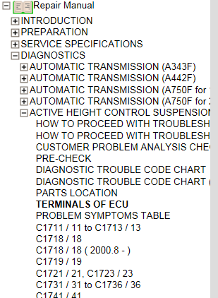

Relevant FSM References:
LC100 Workshop Manual - https://lc100e.github.io/
+ Repair Manual
+ INTRODUCTION
+ HOW TO TROUBLESHOOT ECU CONTROLLED SYSTEMS
+ HOW TO USE THE DIAGNOSTIC CHART AND INSPECTION PROCEDURE (choose your model year)
For 1998.8-, see pages IN-35 to IN38 in this sub-section for explanations and diagrams, including how probes from a multimeter are inserted for test purposes to the open back end of the connector at various ECU’s on the vehicle, without disconnecting the plug. Maybe this also is an item which should be reviewed? Note that this arrangement is different to the back end of connectors under the body etc which are sealed with a waterproof grommet.
+ Repair Manual
+ DIAGNOSTICS
+ ACTIVE HEIGHT CONTROL SUSPENSION & SKYHOOK TEMS
+ TERMINALS OF ECU – see Page DI-218

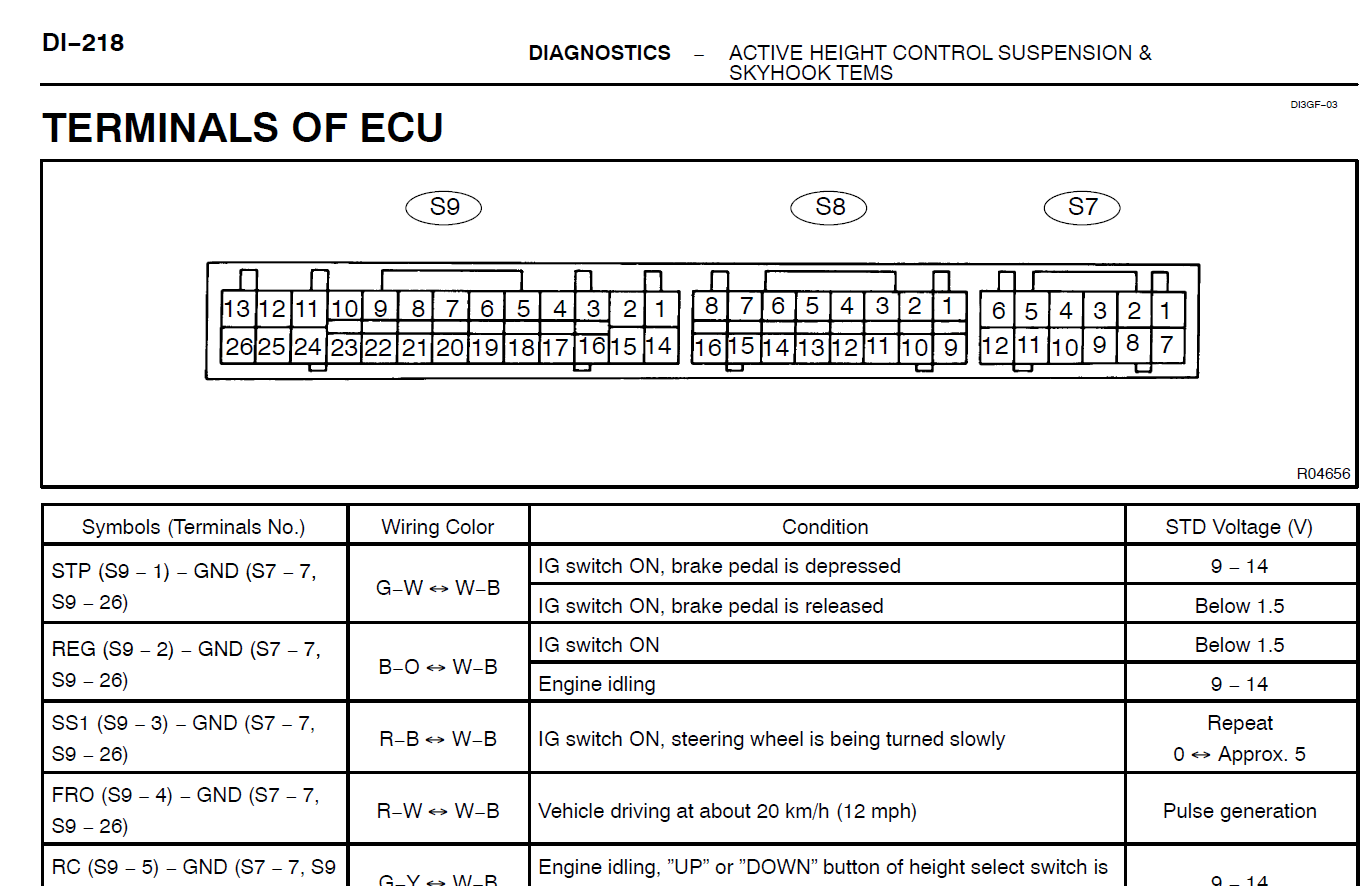

As usual I am still seeking information,
I still have my last project sitting in my workshop, still seeking the proverbial AHC fault that has evaded capture all this time.
My question is simple,
There is a chart in the FSM that tells us the respective voltages we should expect from each pin on the AHC ECU.
Yes I should have started by saying I have still to test the AHC ECU Thoroughly.
My question is, each line or box on that chart start with a lettered abbreviation for the test or pin we are about to attempt to test.
Can anyone direct me to the area in the FSM that explains what all these lettered codes are?
For example,
On page DI-218 Diagnostics Active Height Control Suspension & Skyhook TEMS
TERMINALS OF ECU
The first line of the boxed code chart starts with;
Symbol (terminal No)
STP (S9-1) GND (S7-7, S9-26)
And the symbols continue down through the chart such as
REG
SS1
FRO
RC. And so on.
Can anyone direct me to the part of FSM that explains what each of these lettered codes means.

The first attachment shows FSM Page DI-218.
At the top of Page DI-218, the three connectors at the ECU are shown, designated S7, S8, S9.
The column “Symbols (Terminal No.)” lists the connections to be made with a multimeter to check the Standard (STD) Voltage (V) under the “Conditions” shown.
I have not found an explicit and concise list of the abbreviations used in the first column in the table at Page DI-218. The information under the heading “Condition” gives a few clues, some are intuitive, some are a little harder to guess! However, the AHC Electrical Wiring Diagram (EWD) provides a way forward -- see details further below.
The wiring colours are self-explanatory (although there can be some differences across different vehicle models).
By way of an example, in the first line in the table at FSM Page DI-218, testing the ECU connections with the Stop-light circuit is described:
STP means “STOP” (meaning the Stop-light circuit).
GND means “Ground” (meaning electrically grounding to the chassis/body/engine of the vehicle) – this is represented by two different pins, specifically, Pin Number 7 at lower far right at Connector S7 AND Pin Number 26 at lower far left at Connector S9.
“STP (S9 – 1) – GND (S7 -7), (S9 – 26)” means check the Voltage under the prescribed conditions with the multimeter at the Stop-light pin (S9 – 1) and separately at EACH of the Ground pins (S7 -7) and (S9 – 26)
This is hard work because the ECU is tucked away under the dashboard (see Post #941 this thread) and the holding bolts need to be accessed and released to allow the ECU to swing free and so as to allow better access to the three connectors S7, S8, S9 at the ECU. The idea is for thin multimeter probes to be inserted beside where the wiring enters the plug, so as to reach the relevant terminals while the three connector plugs are still in place in the ECU and while the "Condition" requirements are followed. The attached Inspection Procedure may be helpful.
Be aware that the AHC Main Relay is attached to the ECU or it is nearby (location varies slightly on some models). If this relay is defective, then there will be no AHC or TEMS functionality at all. There is a test procedure for the AHC Main Relay in the DIAGNOSTICS section of the FSM -- look for details under C1743. The AHC Main Relay is not to be confused with the AHC Motor Relay which is located in the Junction Box in the engine bay.

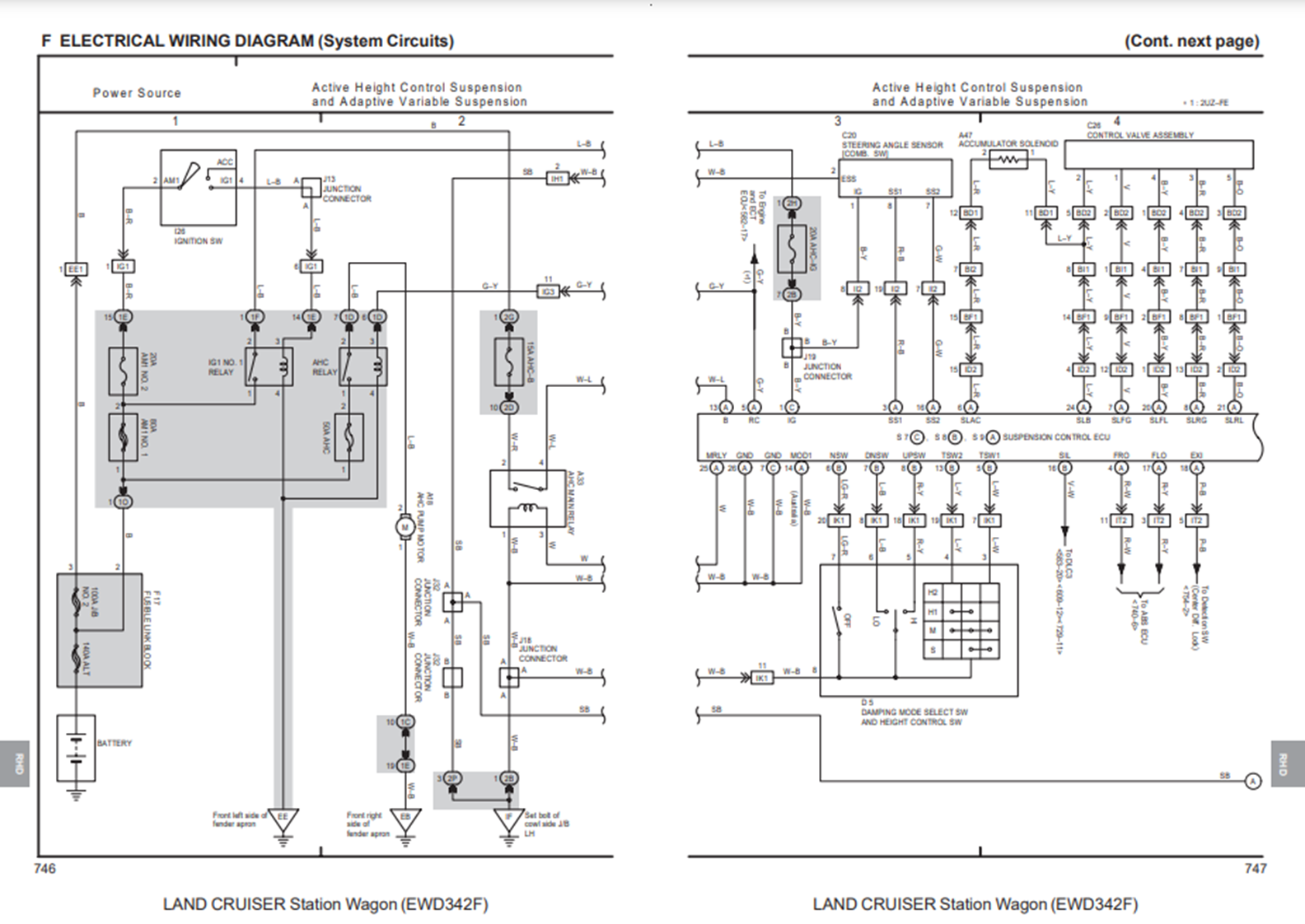

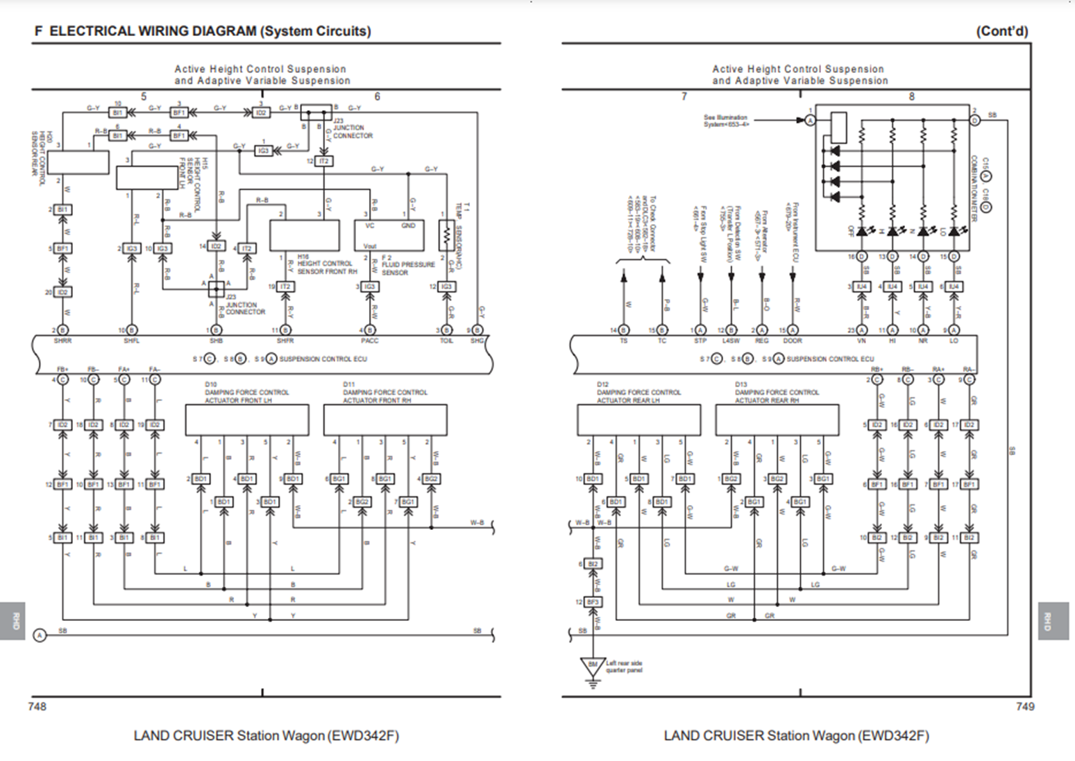

The second attachment shows the AHC Electrical Wiring Diagrams (EWD) over two pages for RHD LC100 1998. These diagrams also can be found and expanded more clearly on a screen at the usual FSM on-line link:
+ Electrical Wiring Diagram
+ OVERALL ELECTRICAL WIRING DIAGRAM
+ Active Height Control Suspension
+ 1998.1 – 2000.9 (or choose other relevant year)
To assist, images of the EWD also are shown below. The overall picture would be obtained by printing and joining together these parts of this EWD.
In each of these diagrams, start at the long rectangle which represents the ECU. The same symbols or acronyms appear on the long edges of the ECU 'rectangle' as are listed at FSM Page DI-218. Use the EWD as a 'map' and backtrack from each ECU connection along the circuits to see what component and function is connected to the ECU at these points.
