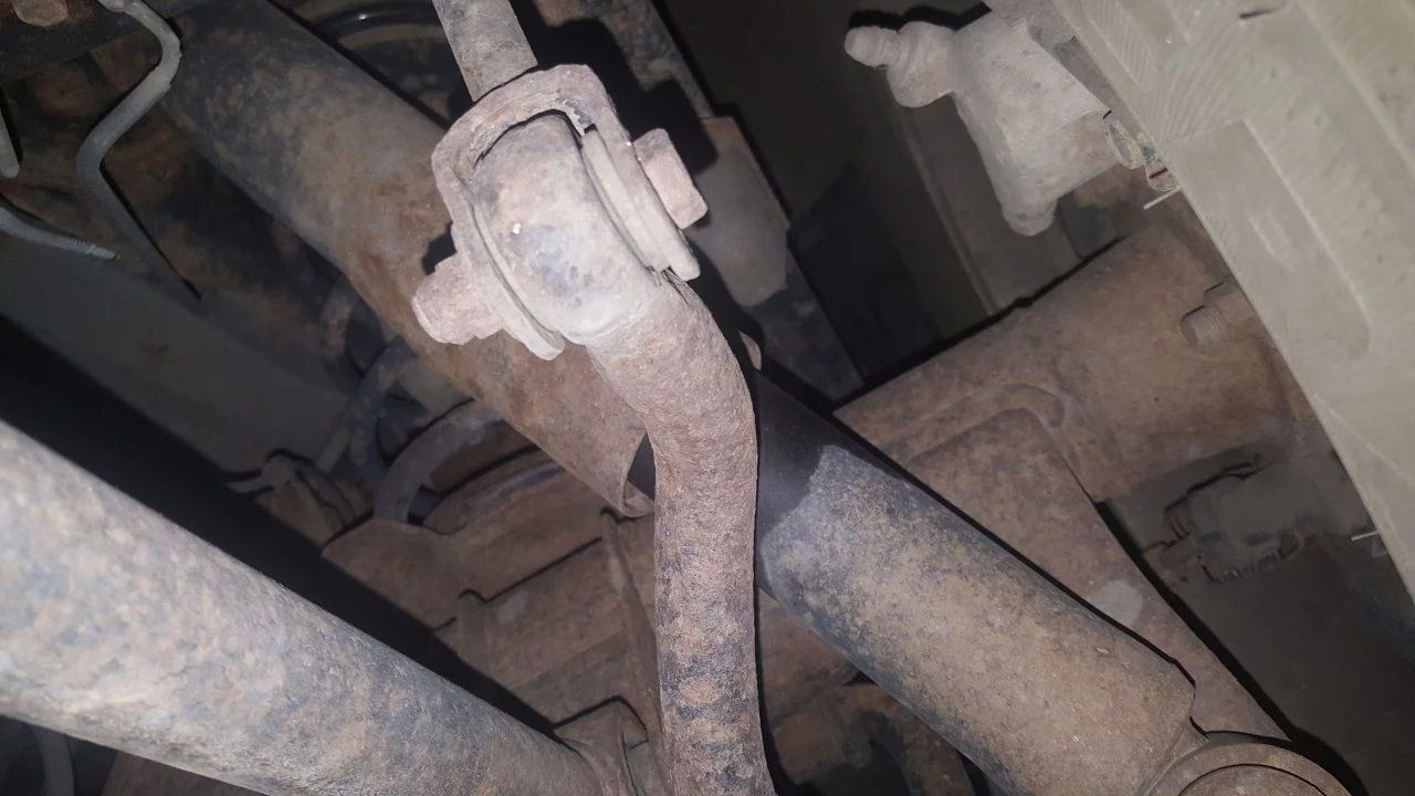

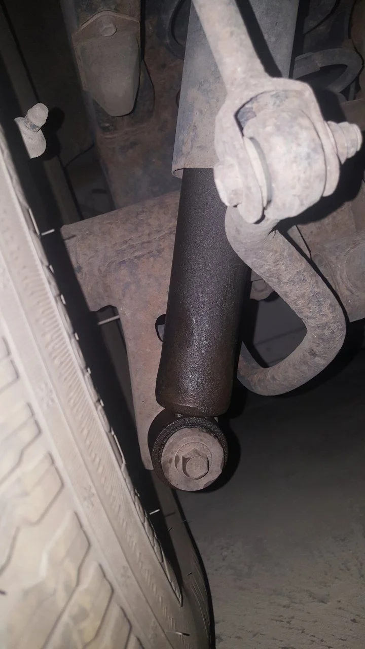

I was looking over my suspension system today and noticed my shocks are seeping. My AHC fluid level appears to me fine. Does anyone know how soon the shocks would need to be replaced, or how long they normally last once they start seeping?
How's your rear neutral pressure? High pressures and fluid that has lowered viscosity will definitely cause weeping. Get that pressure down to the lower half of the pressure range and I bet it will self heal.
Do you know your rear pressures? I would assume that they are high. From what I've read that's why the shocks start seeping is from high pressures, but once you lower the pressures back down the shocks can "fix" themselves. Once I lowered my rear pressures I did see less accumulation of fluid on the body.

Im flying blind with my pressure. But based on my ride quality i am guessing it is high. I have yet to purchase techstream.
I am thinking the rear springs are due to be replaced. The front passenger side is seeping as well, so torsion bars probably need to be dialed in as well.
One of my rear shocks started weeping 5 years ago, and still working fine. Never lost any measurable amount of fluid. Always looks a bit sweaty, but staying the same year after year.
It started weeping after I forced it off the lower mount without undoing the top mount, which should normally be OK to do. This was when I cut away the shock's rusted outer shield and replaced it with a plastic tube.
