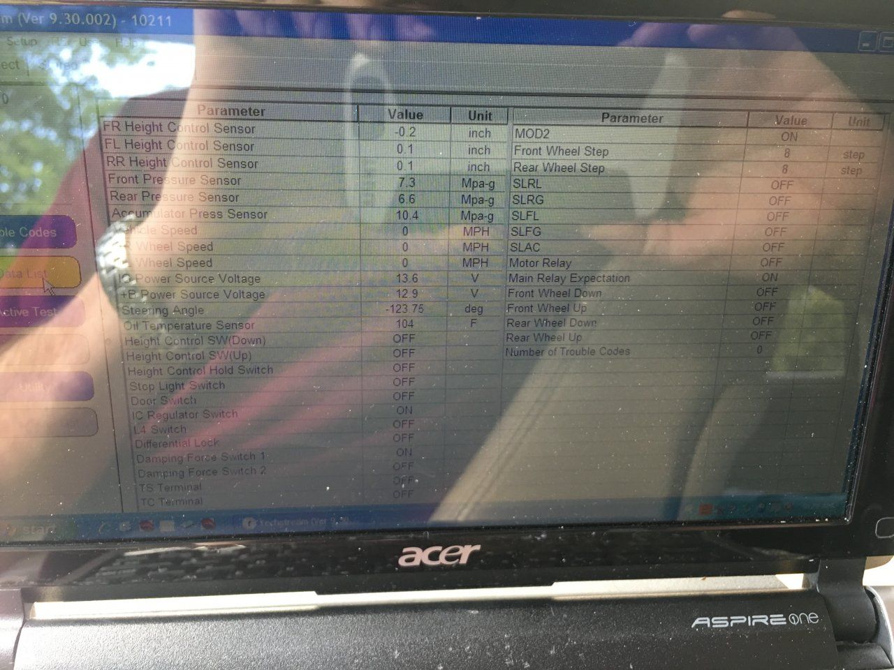

Here is a screenshot of techstream after the fluid change, after going L to H. My front pressures are elevated due to the street in front of my house is a slight incline. It's the levelest place without driving a good bit.
I am completely perplexed as to why it's so bouncy with the pressures in spec and new fresh fluid. The system cycles properly through all modes. I feel and see on techstream a change when changing from comfort to sport.

...Here is a screenshot of techstream after the fluid change, after going L to H. ...
Is that screenshot after going up to Hi? Or to N?
And what is the physical height difference between Lo and N at the rear wheels, left and right?
That is going L to N. Height difference is 1.5" driver 2" passenger.
