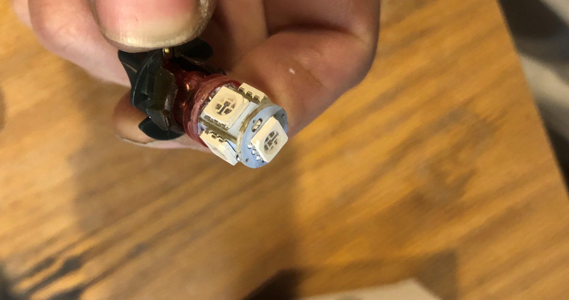

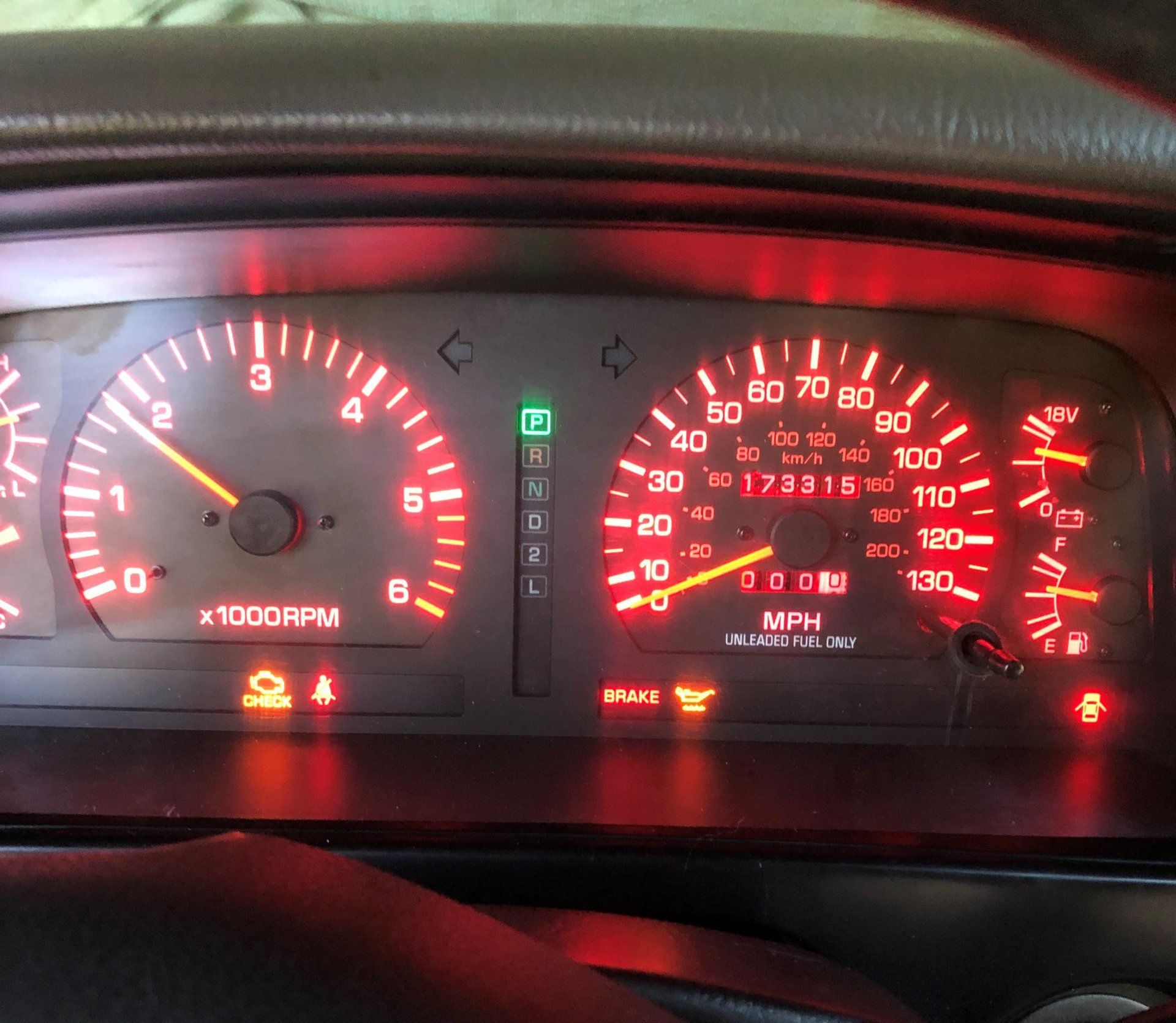

My speedo side bulb went out which made night driving a bit sketchy. I decided to jump on the led bandwagon as well, and ordered the 194 style red led bulbs from superbrightled's. They are the bulbs that have 5 diodes and spread light in all directions. I feel like they do not "seat" into the twist lock bulb base very well. Has anyone else had this issue?
Also, when puilling bulbs at a picknpull or whatever, the "ramps" on the bases may be slightly different which will not allow the bulb to lock in properly. I grabbed some bulbs from a Camry, and a Corola last time, and they didn't want to work for me (only for the biggest 194 type bulb bases, the little guys seemed ok).
I discovered a similar issue while pulling sockets to attempt a somewhat factory turn signal mod. the "ramps" on the 3 wire base are narrower. I may be able to work around with a thicker o-ring though.
Here's one of the little guys I used,
and the results
@MrMikeyG I typically drive with my cluster very dim on purpose, do you know or have you been able to test if these dim and if so do they dim well? The multi directional LED i think is key for your cluster looking so even.
I didn't test the dimmer at all yet. The 08 Tundra I have has red dash, that was my main reason. I thought about going blue, but too late 90's VW Jetta. If I can get a reasonable quitting time this week, I will do some real world testing. I'd really rather not get into my dash again any time soon. I can barely get the HVAC harnesses undone, and the middle bezel part that span the whole width is already cracked above the steering column.
It may be better to pull the steering wheel for a lot of dash fiddling.
