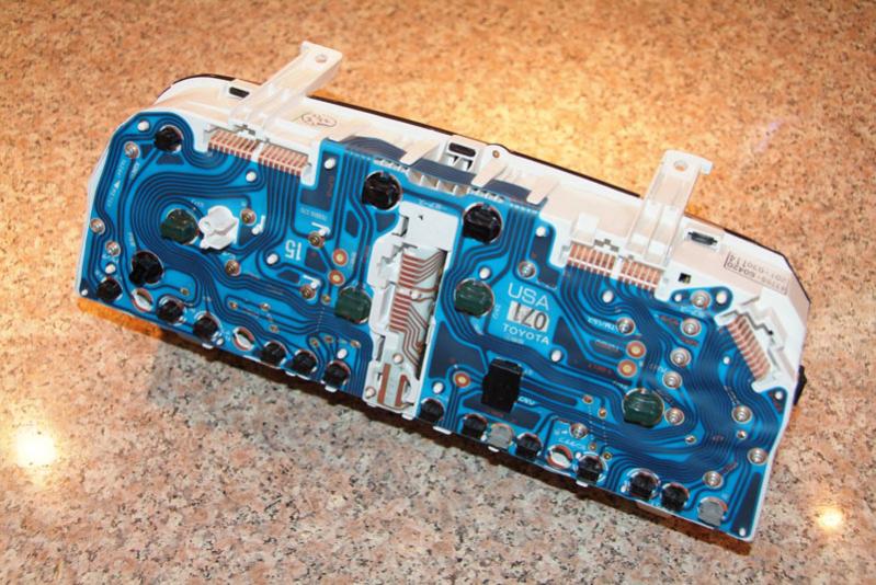

LEDs:
Shift Indicator
(1)Type B - green------------------------------------------------autolumination - Neowedge Item # Single Led Type B Blue 2.99
(9)Type B - white------------------------------------------------autolumination - Neowedge Item # Single Led Type B Super White 2.99
Turn Signal Indicators

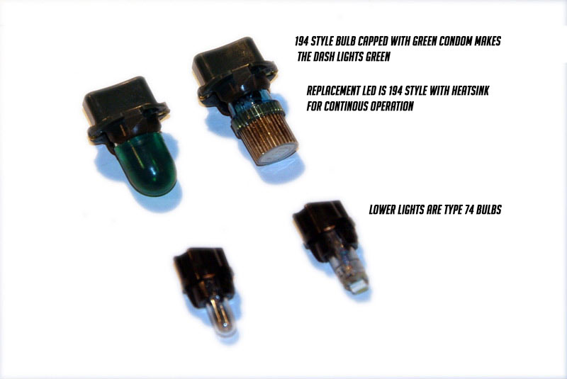

(2)194 - white---------------------------------------------------autolumination - T10 Wedge Item # Superstar W/Heatsink Super White 7.99
Gas empty
(1)194 - white---------------------------------------------------autolumination - T10 Wedge Item # Superstar W/Heatsink Super White 7.99
Cluster
(4)194 - green---------------------------------------------------autolumination - T10 Wedge Item # Superstar W/Heatsink Blue 7.99
(18)Type 74 - white----------------------------------------------autolumination - 74 Item # Superstar Led Super White 2.99
(3)Twistlock bases needed to add bulbs to non-us holes------------autolumination - Twist Lock Item # 74 .29
Defrost
(1)Type B - white------------------------------------------------autolumination - Neowedge Item # Single Led Type B Super White 2.99
(1)Type B - amber-----------------------------------------------autolumination - Neowedge Item # Single Led Type B Red 2.99
Rear Heater
(1)3mm Green LED (soldered)---------------------------------------superbrightleds - RL3-B2030 Blue 3mm LED $ 0.63
(1)3mm Amber LED (soldered)---------------------------------------superbrightleds - RL3-R5030 Red 3mm LED $ 0.60
Hazard
(1)Type B - white--------------------------------------------------autolumination - Neowedge Item # Single Led Type B Red 2.99
Antenna
(1)Type A - white--------------------------------------------------autolumination - Neowedge Item # Single Led Type A Blue 2.99
PWR/2ND
(2)3mm Green LED (soldered)---------------------------------------superbrightleds - RL3-B2030 Blue 3mm LED $ 0.63
CenterDiff
(1)Type B - white---------------------------------------------------autolumination - Neowedge Item # Single Led Type B Super White 2.99
Security
(1)5mm squared off LED (soldered)
Heater
(3)Type B - green--------------------------------------------------autolumination - Neowedge Item # Single Led Type B Blue 2.99
(12)3mm green LED (soldered)--------------------------------------superbrightleds - RL3-B2030 Blue 3mm LED $ 0.63
(2) 3mm amber LED (soldered)--------------------------------------superbrightleds - RL3-R5030 Red 3mm LED $ 0.60
CigLighter ring
(1)Type B - green - removed from base (soldered)-------------------autolumination - Neowedge Item # Single Led Type B Blue 2.99
Floor Shifter
(1)Type 74 - green-------------------------------------------------autolumination - 74 Item # Superstar Led Blue 2.99
Key Ring
GloveBox
(1)Type 74 - white-------------------------------------------------autolumination - 74 Item # Tri-Power Super White 3.99
AshTray
(1)Type 74 - white-------------------------------------------------autolumination - 74 Item # Superstar Led Blue 2.99
Visor/Vanity light
(2)31mmX5mm fuse looking thing-----------------------------------autolumination - Festoon Bulb Item # 3 Led Super White 7.99
MapLight
(1)Ba9 - white------------------------------------------------------autolumination - Bayonet Item # 48 Led SMT Array Cool White 24.99
