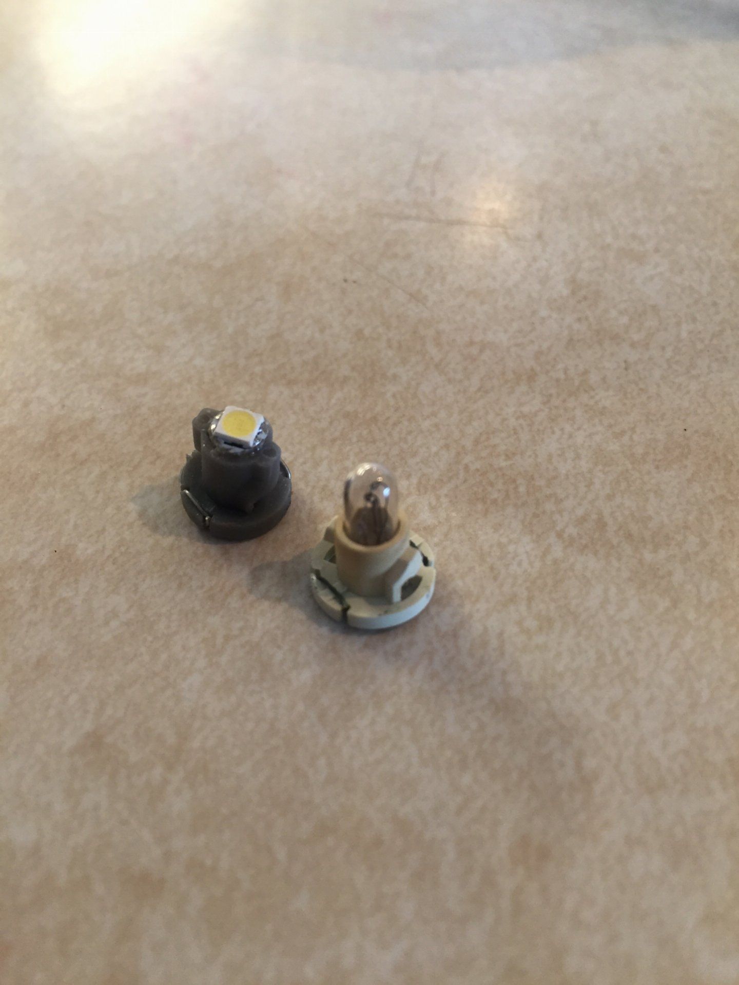

Just replaced mine, technically found it under "t4", i bought some on amazon...be careful, becuase the led ones were garbage, since they were diodes i did try spinning them 180, with the same results, about 3/10 worked. Though for 7 bucks per 10, its expected. I also bought some incandecsent ones incase, and they worked great, just swaped the boot in the green dash lit ones. Just search amazon "t4 dash lights", just be weary of the leds on there

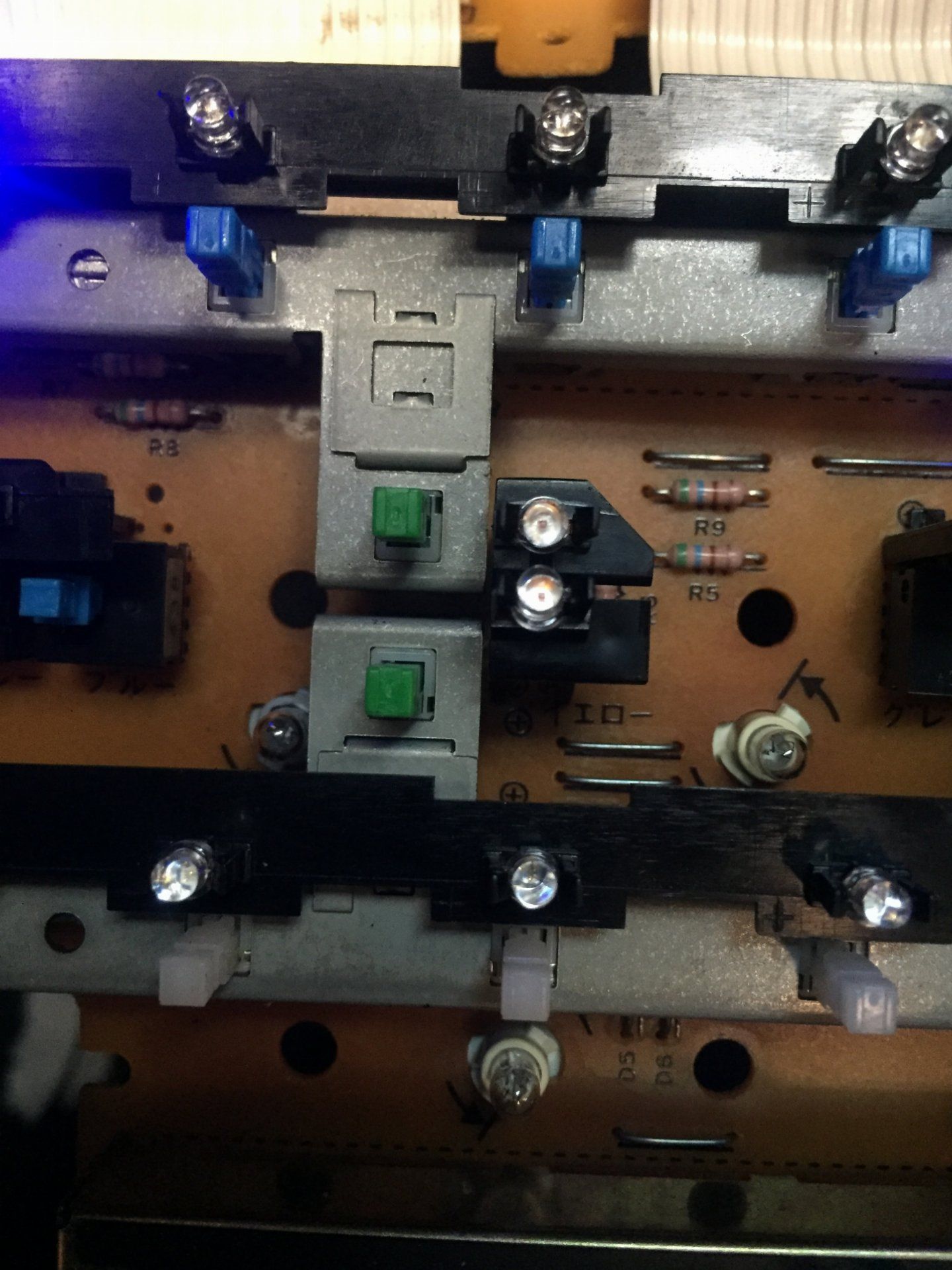

Okay, did the full LED swap in my original HVAC controller... LEDs all work fine but the main 3 illumination bulbs are dead, I swapped them for LEDs and those didn't work at all, put standard bulbs back in and nothing. Any ideas, maybe the controller solder traces are actually dead? In the bottom pic, all three of those light should be on because the parking light circuit is enabled...

I got a 2 pack of type 74 incandescent bulbs (the ones for HVAC controls) from batteries plus for 5 dollars the green condoms broke when i removed the old bulbs so I am just running white and its not horrible really not much of a difference.
Let me know what you figure out here. I still have incandescent in mine. One of the three worked when I got it. I put new bulbs in there and no change. I am guessing there is a board problem. If you find your problem let me know where.
I am also going to have to go in and look at the button enabled lights themselves. My vent location control lights do not work consistently. I can press the button and sometime the green light turns on and sometimes not.
