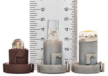

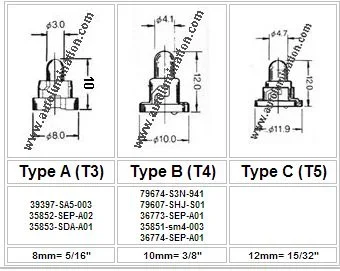

Type A (T3) and type B (T4) to start. Post 11 has the picture and the size. There is only (1) Type A (T3) in the entire vehicle and that is in the antenna switch. Every other bulb, with the twist lock base, is a Type B (T4). Reference post 87 for what I finally used to get the antenna switch to look OEM.
The OEM dimmer does work with the LEDs so, I wouldn't be too concerned about them being too bright. In post 72 and 76 I reported that the LED versions were too dim and did not match the OEM look of the incandescent bulbs. Because of this, I started replacing the LEDs with type 74 SMDs (post 76). It has been awhile and it now appears you can buy these made this way. How awesome is that! I recommend not buying the LEDs that are not SMD for type A and type B.
In the pic above, the type A is on the left and the type B is on the right.
The top one is a Type C and your Land Cruiser doesn't use those.
Make sure these will fit in the OEM switch. The ones I made out of type 64 SMDs were a lot shallower than the SMD ones Superbright sells. I copied the picture for reference at the bottom of this post. Staring at the picture, and comparing the latch, I would have to guess Superbright is using the TypeA in the picture that shows the height of the bulb. I can only assume the Type B is a little taller.

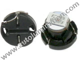

Here is a new one I know nothing about (could be too bright...who knows) but it is shallower in the event the SMD Type A and B from Suprtbright will not fit. Description says, "5630 Samsung - Outfitted with new 5630 leds which are 40% brighter".
If you happen to be on the Superbright webpage, these are listed as, "3 mm (T-1), 4 mm, 5 mm (T-1 3/4)" That is referring to the LED size and not the base. They should probably update the webpage to also include the size of the bases.
(Note - To choose the correct bulb, measure the diameter of the base)
Type A (T3)
8mm or 5/16"
Superbright NEO3-x is the T3 (8mm base 3mm LED)
Type B (T4)
10mm or 3/8"
Superbright NEO4-x is the T4 (10mm base 4mm LED)
Type C (T5)
12mm or 15/32"
Superbright NEO5-x is the T5 (12mm base 5mm LED)
