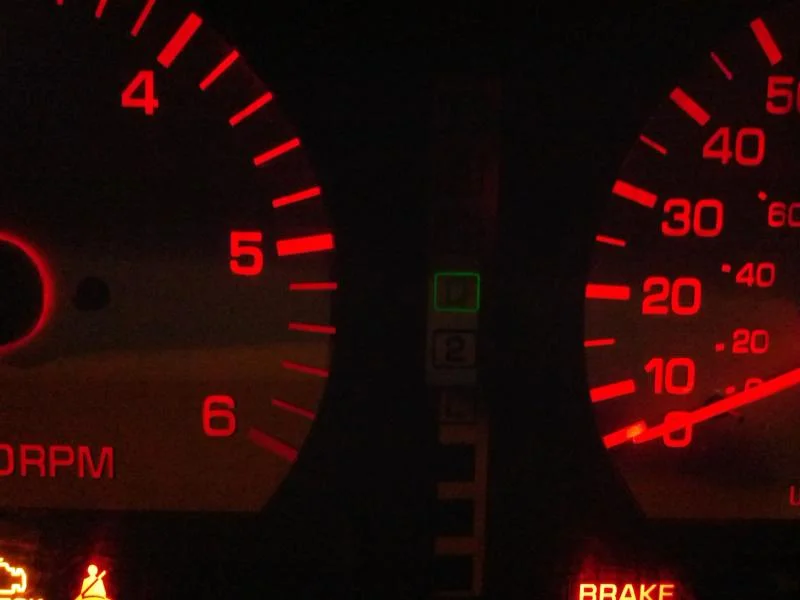

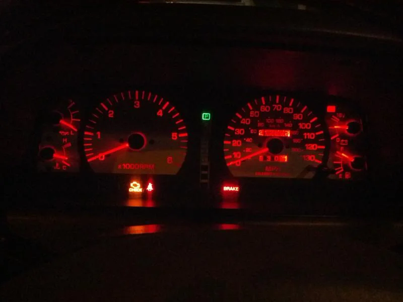

here are my reds in the dash behind my new white gauges. very bright and look great at night. I thought it was great for night vision to use red.

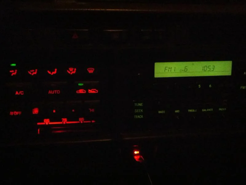

I also did red in the climate control cluster, I left allot of the LEDs that were soldered behind buttons but they seem very weak now especially during the day.

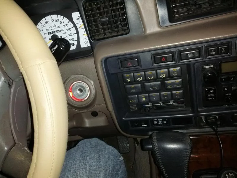

the key ring was turned to red to match, the doors got super bright white courtesy/ puddle lights. The two over head lights where done with 9 white led panels.
