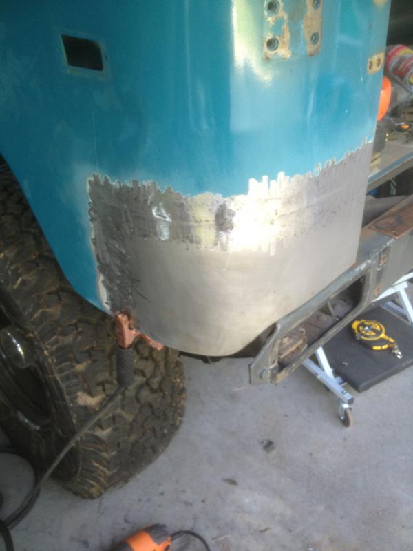

Time for a mini update: my travel schedule has severely limited my garage time since my weekends are booked with family time and honey do lists. However, I was able to sneak a few hours with the 40.
I have started the removal process of the rear sill. I was able to cut out the sill center and remove the 4 body mounts (with only one I had to hack out). I found a set of rear quarter patches locally that I plan to use as a back up if my home made ones don't come out to my liking.
Sent from my iPhone using IH8MUD
The rear quarters have been cut and the sill has been extracted. I have mocked up the new rear sill and will have to modify the new top sill cover to fit in place.
I have been balancing this project with my household to do list so it seems like it's very slow going. So far i am very pleased with how it's coming out but to be honest i am worried about welding the sheet-metal.

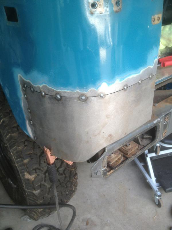

I got one rear quarter cut and tacked today. I swear by the copper backing plate and butt clamps i bought from Eastwood. My first attempt of welding sheet metal was ok.
Thanks for the tip. I so happen to have some for another project that is in the queue,
