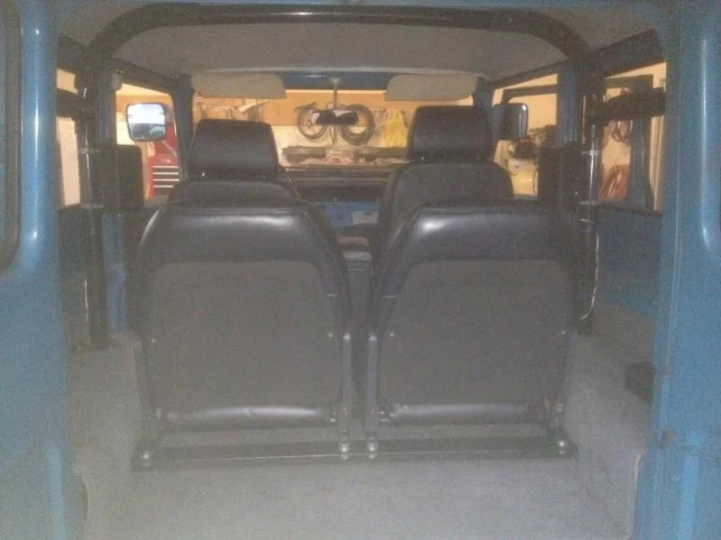

The new to me rear seats have been installed, two front seat frames have been cleaned up and painted and the Scat Pro 90 front seats have been added. The cruiser is now much safer for my daughter to ride.
My initial thoughts are;
1. The stocks seats were very well constructed and the Scat Pro 90 seats were not much of an upgrade. Yeah, they give me more leg room and fully recline forward but they look cheaper than the original seats.
2. The rear jump seats, in the up position, were great for gaining storage space in the cruiser. They just looked cool and added to the vehicle's character. The new to me rear seats are safer for the cargo I will be carrying and they were nicely redone to match the Scat seats. I will need to see how easy it is to get in and out of the cruiser before I know I made a good purchase.

Man those seats look great. Ran across the CL ad for them a few days after you bought them and inquired but they were already sold. Glad another MUD member got them. When are you going to start the OCD top install? Pulled the hard top off today and am about to start fitting the Real Steel bows. Wiley tells me it's a project so I'm setting aside a day to do it. Keep up the good work on your 40!
