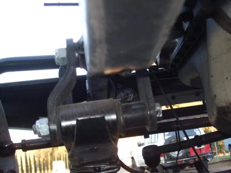

Has anybody seen a suspension setup like this? I have never seen a front spring shackler reversal rear shackle hanger designed and build like this.
attachment.php
It is an FJ 60 front axle and the springs are Semi-outboarded.
Proffitt's (RIP) outboard shackles. Same as mine. I determined I could get more shackle angle by using the stock hangers rather than going through the frame.
You might want to measure the flat length of the spring to be sure the shackles won't hit the frame before the spring goes flat. Looks to be pretty tight.
