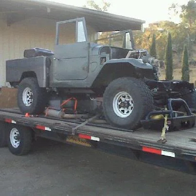

I'm sure I will have several question regarding the building of my 1964 FJ45 SWB. I will post them up as time allows me to work on the rig.
I'm looking for specific pictures of the rear cab mounts on the tub as well as the frame. My rig is missing both. The mounts have been physically removed from the frame as well as the cab itself.

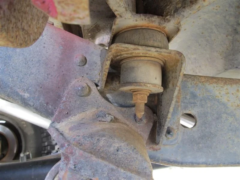

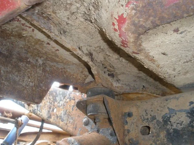

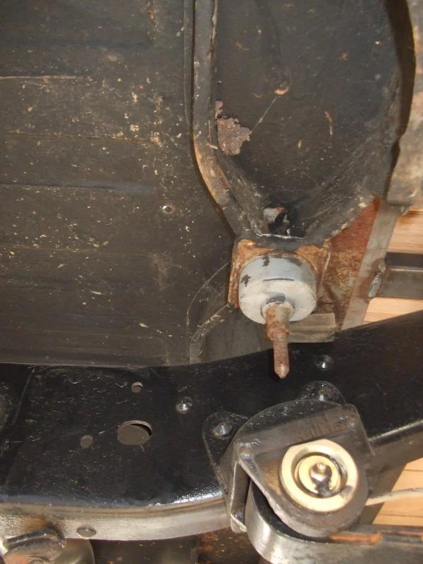

Dan, here is a pic of the rig I sold whitey a few years ago. maybe it'll help.
Paul

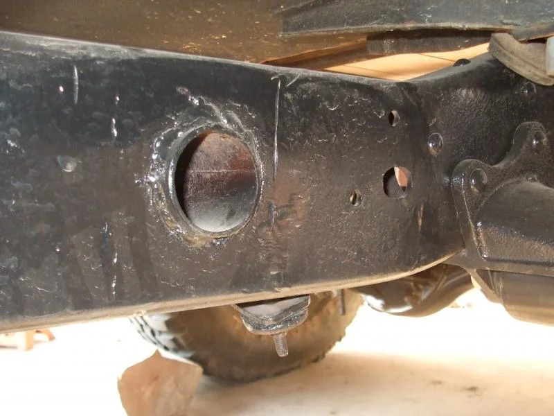

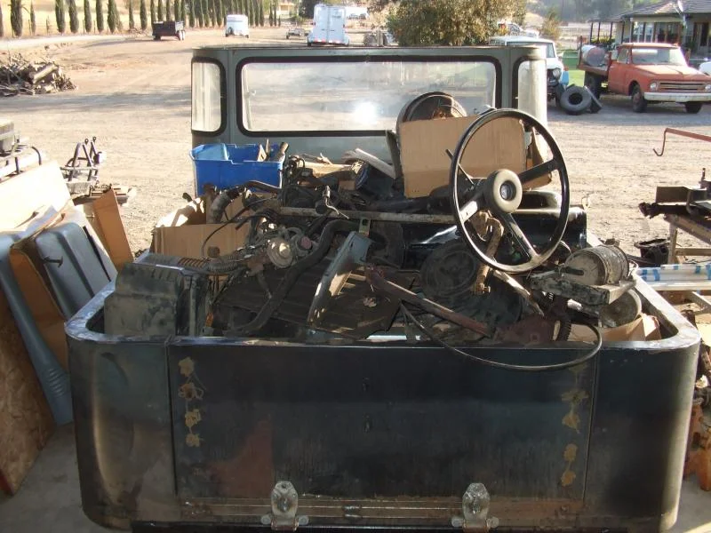

What is the VIN#, the rear cab mounts are different between the fixed top and remove-able top models, the cabs are a bit shorter on the fixed top models. Could this 45 have been a fixed top?

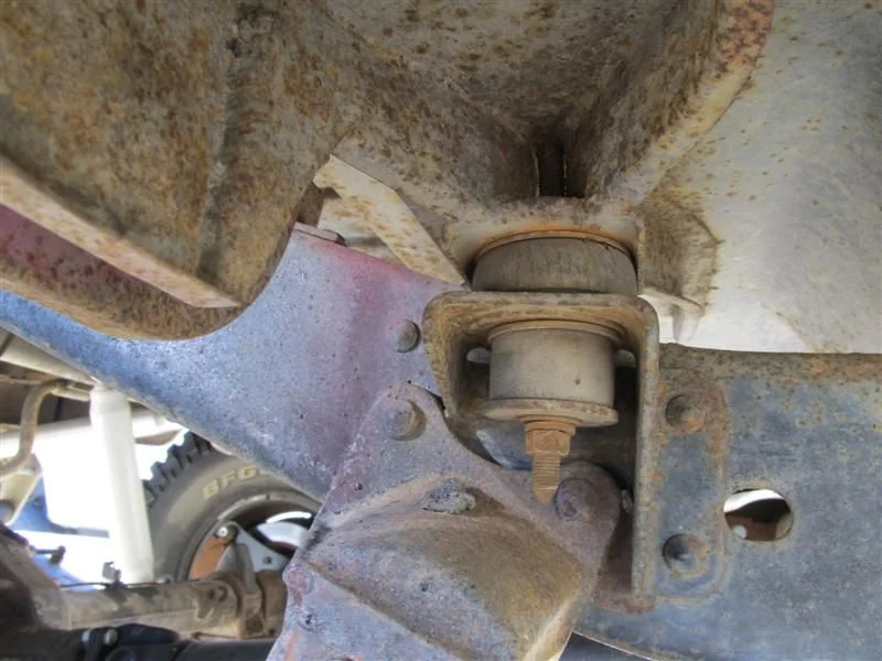

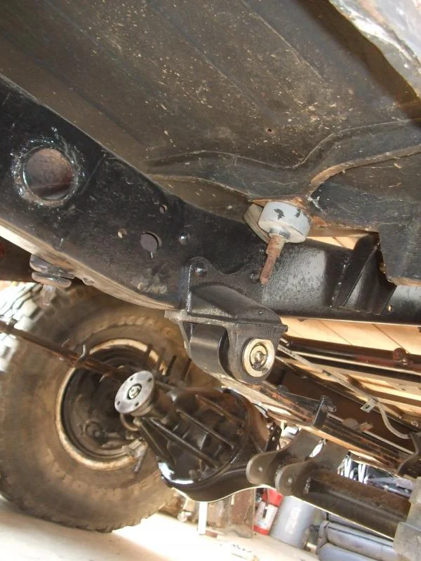

Here is a photo of the frame from the blue FJ45 SWB I did a few years back. Has all the stock cab mounts.
Dan, looks like you have a fixed top frame,the 2 holes foward of the rear spring hanger are the original rivet holes.If you look at Pauls photo the mount was right on top of the rear spring hanger.No big deal,you just have to do your own mounts.I have some partial 45 frames with some of the mounts,they are fixed top frames so it doesnt have the correct rear mounts,but it has a few bed mounts and the front cab mounts.Let me know if you need anything,or if your up this way come get them,I have been holding on to them for too long! Looks like another fun project!

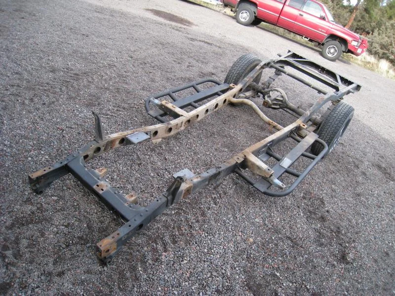

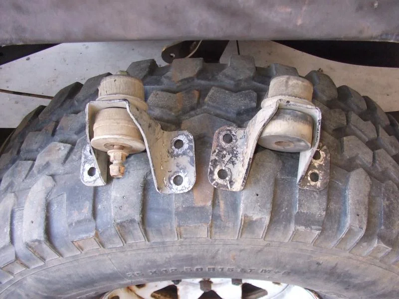

Dan, Does this picture help you out?
Original SWB Fixed top frame.. But removable top cab on the fixed frame. You can still see the original rear Fixed top cab mounts on the frame.

YOu need the mounts you have pictured earlier in post #7. I re-used my old mounts just notched em to fit around the spring hangers. Then used FJ55 Body mounts in the back of the 45 cab.
In theory. Yes. I have exactly your setup. Pulled the fixed cab and installed a removable cab on my frame.
