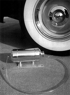

Coolent Recovery Bottle/Tank
Need some help. I've been all over Google trying to find something. This is the slickest I've seen, but at $170 it's more than I want to spend. I have a mini-truck tank that I'm about to figure out a way to mount. Anybody have other ideas? There was a section in FAQ, but it didn't do much for me. I'm thinking about going to one of the local speed shops and see what they might have.
Jon
That's better. I think the key word here comes from JEGS ... "recirculating." I saw the cans from Summit, but they seem to just catch the excess without allowing it to return.
