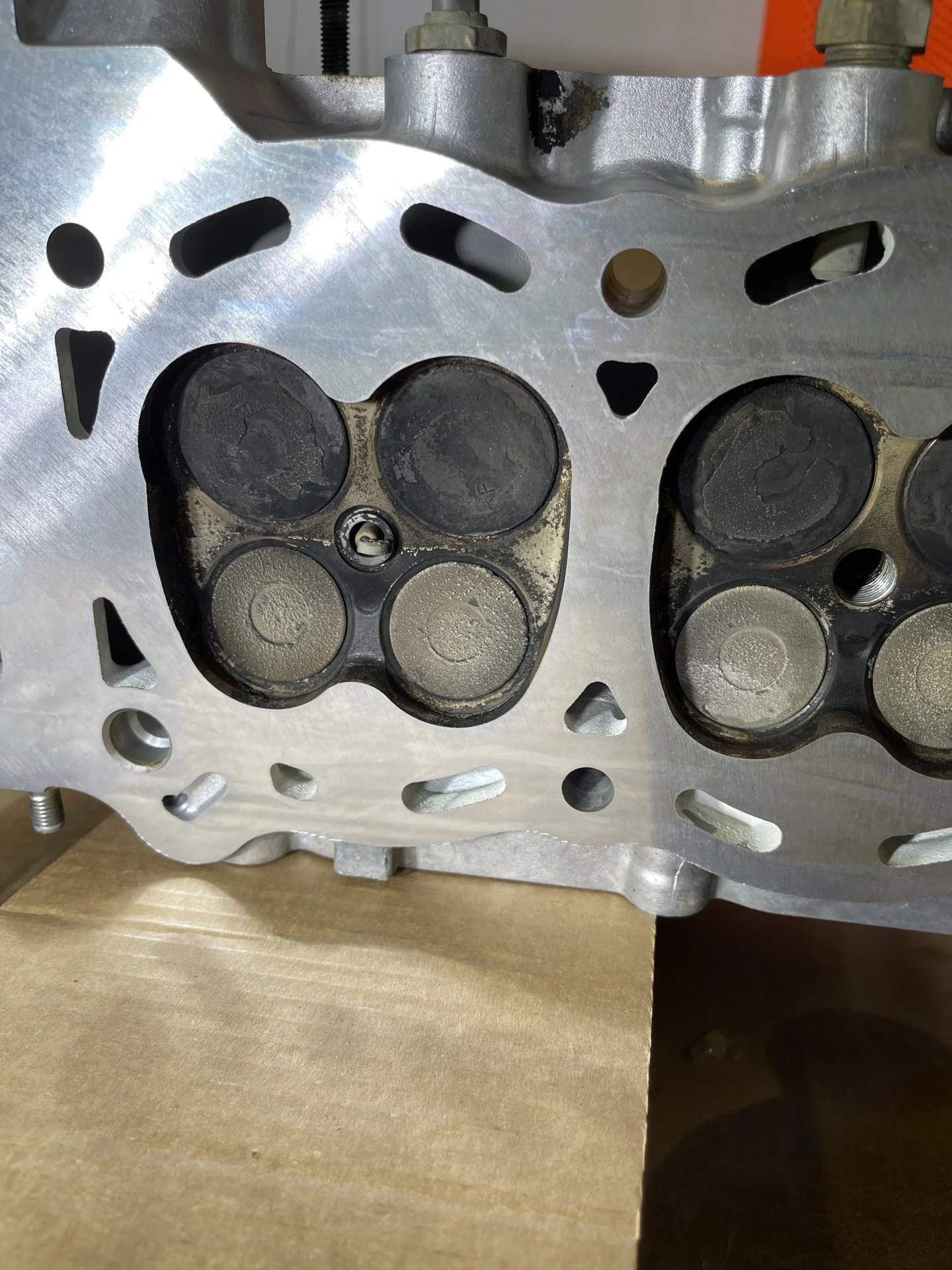

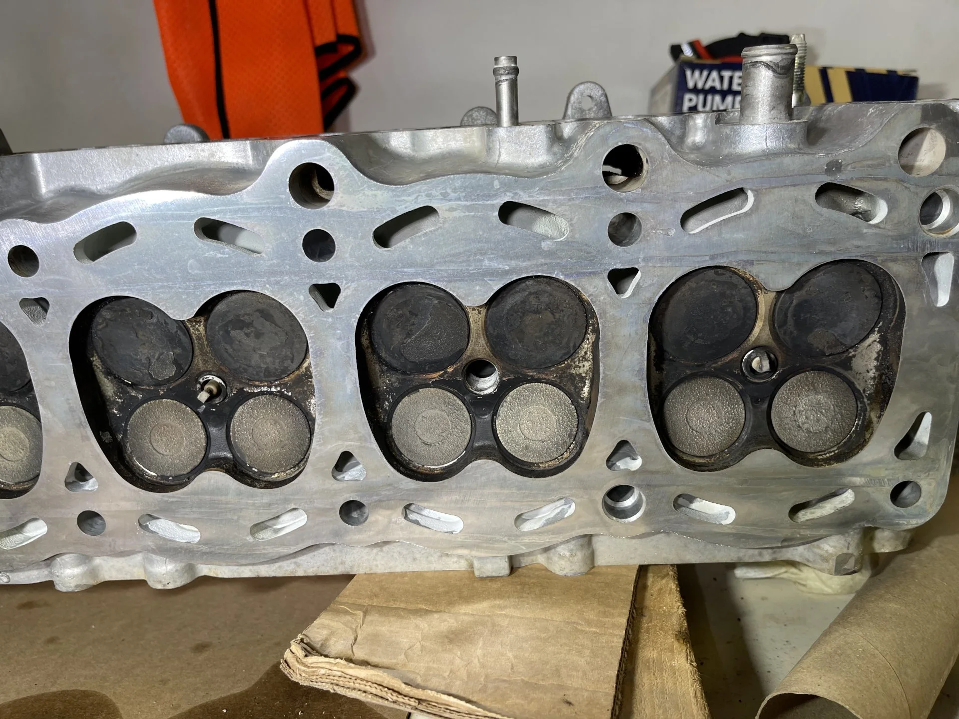

Just got my cylinder head back from the machine shop today and they told me they cut 0.006 off.
1) FSM states 0.15mm or 0.0059 in of warpage maximum. Technically this should answer most of your questions. Your head is toast !
According to this post, my head is toast..?
The shop recommended me to not mess/replace the valve stems and to not clean the carbon on the valves. I've talked to a Toyota Master Mechanic and he said he would clean them up for $200 but even he seemed to have the "you don't have to" attitude. Should I go ahead and have him clean the valves or am I being a typical over the top anal mudder? If it isn't too hard to mess up I figure new valve stem might be a good while you're in there thing to do.

The shop pressure checked the head and it was "in spec" but now im a bit skeptical because according to half k cruiser, my head is warped to the point where its "out of spec".
Thanks!

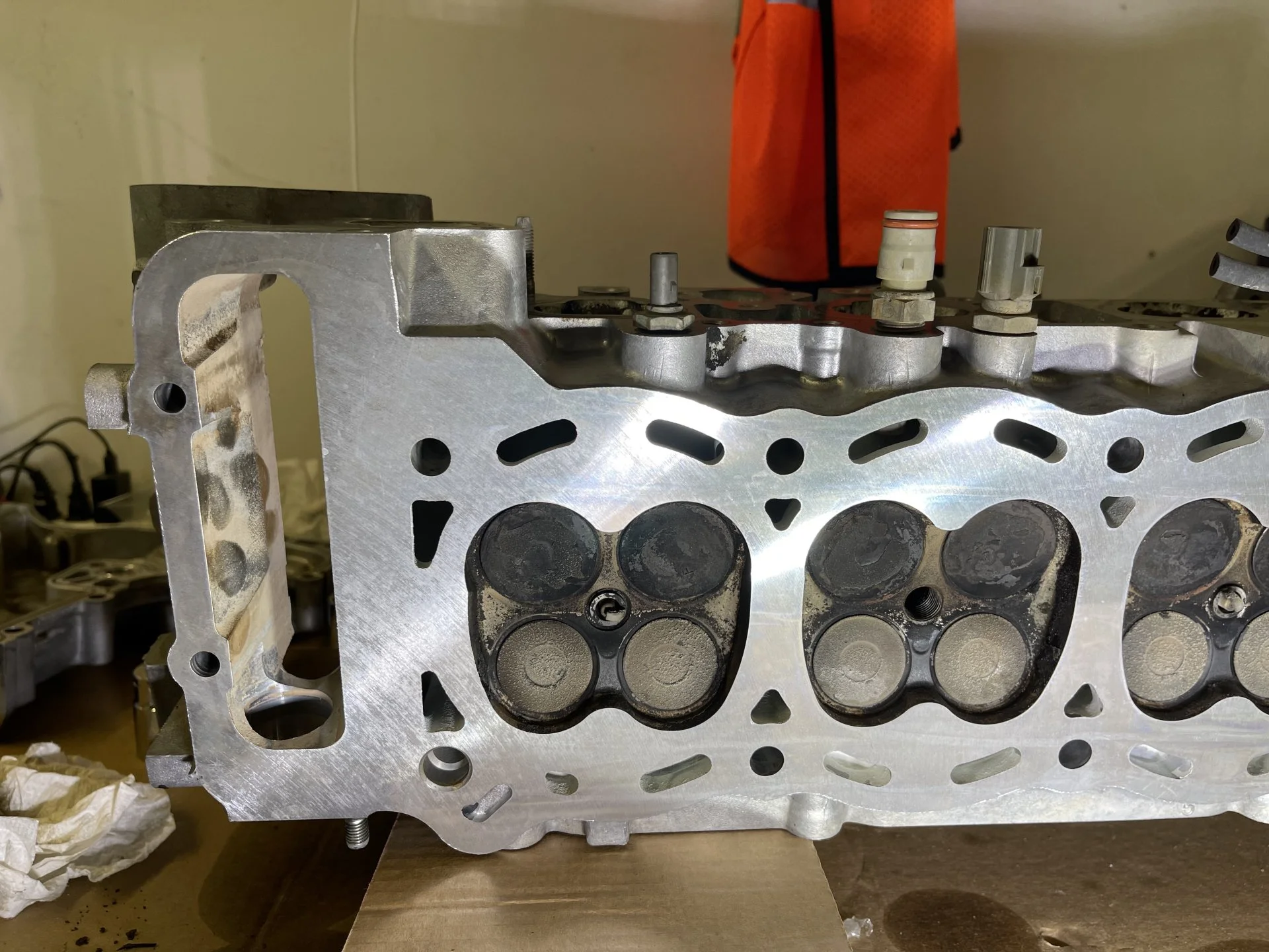

EDIT: Looks like the head came back with an extra dent on the exhaust side...

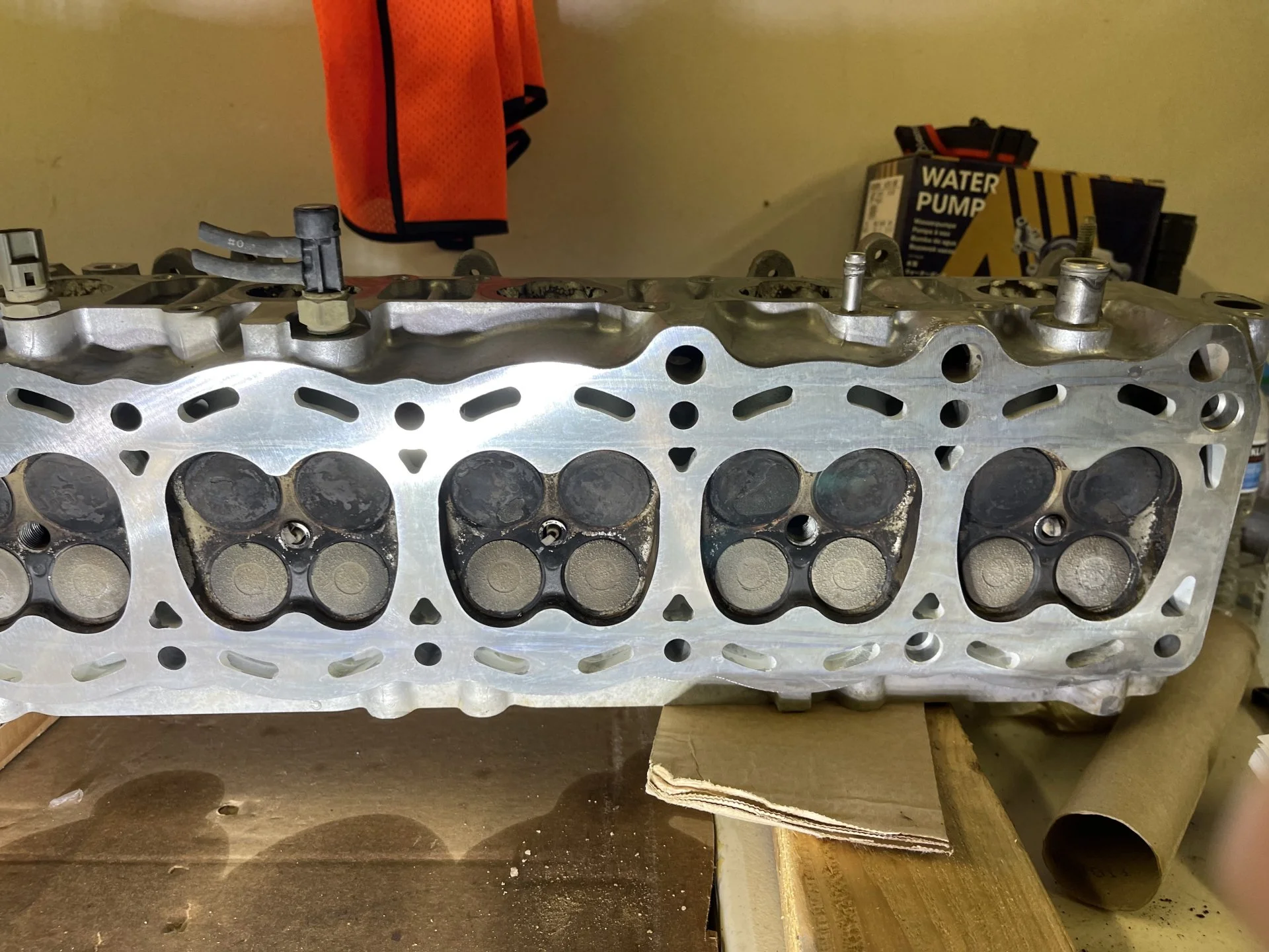

Not an expert in this area (or any) but why wouldn't the machinist clean off the carbon?? Looking at the photos closely it appears the head wasn't even cleaned around the seats, so does that mean the seats weren't cut? Were the valves themselves cut (none of the "Valve job" boxes on the form were checked)??
Seems like a thick carbon layer on the face (or any imperfect mating between the valves and the valve seats) might cause issues related to valve heating (absorption/dissipation/transference)??

That's what I was thinking, but the machine shop guy was so adamant about leaving it alone and leaving the valves in for the resurface...
Looks like he dented the side of the head too, it sure as hell wasn't there when I dropped it off.
I saw that in your picture. My brother and I bought an old boat years ago with twin 454 engines. After the first season we owned it, one engine blew a few valves. It was a big job working in the tiny engine compartment on those giant heavy heads so while down there, I rebuilt everything from the lifters, pushrods and the entire heads. We were usually 20-40 miles offshore in the wild Atlantic waves. I would have been very disappointed if something else failed because I had shorted something that could have been done easily since it was opened up. The following year the other side blew a head so we bought an emergency life raft !

If they seal and the seat surfaces are true, and if I didn't have to change valve guides/seals, I'd be tempted to leave it alone.
If I had to take the valves out anyway to change valve guides or seals, I'd probably soak the valves in carbon solvent and plastic or brass/bronze brush the worst of the carbon off.
Lots of "if"s. Did the head shop replace the valve guides and or seals for you?

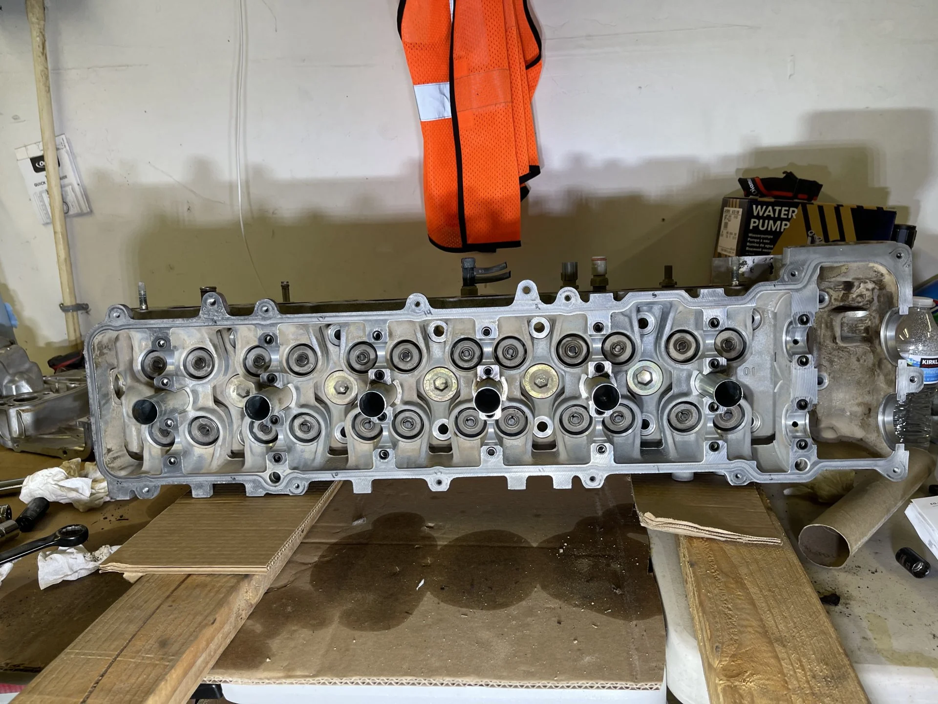

I know that everything costs something, but I'm struggling to understand how someone could be convinced to allow a machine shop to cut a head when it was assembled. How could you possibly know, before you cut it, that the head would clean up below the valves? How could a "reputable" shop guarantee that no valve damage would occur from their handling?
At the very least, the head should have disassembled and cleaned, because this is the only opportunity you have to do that. And it makes a difference.

a) your head is fine; at most, you need to have the valves trimmed to match the material removed from the bottom face.
b) I would never reinstall a head without at least cleaning the carbon off the valves and seats and then checking for seals on every valve. These aren't V8s where you can remove a head without removing anything but a valve cover.
FWIW, you can't replace a valve stem; you have to replace the entire valve and then they have to be, at least, lapped into the seats.
