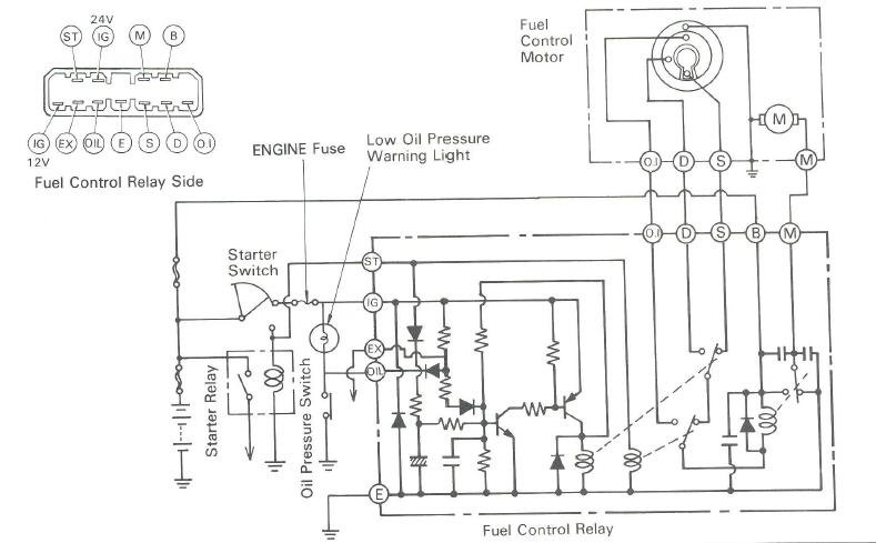

Control arm moves to 3 distinct positions in a way that seems correct and goes to stop if I ground the oil pressure switch or remove the ignition contact.
Only thing I need to check is if it's drawing power when the key is off, but my meter has apparently blown it's fuse.
With some tidying up of the wires it'd be pretty easy to install this in the engine bay.
Chicks dig the dangly red ball tho, so it's a tough call.
Wow!
I probably need the key to shutdown the truck to pass a Swedish safety so that's on my list to investigate...
Wow!
I figure if I ever had a vi I'd probably need key shutdown too.
I'd prefer to have a spare fcr before I put my eggs in this basket but won't be hard to throw the string back on if it s***s the bed.
Ya I will probably research those diesel shutdown solenoids and timer relays... Maybe I can sell a kit for guys who want an option or something
We'll get on it then. 🤣
With tractor, the solenoid is pretty cheap, it's the "operator presence control" that's spendy. Which is basically the timer relay.
There's a guy on the board somewhere building new fcr's.
Hell I probably have another, I'm sure I'm missing a box of edic and relay crap somewhere
Found the thread finally. Even gives a parts list.
There's aftermarket ones available now, but not cheap.
