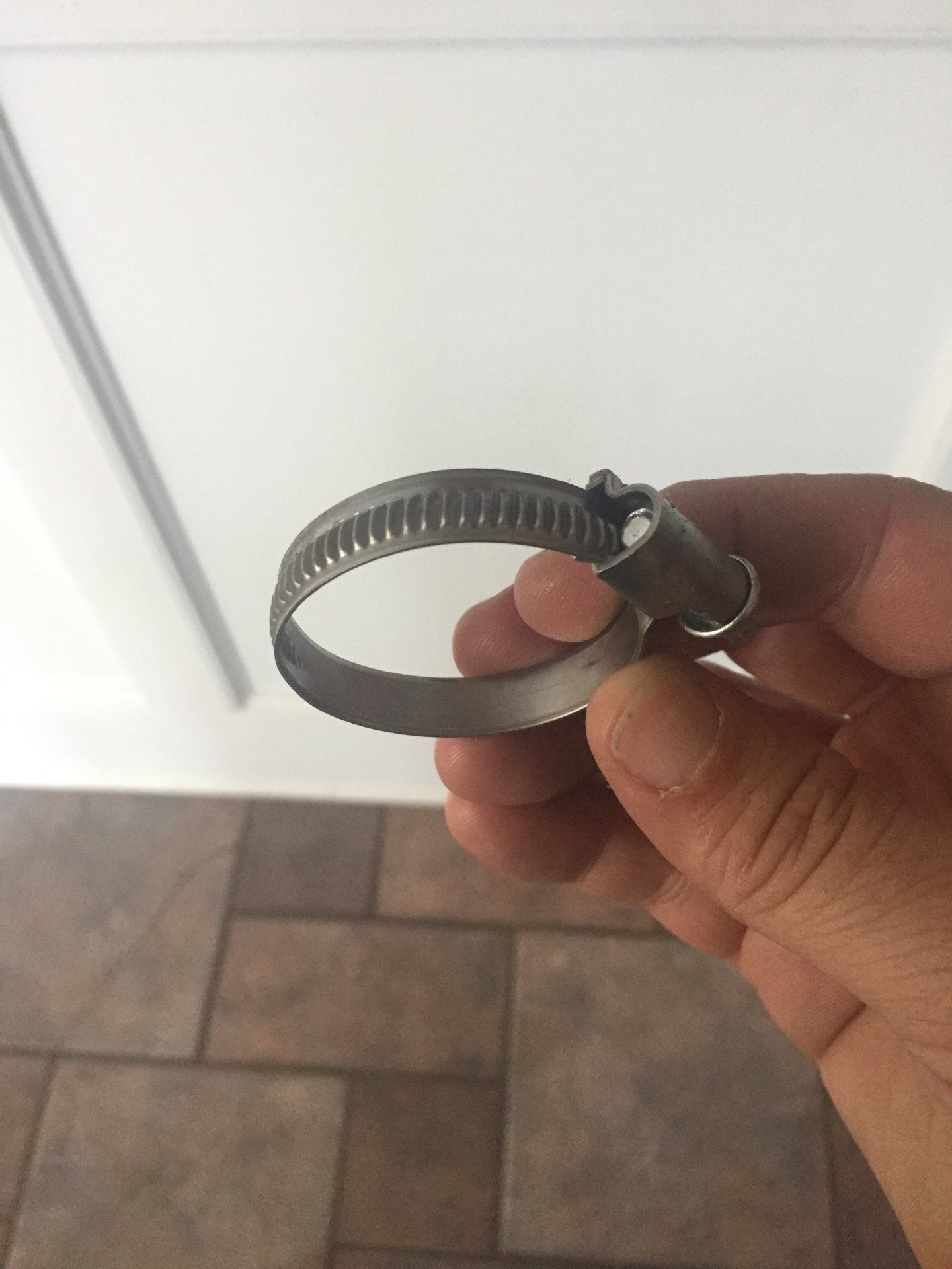

This is the only way I’ve found to deal with the seep without taking the axle off and is probably frowned upon but does work. Have had them hold for several years. It’s a stainless clamp without sharp edges and I’ve used them a few different times with good results. They are a European style, beveled clamp. I ordered a box of 10 for next to nothing.
