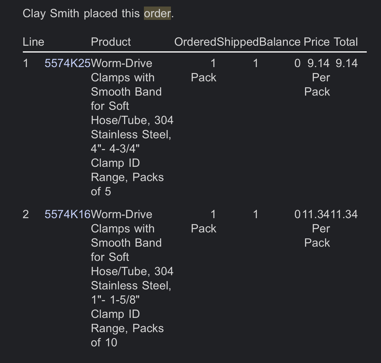

Hey folks, both of the smaller boot ends on the driver side are leaking on my '06 LX. The boot itself is in decent condition with no tears. I've been through this thread and several others and haven't come to a clear decision on what clamp to go with. I like the simplicity of the McMaster worm drive clamp but don't think I can bring myself to leave that on permanently. I will be doing it in-situ so would prefer an option that is doable with the access you have with the axle on the car.
Perhaps the best option I've found so far is what was mentioned in a previous (Amazon product ASIN B00D4NB4VE) and the $16 GearWrench tool. Did anyone actually use this and have success?
If anyone has a spare couple of the McMaster's I wouldn't mind them as backup (feel free to DM!)..
