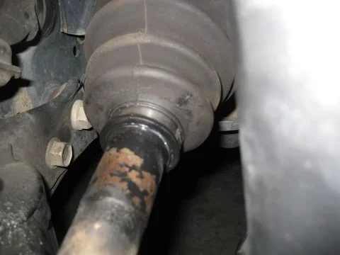

I have a 2000 UZJ100 rig w/ 110k miles on it. After reading several posts of people having issues with there CV boots leaking after doing an OME lift with and or without Slee's drop kit, I decided to take a look at my boots before my lift and drop kit showed up this week. I noticed that the small strap on both driver and passenger inner boot had signs of leaking (greasy dirt stuck around clamp). So, I decided to clean up the boots and see if it was really leaking. Well, After cleaning both boots and driving it around for about 10 miles I noticed that they indeed where leaking. I figure the dirty mess that was around the boot was holding a lot of it in, but once I cleaned them up they began to fling a very little amount out past the original clamp. I was able to easily twist the boot near the small clamp on the CV shaft on both sides. This told me that the clamps where no longer effective for one reason or another. I figured I better replace the clamps before the lift came so I would have one less thing to do when it shows up sometime this week from Slee.
I could never find a post on how to remove the original OEM clamps so I decided to post up something to help others in there efforts to remove and replace these CV Boot Clamps/Straps.
Step 1: Jack up truck place jack stand under frame and remove tire.
Step 2: Clean area around clamp as best as you can with rag. I did not use cleaning solvents as I didn't want to put anything on the boot that may make it brittle over time.

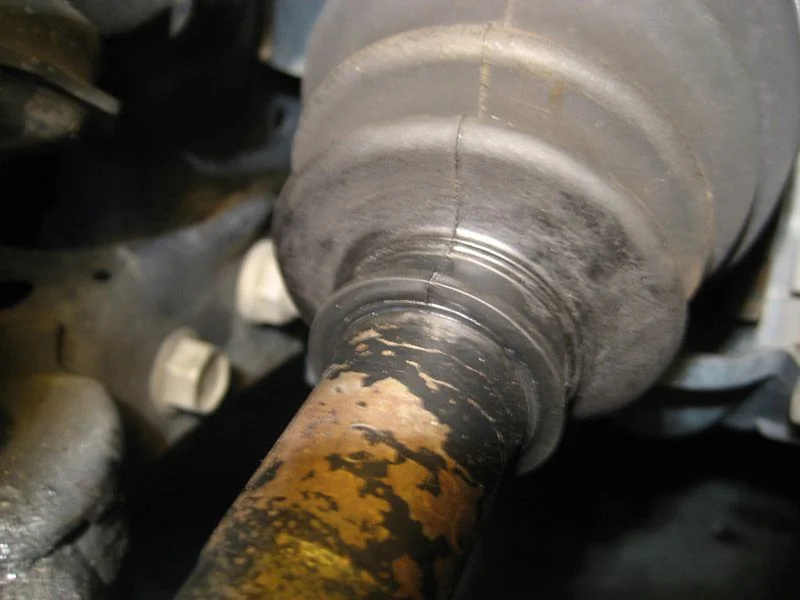

Step 3: Locate folding tab that holds the strap down on the clamp. Take very small flat head screwdriver and gently pry the two tabs back. Tabs will bend to the driver and passenger side of the vehicle. Once tabs are bent out of the way, you will be able to pull the strap back. This will loosen the strap. See picture:
Step 4: Now that the strap is loose you can take your snips and clip the strap off without damaging the boot in any way. Once removed clean boot with rag to remove any dirt to have a clean surface to put new strap on.

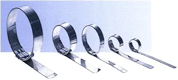

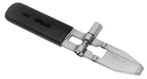

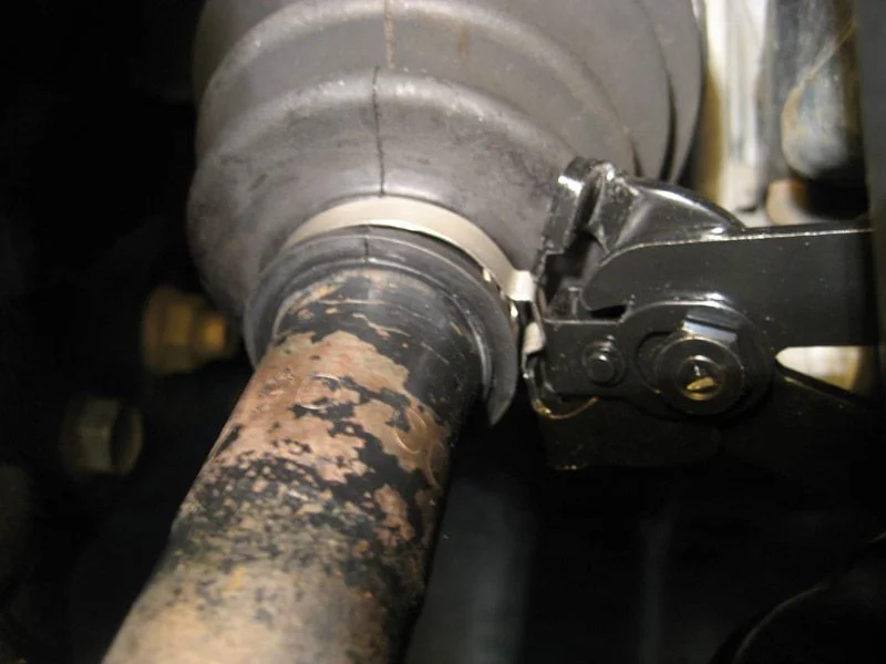

Step 5: Place your new Clamp in place and use CV boot Clamp crimping tool to tighten clamp. I would crimp then test how loose/tight it was the crimp some more. I did this until I could no longer twist the CV boot on the shaft. (NOTE: when I say no longer able to twist the boot I never put a ton of energy behind my twisting. Just enough to know if it would ever twist on its own. You will know what is tight enough). see picture of tool and clamp:
The attached picture is what the crimp looks like after install. Its not as flat as the OEM bands, but it seems to work just fine. These clamps are called "One Ear CV Boot Clamps. I found them at NAPA Auto Parts along with the tool.

I have only 100 miles on this job, but I will keep you all posted on how it holds up. I would say this is a one :banana: job. There are two different types of clamps/straps you can use. The One Ear Crimp style CV Boot Strap and the OEM kind. If I could have found a place that had the OEM style I would have gone that route only because it is lower profile. I have not had any issues with vibration and do not expect to either.
Anyway. Hope this helps anyone that is thinking about doing this job. Very easy to do and if it needs to be done again, it only take about 15 min. per side. :)

OK, after successfully replacing the smaller CV Boot clamps with the Single ear crimping style CV boot clamps I started to see leaking around the larger OEM CV boot clamps that where not replaced and decided to replace all of the larger bands as well. I Purchased the same style clamp as I used (in post #3) for the small side and for one reason or another I had issue getting them tight enough.
The problem I have found with the "Crimping" style is that you can only get them so tight. So, I went out to my local CarQuest parts store, who was the only parts store in the greater Kansas City area to carry the OEM style bands that you tighten and then bend back over itself, and purchased 4 big bands plus the tool.
This is the way I should have gone from the beginning. I'm not saying that the crimp style is horrible, they just have a limit to how tight you can get them. They work fine for the smaller CV boot end, but not for the larger CV boot end. My small CV boot bands are holding nicely and I will keep them as is unless they loosen up. If they do, I will replace with the OEM band style.
I just wanted to give my observations and experience for those choosing what direction to go when choosing clamps. Attached are the clamps and tool style I went with for my Larger CV boot Clamps.

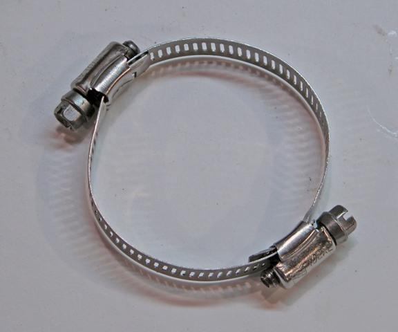

Question... I know they say not to use hose clamps on CV boots because you can tear them but if you were careful not to over tighten them, what would be the problem? Unbalanced because of the disproportion of weight? They can be tightened at least if not more than any of the CV clamps out there.
If you are concerned about the balancing (act), you can actually take two smaller clamps at put them together to have a "balanced" clamp (one screw at each side of the axle). Concern would of course be that you get another "thing" sticking out that could potentially get hung on a branch or a rock. But, I'd actually would be more concerned over the actual boot ripping than the (hose) clamp getting stuck.
Hoser, you beat me to it:beer:
