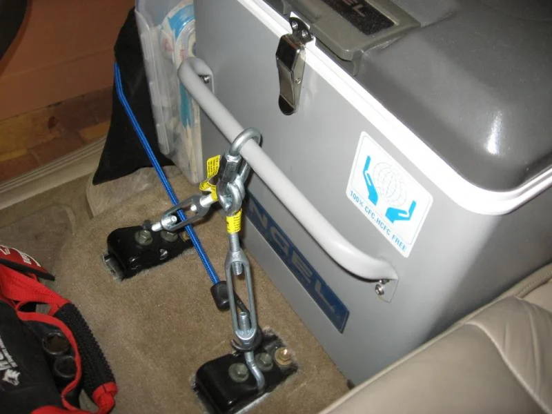

This project has been a long time in the making. I have put it off but my up coming trip to Moab pushed me to complete it.
I never liked the placement of the fridge/freezers on the top of the rear storage boxes with the slide out drawers. If you have a lifted truck you have to jump up on your tailgate to get to the content in the fridge. I understand if this is your only option, but I went a different route.

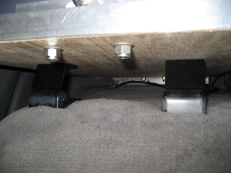

I wanted my ARB fridge to sit as low as possible to provide easy access to its contents. I found that the passenger side second row seat when removed provided a perfect space for the fridge. I wanted the stand to be removable but be integrated into my rear storage system. The back side of the stand is bolted to the back of the drawers using a 1 inch section of thick aluminum angle. I then fabed up some brackets to bolt the front of the stand to the factory seat mounts. I used ¾ inch pine for the stand itself. This provided a VERY solid foundation for the fridge and will never move.

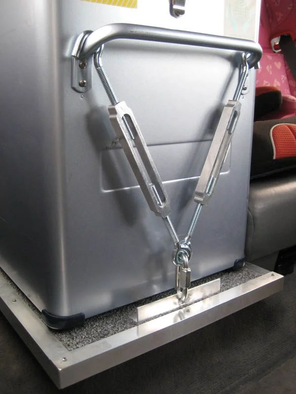

I bolted the same thick 1 inch aluminum angle at 6" long to the front and back sides of the stand for the turn buckles to attach to. I then added carpet to match rear storage drawers a as well as some aluminum angle to the sides to finish it off.
I can now fold the drivers’ side second row seat down and my twin size air mattress will fit perfectly next to the fridge.

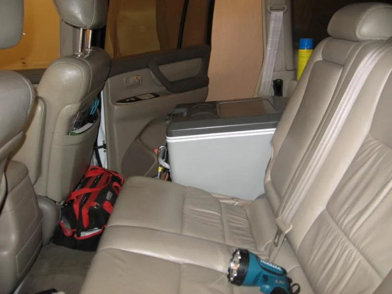

nice job! It would be cool if you could keep your seat in there and slide the fridge back and fourth when you lay the seat down.
might not even be possible, but it would be cool
awesome
Not to knock your idea down, but I'm not sure you would even be able to open the fridge door enough to get anything out if you did it that way. The fridge would sit up so high that when you open the passenger rear door to get to the fridge you would be looking at the side of it with little room between the top of the fridge and the top of the door jam. I could be wrong..
good point. I didnt think of that....
