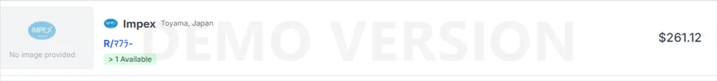

Impex show one available. Might be worth placing and order.
Any US dealer can get it in 1 day.

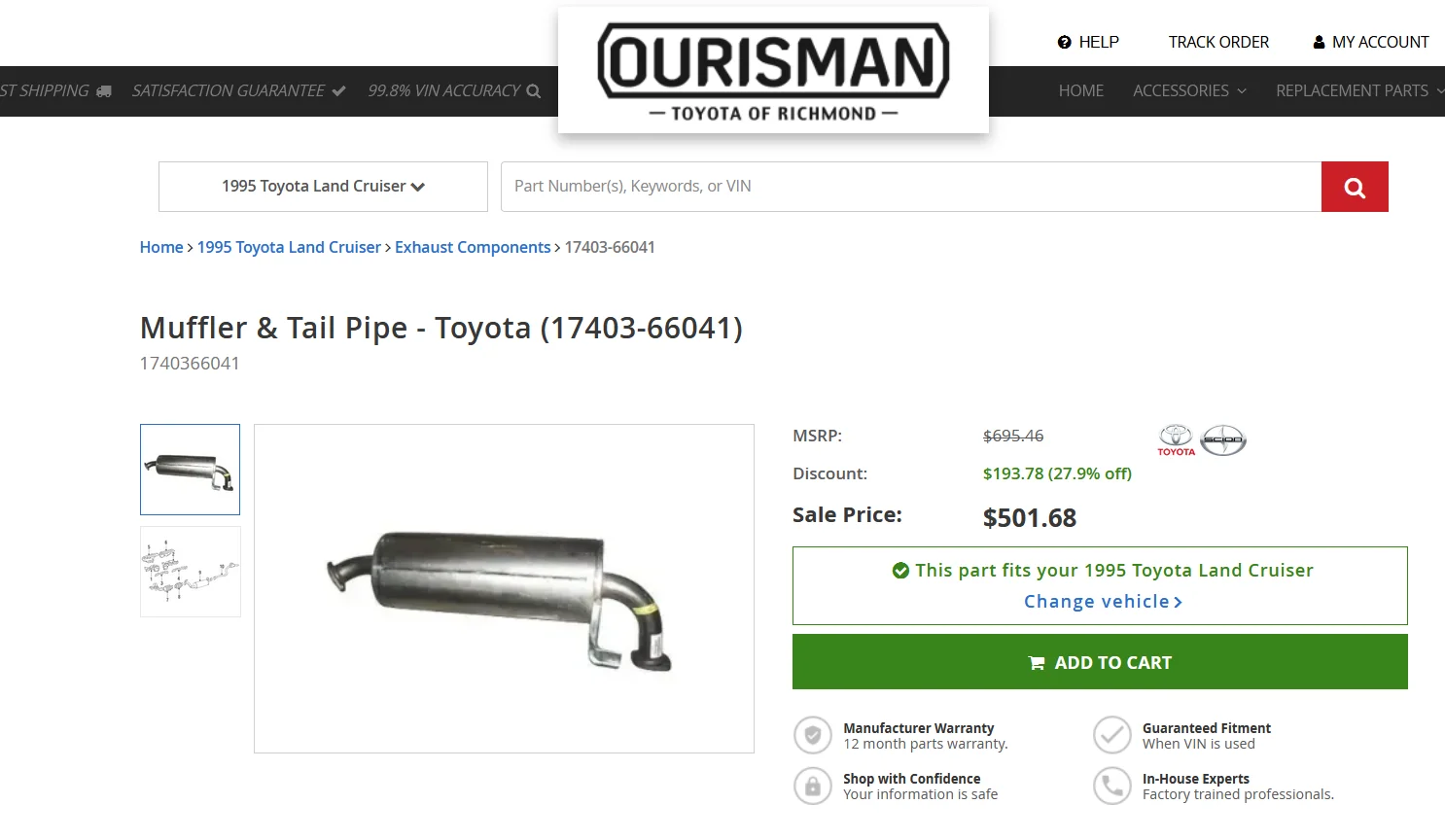

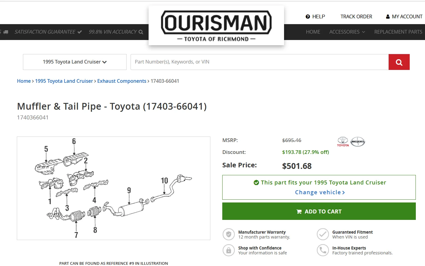

Will this part (17403-66041) fit the 1994 without modifications?
It shows as correct only for 1995-1997.

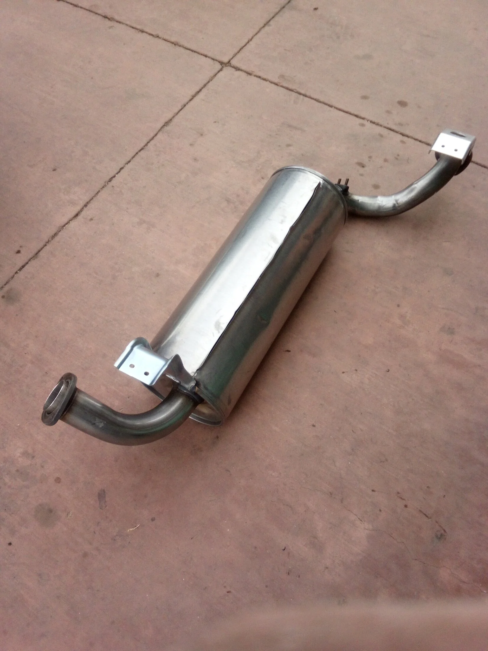

Well I'm sorry to report that P/N 17403-66041 looks nothing like the photo that Malleus posted above, If it did it just might of worked,
Below is a photo of P/N17403-66041 that i bought, and can confirm that it will not fit the 93-94 land Cruises without MAJOR modifications,
After spending $675 dollars on buying it, that's something I'm not willing to do, so I'll just return it and go with an aftermarket muffler,
Sadly, there is no truth in advertising anymore:
Same search, same dealer, new page. Looks just like the one they gave you. :(
