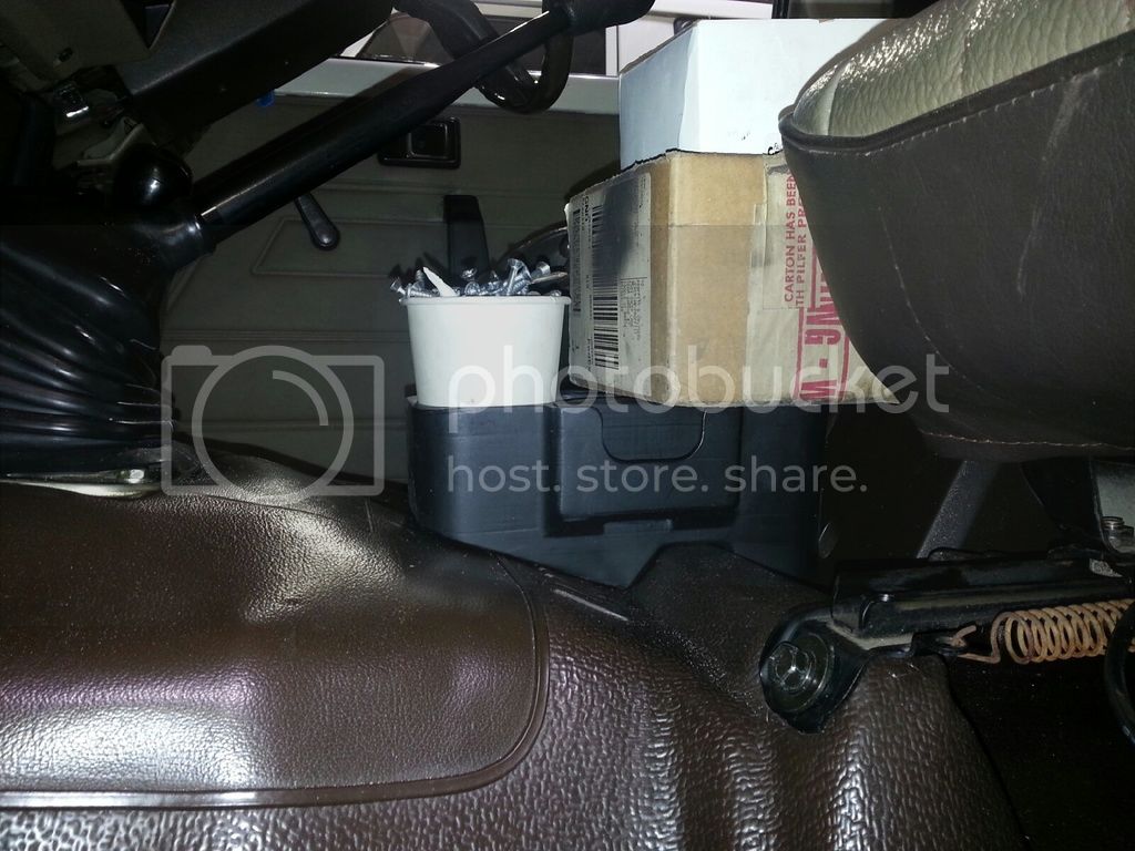

Here are a couple pics from Dan. The rubber floor isn't quite sitting flush to the sheet metal under it causing the cup holder to not sit flush. Here's a shot of that. Once Dan pushed down with some weight then the cup holder snugged the rubber down to the metal and allowed the cup holder to sit flush and level. Looks like we have the angles perfect to mount pretty flush to the carpeted and rubber floor 70's. I have one minor change I will make and will go into production on these this week. I think the best method for attachment is a couple sheet metal self taper screws into the flloor. I already have countersunk holes in the design. I will also include strips of 3M adhesive and 2 strips of velcro to give the installer some options. I hope to have both designs up on my website by next weekend.

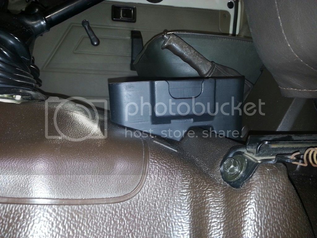

Here is the latest revision hard mounted in my BJ74. It arrived in prototype black so I finished it with Rustoleum camouflage brown. It is attached with #10 stainless countersunk sheet metal screws. It is very secure. Do remember this is still a prototype so don't hold the finish against him.
Due to the shape of the floor and the nature of the vehicle the only reliable attachment method is screws. The two mounting holes provided are sufficent. I was going to use machine screws and 5mm Nutserts but I decided to try sheet metal screws first since not everyone has the hydraulic insert setting equipment I do. Based on the outcome I will leave it as is as it is quite secure.
Mounting is such that there is enough room for at least some types of radio equipment mounted to the console. I chose to move the holder a bit left of center on the console to provide more parking brake handle clearance. I actually use my brake and I wanted more room.
