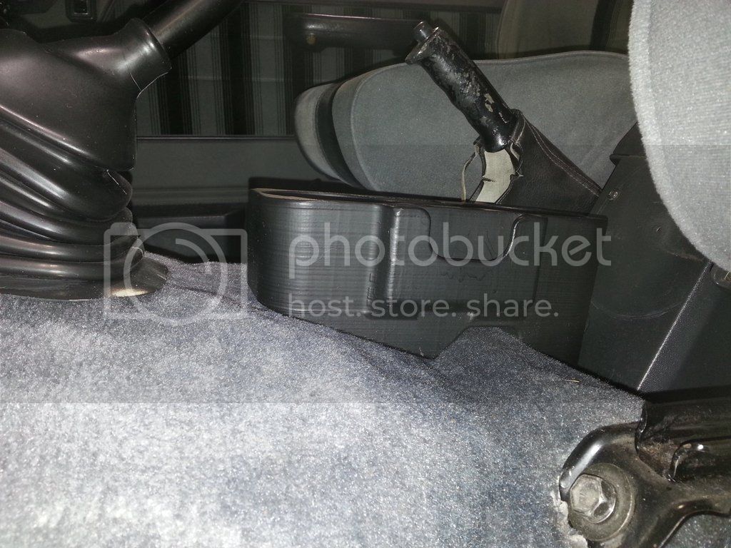

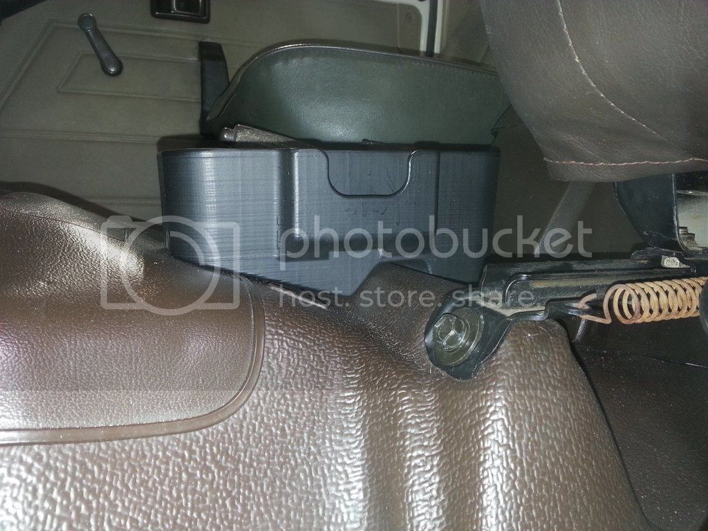

So Dan installed the cup holder in a few 70's today. Remember this is a prototype so finish and paint are not something I am putting much effort into yet. Looks like it matches the carpet interiors contours perfectly but doesn't sit level. I had to rotate the entire top section about 5 degrees. The new version (printing now) should sit perfectly level. On the rubber floor 70's there is a button on the floor that is causing the cup holder to not sit down flush. I have notched the new design to slide right over the button. Hopefully this newest version will account for all the little details of the carpeted and rubber floor 70's. I also found out that the 70s with the front bench will not work with this design. Once I finish this design and get both up on my website, I will focus my attention on coming up with something for the folks that have a front bench.

I'll take a shot from above of version 2. Bear in mind it is a prototype and as such the finish and exact fit are not there yet. Here is a view from the right side.
