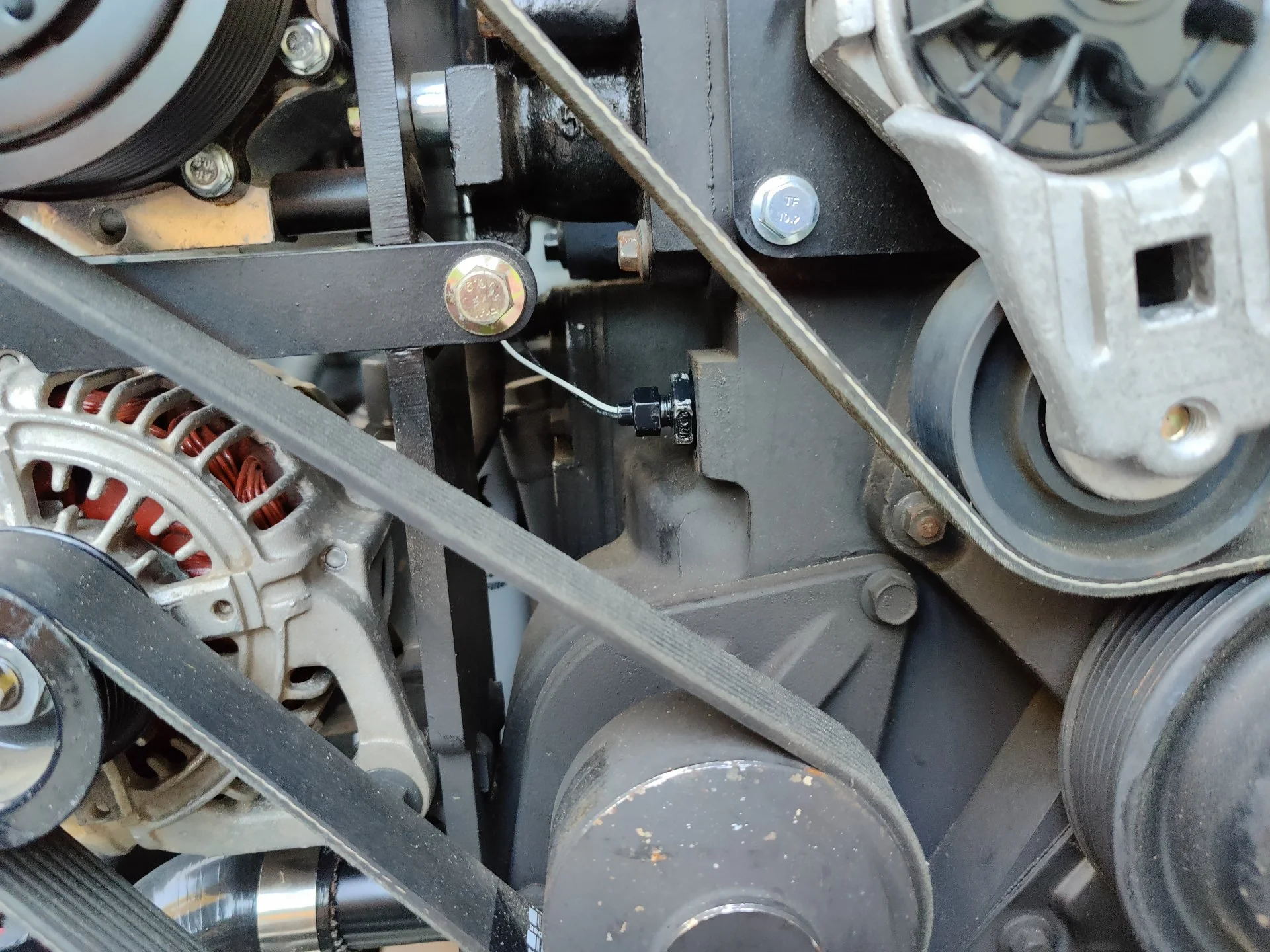

Today I moved the coolant temp sensor because I did not like how it looked where I put it yesterday. At least this way it's out of sight. Lol sometimes you gotta be picky.

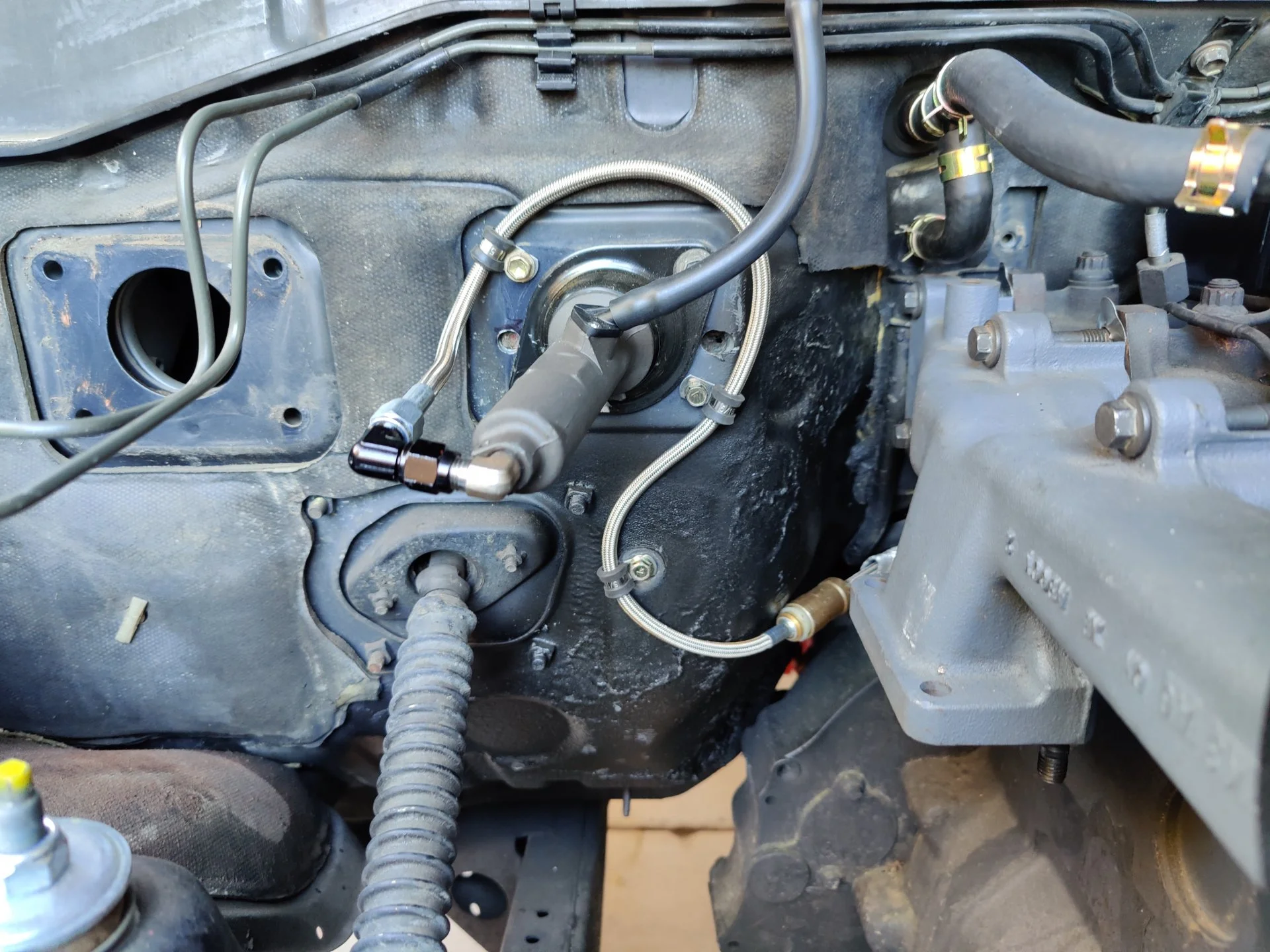

I also got my new rivsert gun.....after breaking my other on a piece of aluminum, wtf. So I finally got around to mounting my clutch line. after I get some fresh tubing I'll officially mount the clutch fluid canister too. Maybe I'll buy a fancy metal one?

I'd definitely recommend putting some sort of heat shield on the clutch master and lines. That side of the engine bay is going to get wicked hot.
I didn't realize until this last set of pics that your truck was RHD.
Yeah....Honestly the fact that it's RHD has slowed me down quite a bit and there's days where if it wasn't a factory diesel I'd have just slapped a rebuilt Toyota engine in it. I'm probably going to sleeve the line with some heat shield stuff and then make a small metal shroud for the clutch master after the turbo is in. Might be able to re-purpose the old factory one. Debating a turbo blanket and wrapping the downpipe as well.

I did, yes! That's a master and slave from a dodge. I just got a cheap one off amazon for a 96 dodge. I was going to use the toyota stuff but I wanted to see how feasible it was to make the dodge stuff work. the dodge stuff uses AN4 fittings so you can make them work for anything, apparently!
Have you hooked your Nv4500 master cylinder up to the clutch pedal yet?
Sure have! it seems like it works properly, but I'll find out more soon when I can start it.

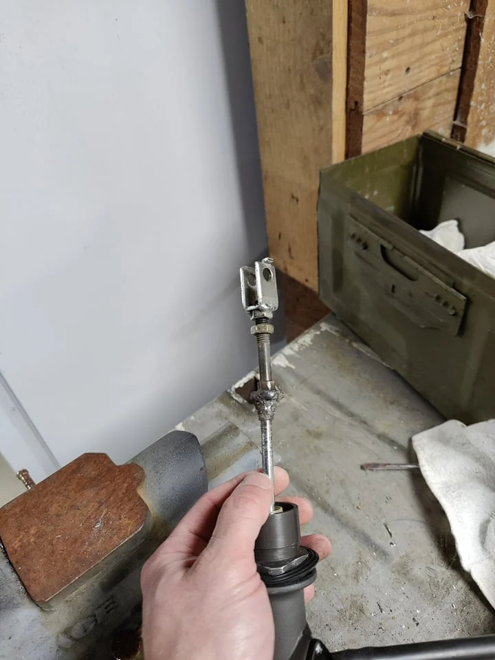

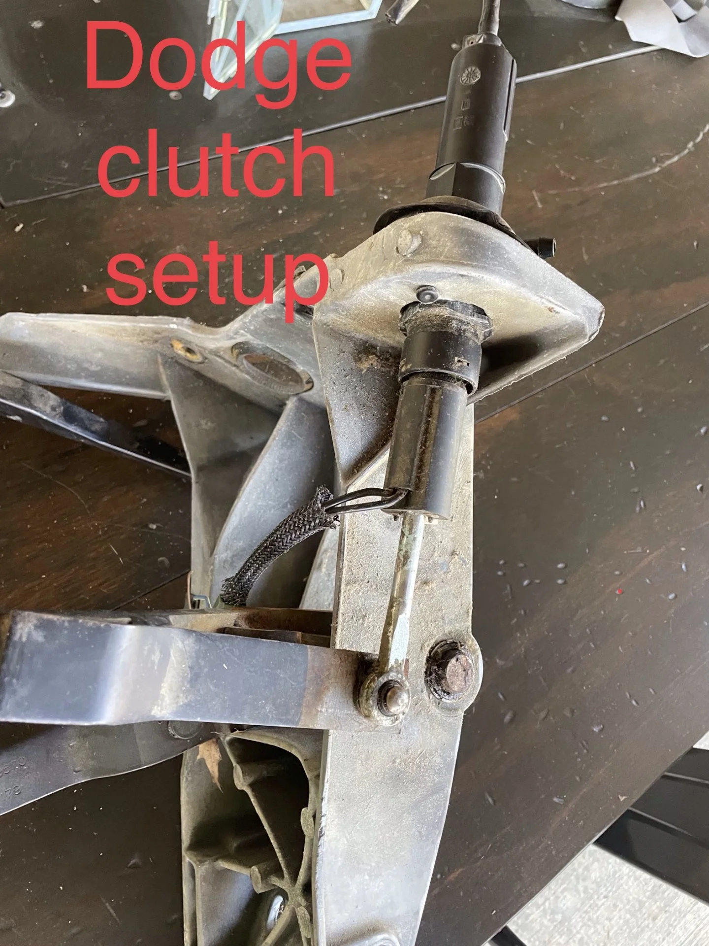

Did you have to modify anything on your master cylinder where it attaches to the clutch pedal?

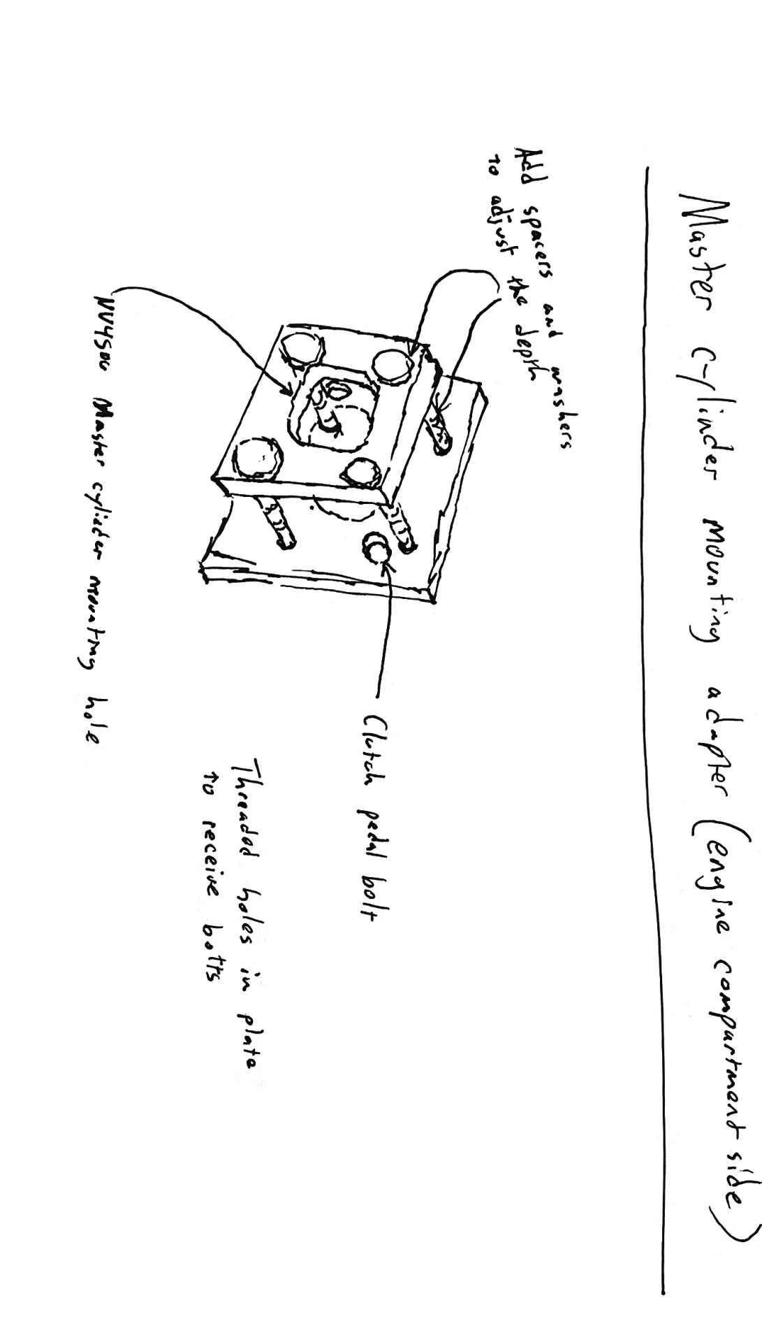

Yes. I took the "easy" route and instead of messing with the pedal at all, I welded a bolt with the same thread pitch as the adjuster to the dodge clutch rod. My first one was too long, my second was too short. The third one is teetering on still too short but i'll wait until I get to the part where I can road test it to be sure. Here was the first one. once I know the exact measurements, I'll probably make a one piece threaded rod to not have a s*** weld on something vaguely important. lol.

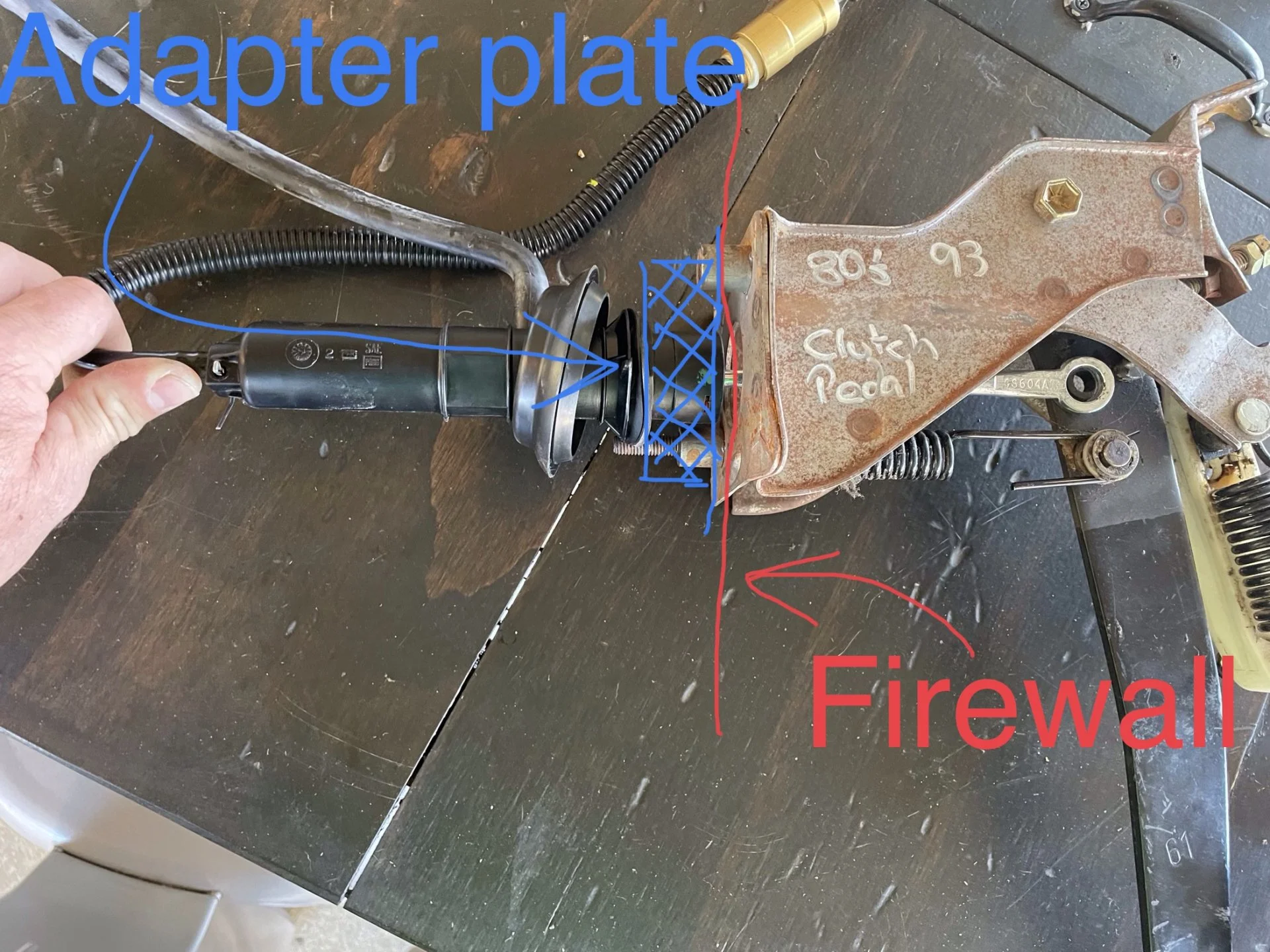

Valair makes a small "plate" that is cut to match the dodge master cylinder pattern. Before i knew this i tried to make one several times and just could not get the pattern cut right to allow the twist lock design of the master cylinder to hold tension correctly. It was sketchy at best and a little jiggling it would fall out. The valair plate was like $25 or so. Has two holes to mount but i welded it to a larger plate similar to your drawing. I will get a picture in the daylight if you want.

Awesome. Thank you. A photo would be much appreciated.
I knocked those bolts out and welded it to my backing plate. There may be a slight angle to it also to match the apparently angled dodge firewall. I just shimmed under one side to make it level or perpendicular to the land cruiser firewall.
The valair mount fits without any modifications to the land cruiser body. Press the studs out of the mount and out longer bolts thru it and use the factory nuts on the inside. I found that out after I drilled those two holes.... :(
Haha, yes, unfortunately i ended up with additional holes in mine before the final solution. I ended up having to fab an entire clutch pedal bracket/bucket because i could not find an 80 series bracket after searching everywhere. I didnt realize you had a valair bracket and i also see we may have hijacked your post! I'll go back and read from the beginning.
No worries! I don't think I ever really talked about it being a valair one specifically. I think I just kinda did it and posted a photo. I'm probably going to shim it and straighten it a bit, but there's no interference currently so we'll see.

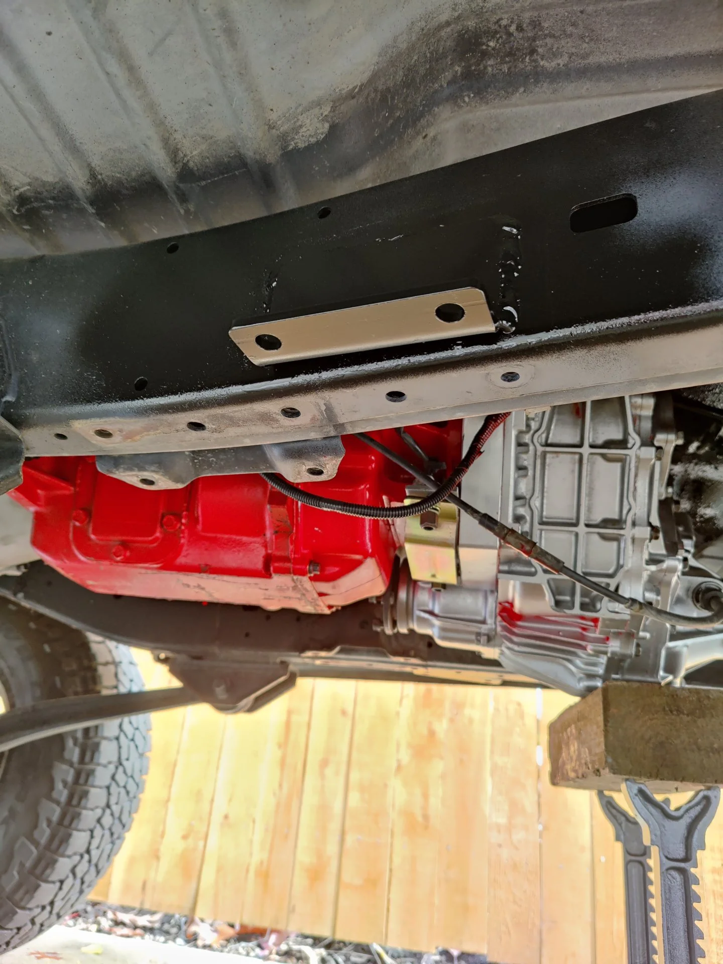

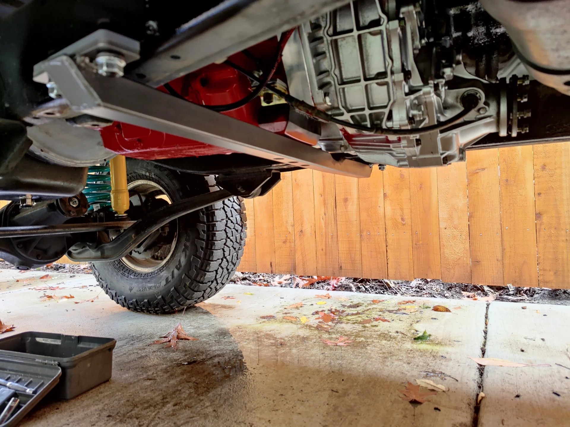

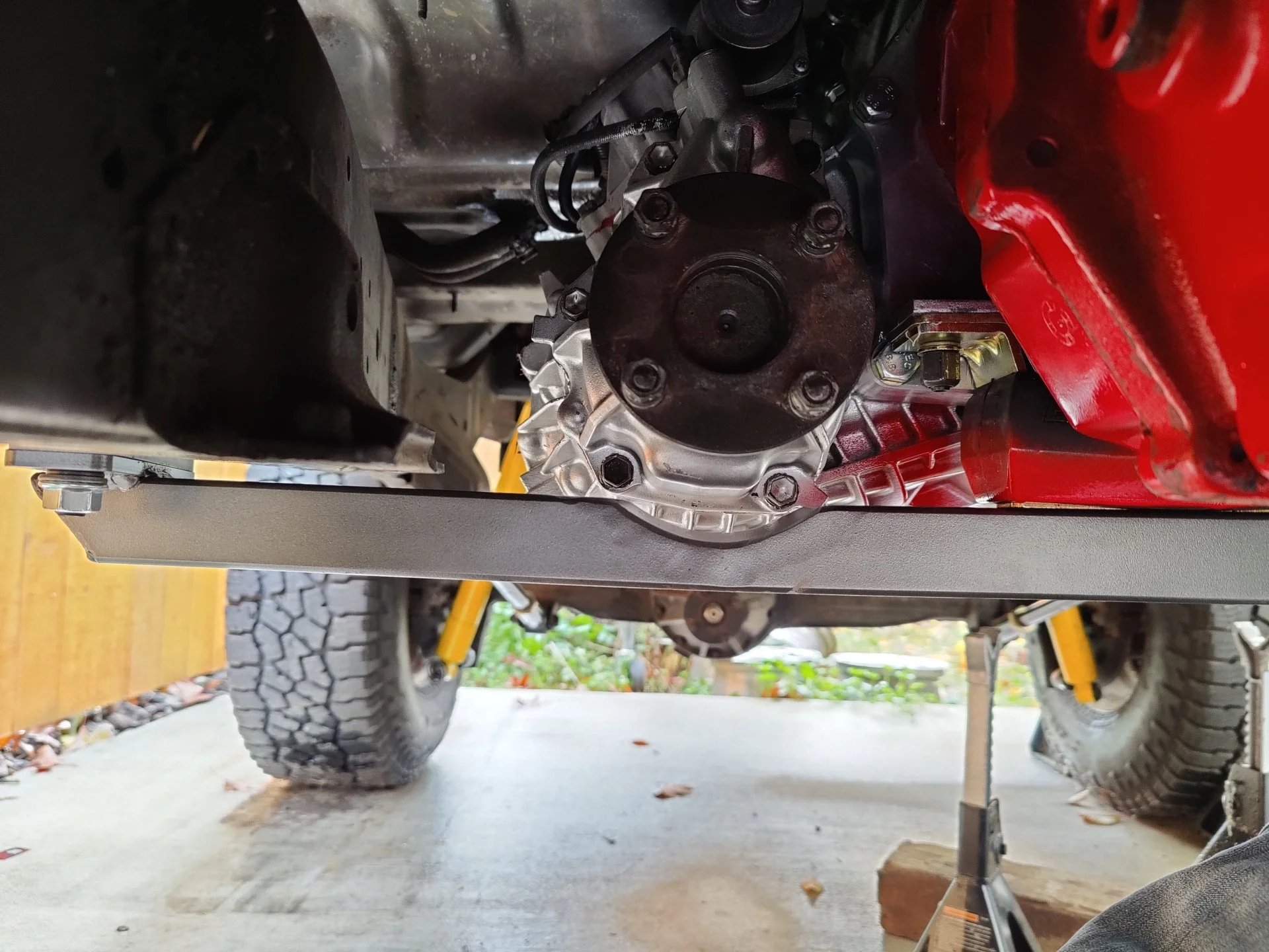

Friend came over with some brackets and metal and we made a super simple, yet effective trans crossmember. Once it's back from powder coating I'll snag some photos. Decided that remaking the entire thing and making new brackets made more sense.
Other than that, I worked on extending some wire harnesses so I can have acceptable cable management when this is done.
Crossmember is back from powder coating and installed, it looks good! Hopefully it holds up and I can forget about it.

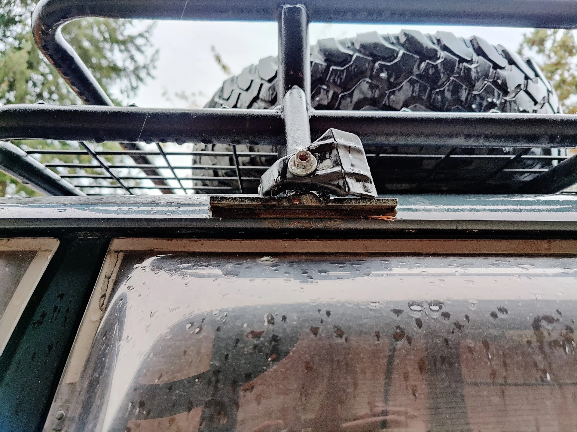

Hydroboost still hasn't arrived, but I pulled my interior and dried everything out. My roof rack was the main source of the leak. The clamps were pushing the weatherstripping up :(
Guess I'll have to figure out a new way for the rack to stay up there.
