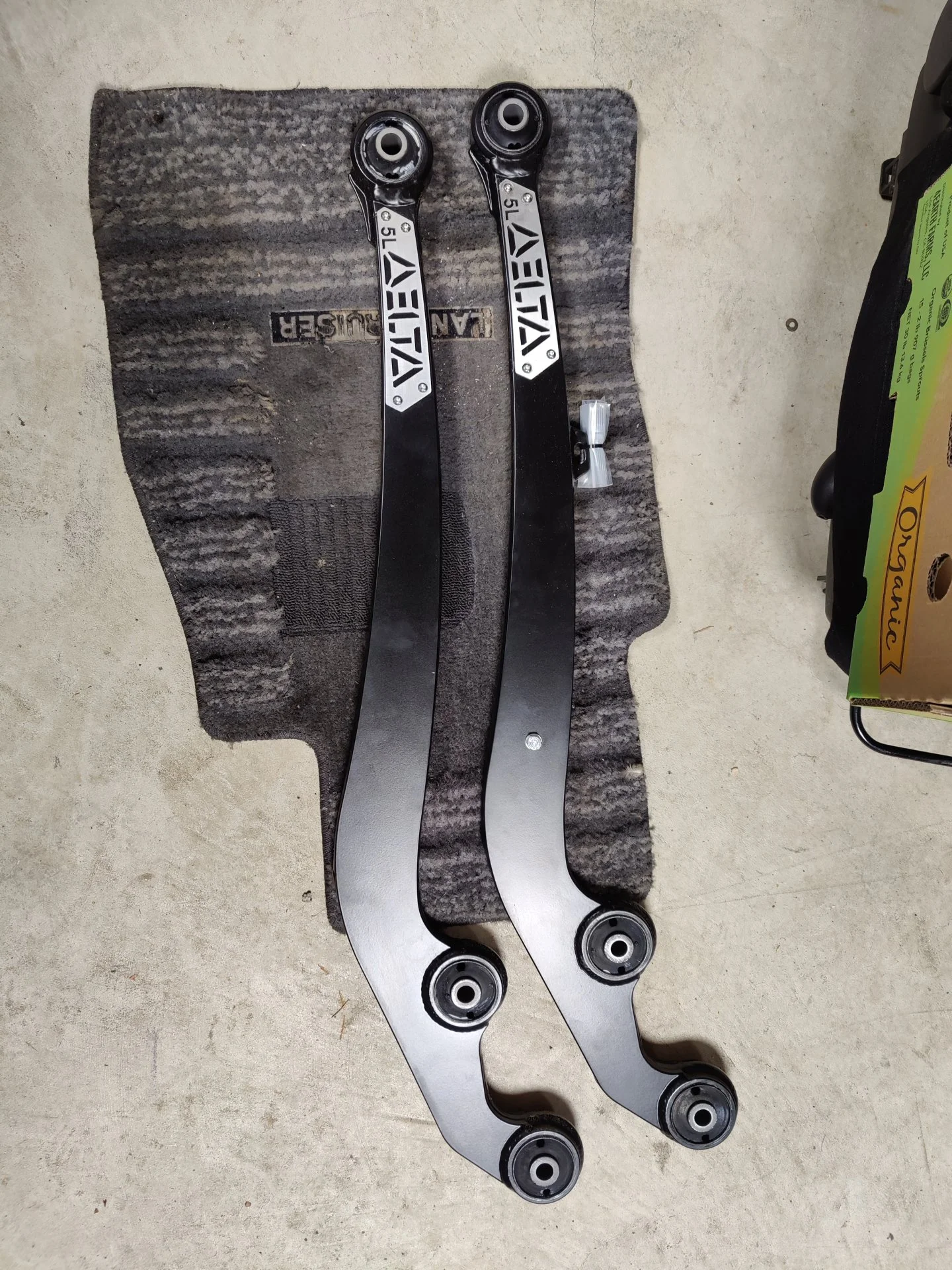

I got some stuff delivered the other day, super excited. got the Radius arms from Dave (so fast! I thought they were a pre-order!), and some tom woods driveshafts.

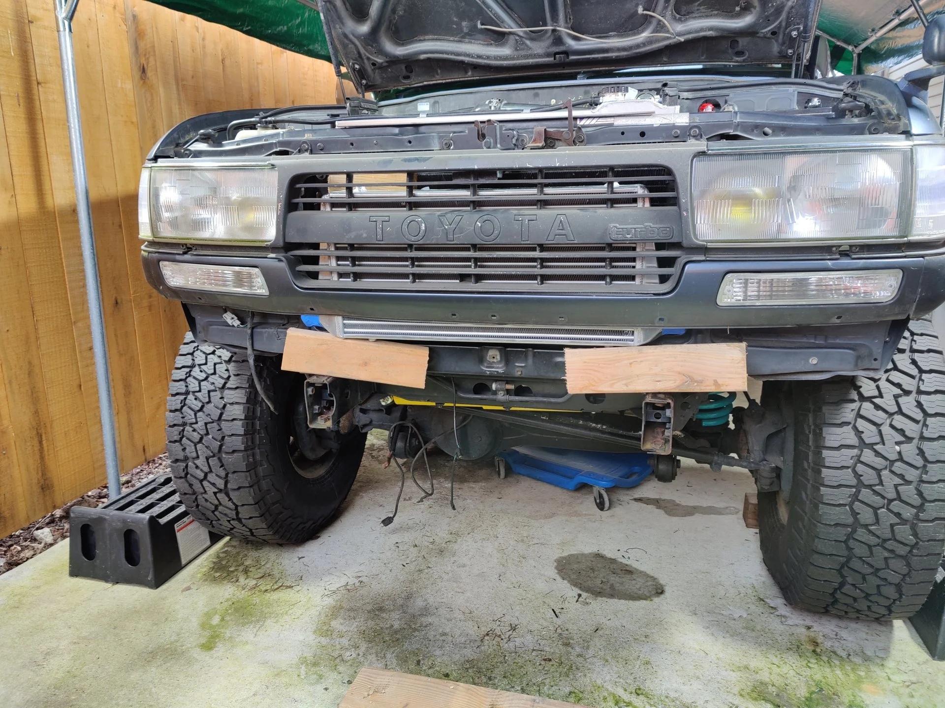

Thanks! It's just a universal 3" intercooler I found that fit. Nothing special on that since there's not really a kit for it. Largest size I could find with a 3" in and out.

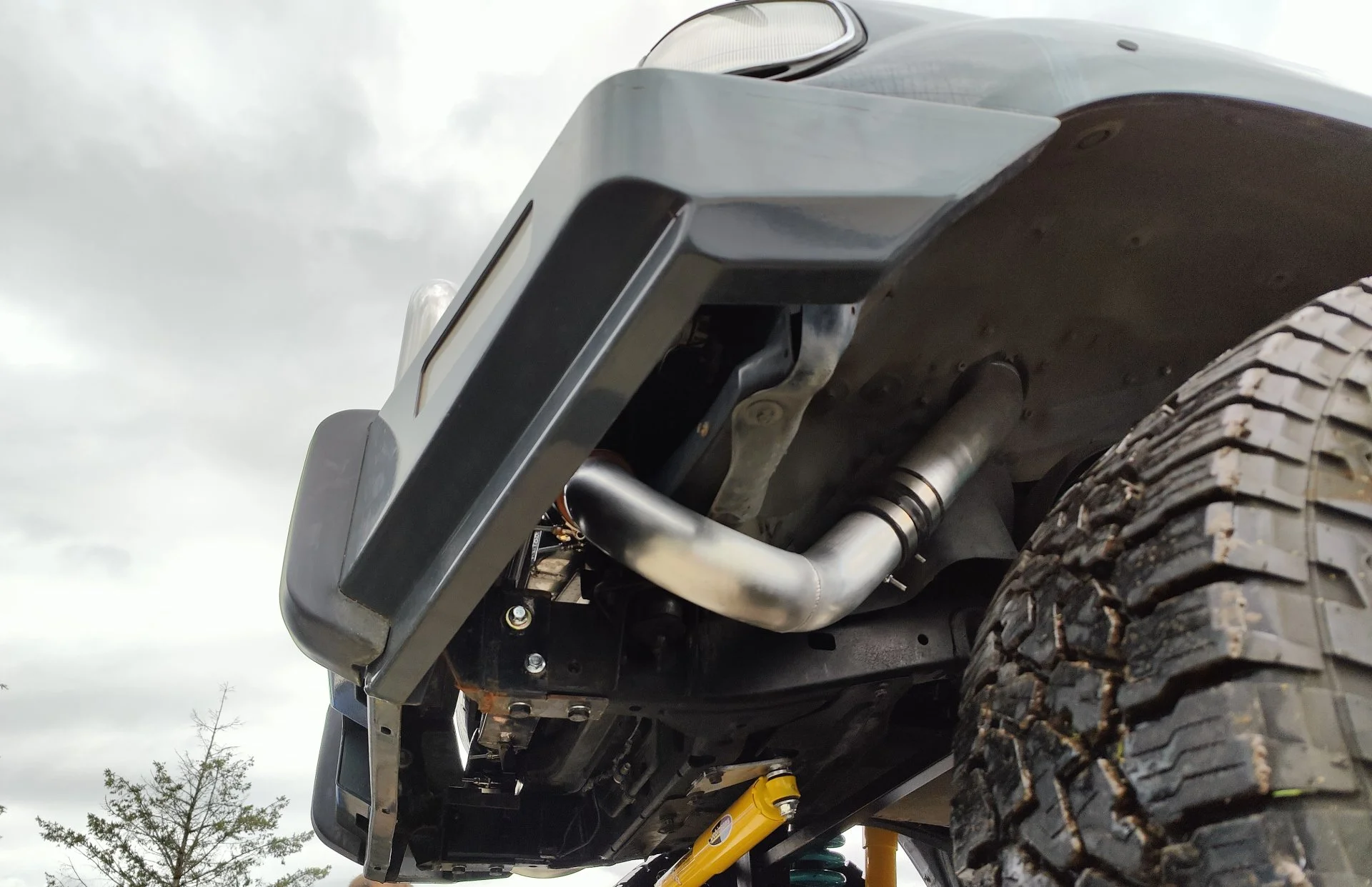

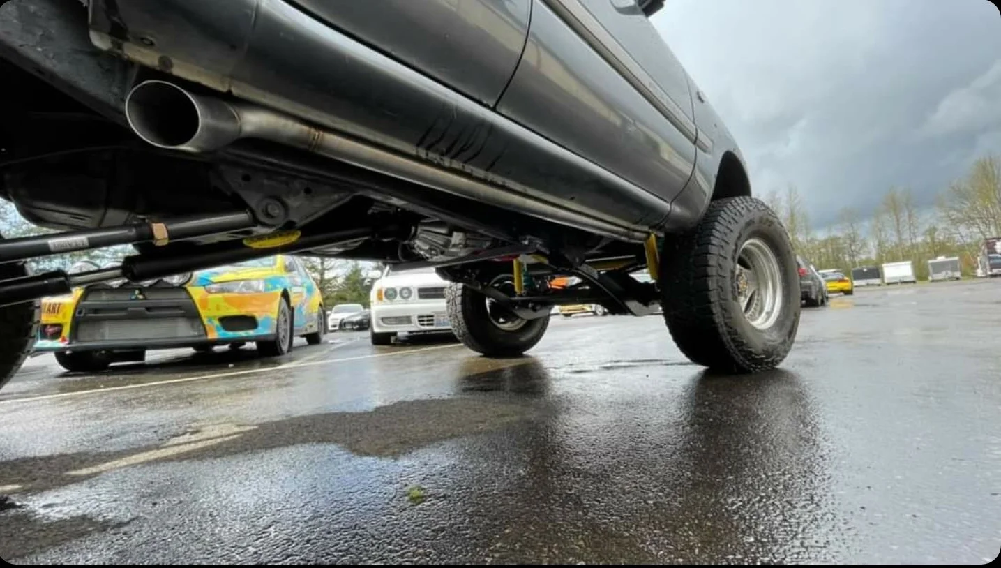

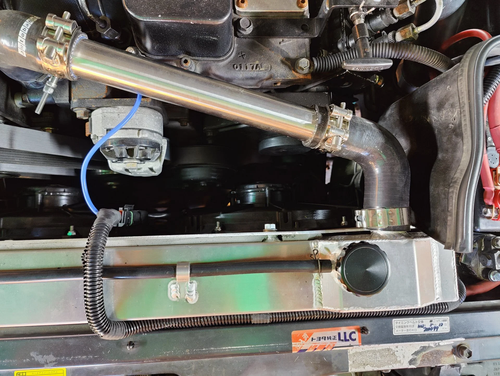

Intercooler piping and exhaust are done, now it's getting an alignment! When I get the truck back I'll take more photos of the piping, of course. The shop has been saying the rig really grew on them as they started working on it. Didn't think much of it until they had to move it, lol.
It's 3" stainless, should sound pretty awesome. Just straight pipe for now.
Cruiser is home, and sounds better than ever! You can hear boost build (weird how having the turbo hooked up will do that eh) and the exhaust sounds a treat for not having any mufflers.
I'm happy with the intercooler piping. It's tucked up enough that my tires won't hit it and if I ever worry about damaging them I'll just make a small metal guard for them.

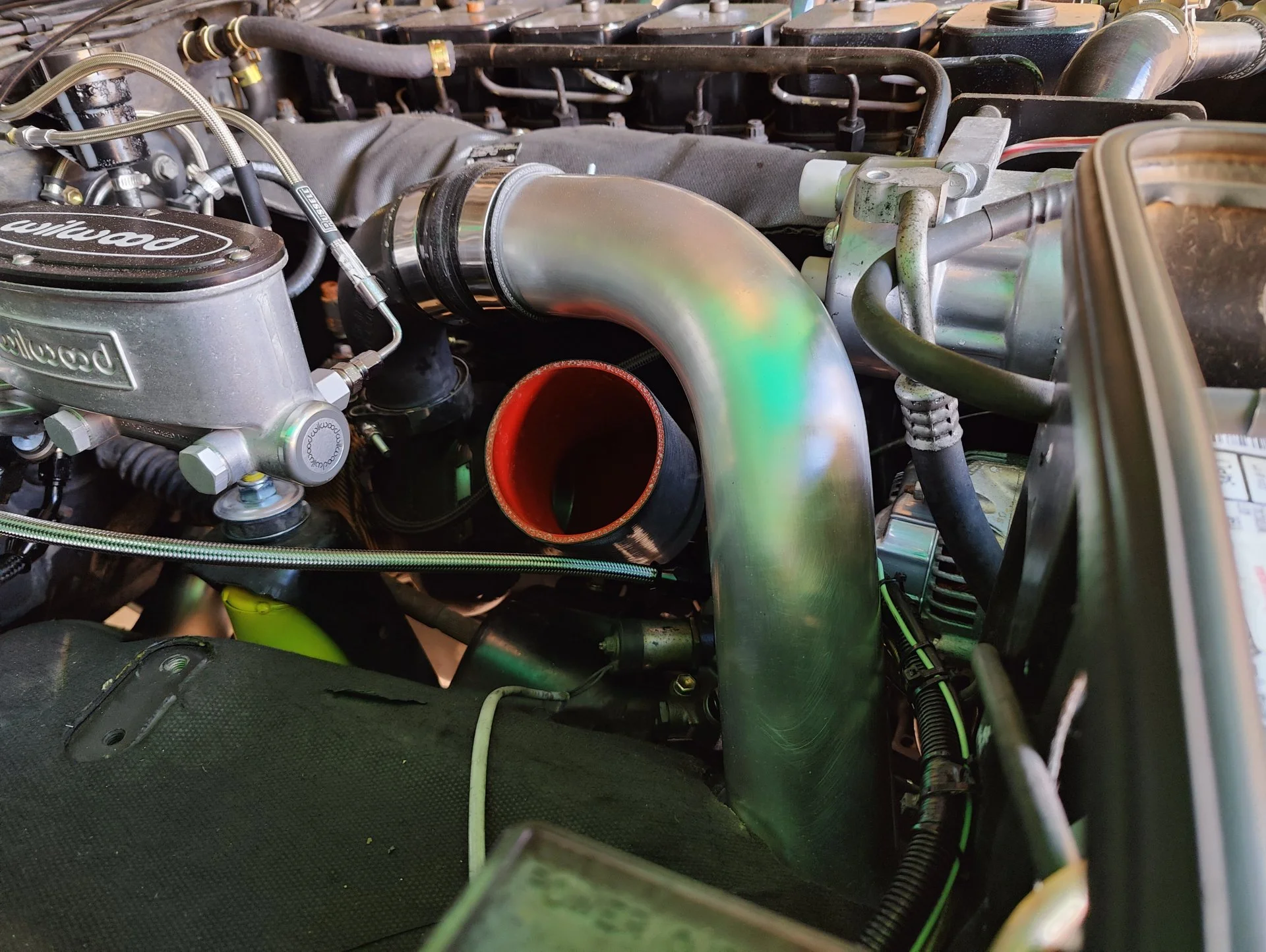

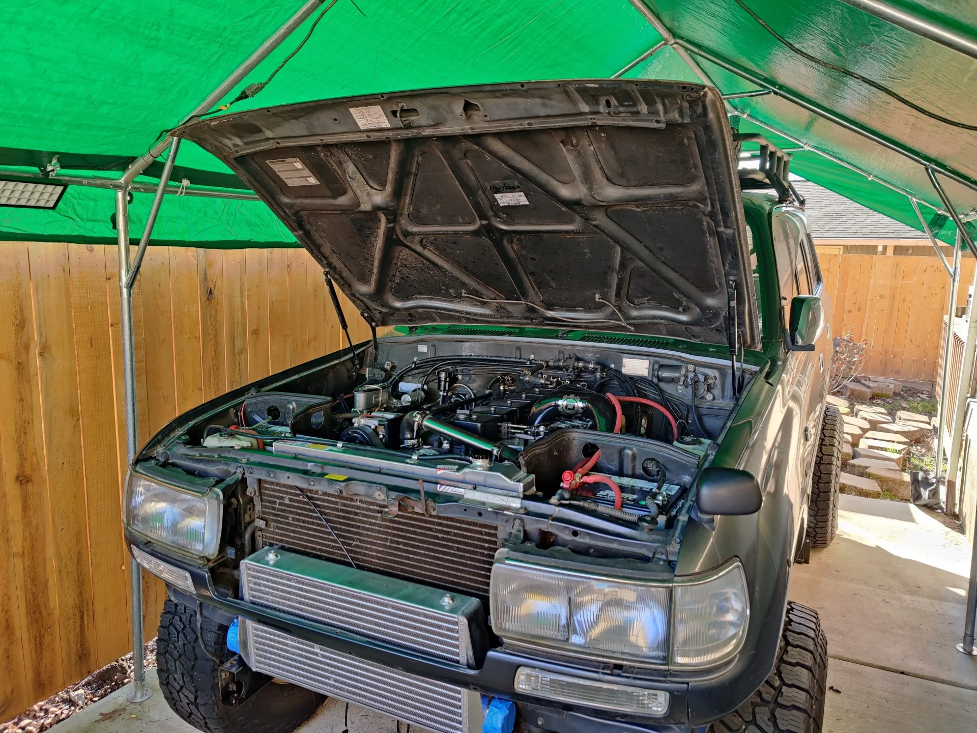

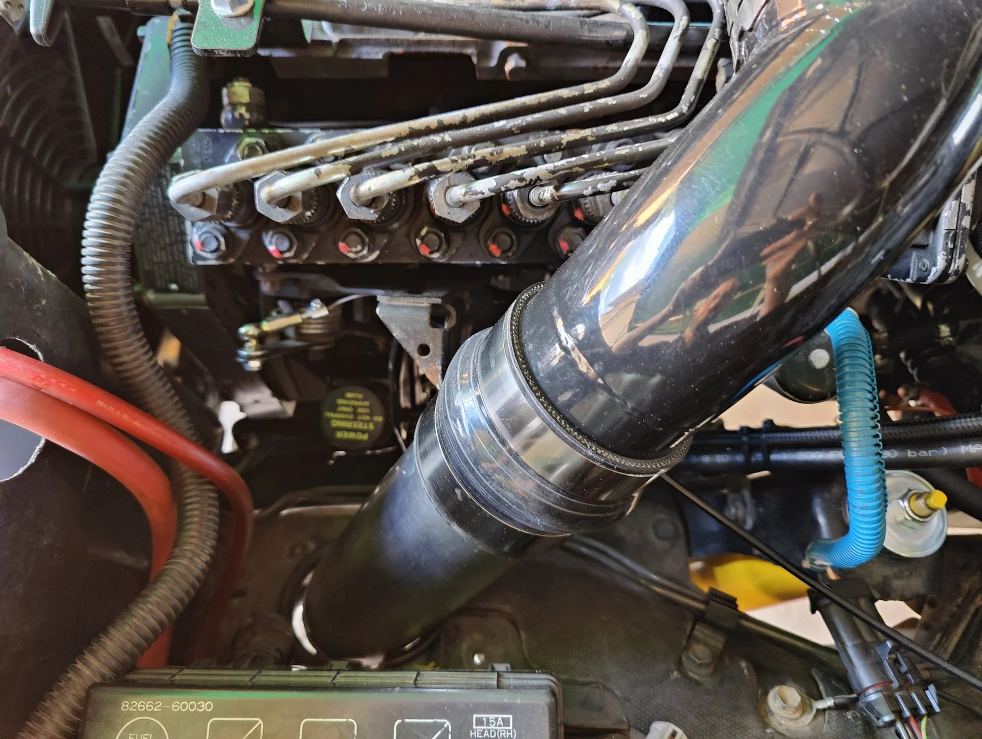

Why is the intercooler piping ran that way? Should be tons of room to cut a hole in the core support to get it through on the inside, especially considering there's no steering box or anything on that side.
Seems weird to me.
Seems weird to me.
I thought about it, but I'm fairly confident it would not have fit. The P-pump, power steering pump, and battery on the passenger side kind of stole that room, and the steering box, radiator coolant lines, and alternator sucked up all the space on the drivers side. It's also possible my stupid large radiator is contributing to that as well.
Maybe the photos don't convey the situation, but it looks like there's a ton of room. Mine is right through the core support below the battery, tons of room between all that junk on the engine.
Either way, looks sick.
Any chance you'd snag some photos? I'm not opposed to changing it down the line if it ever came down to it.

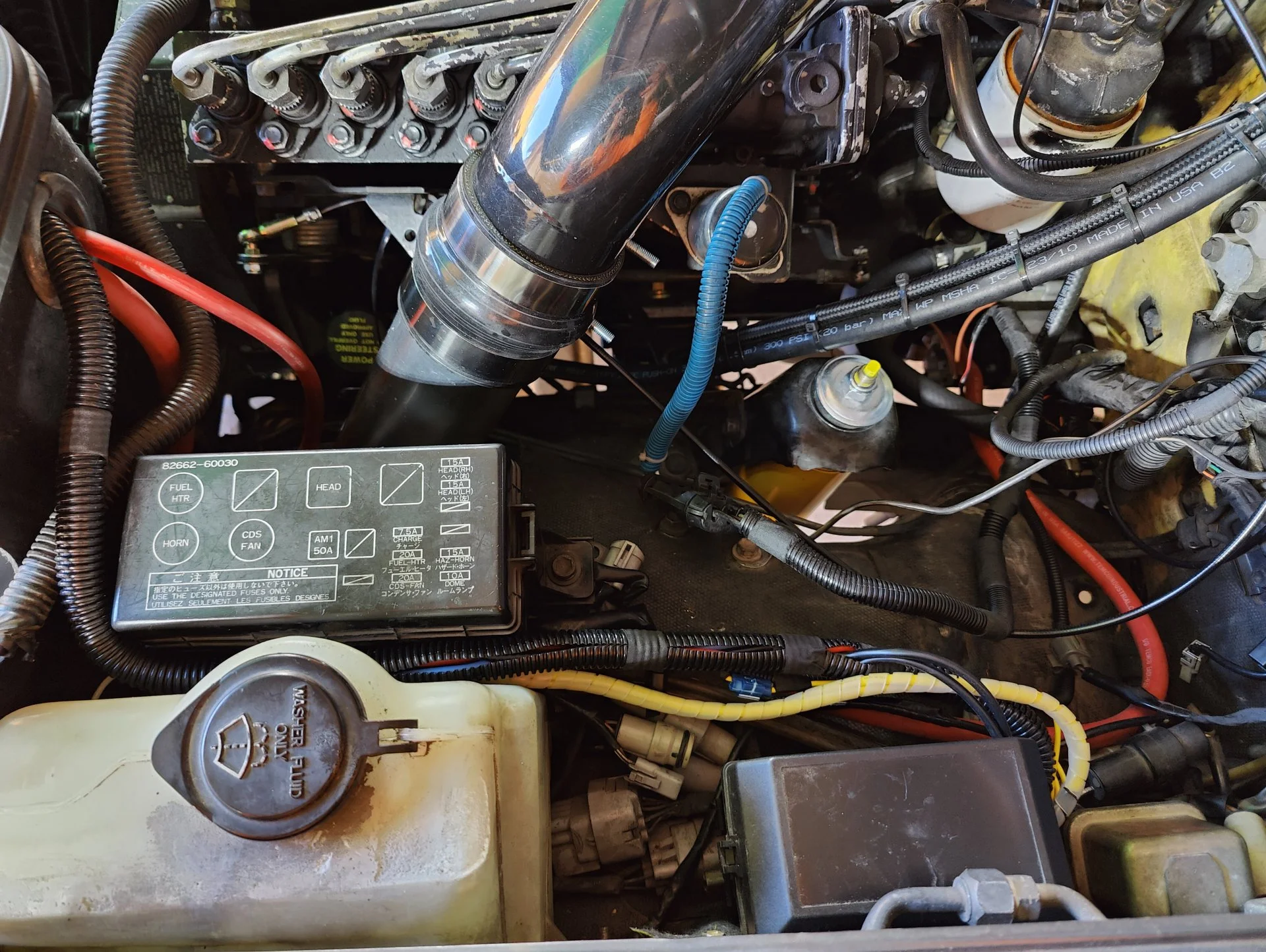

Today I wired the e-fans. Each one has its own relay and fuse in a box I installed, so if one dies I should still have another. Got room for 3 more relays so maybe my dog lights and compressor will go thru that too.
Pulled switched power off of the fuel heater relay, as I don't need it / my rig didn't have it installed. Manually tested each one and next I'll let it idle for like an hour and see if they turn on lol.
Just need to tidy up the wiring by the relay box and it'll be done!
I let the rig warm up until the fans came on today, took about 30 minutes of idling before it finally got up to temp. once it hit 185, the fans kicked on, and dropped temps down to about 145. I am very pleased. I'm curious to see what temps do when it's driving! I did notice that my temp gauge in the factory cluster wasn't working though. I swear it was before, so maybe my sensor took a s***. Oh well.

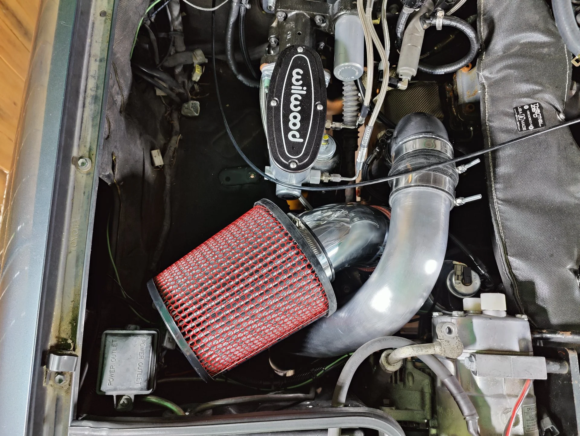

Cut up a 4" elbow I ordered to shove the filter in a temporary spot for now, until I can fab up or have a shop fab up an air box for me. Such a tight fit! i think I'll have just enough room to put a box there, while still retaining the position of the little power outlet. I could move it if needed, but i'm trying not to. I think i'll then go for a 3 or 4" stainless snorkel, because why the hell not.

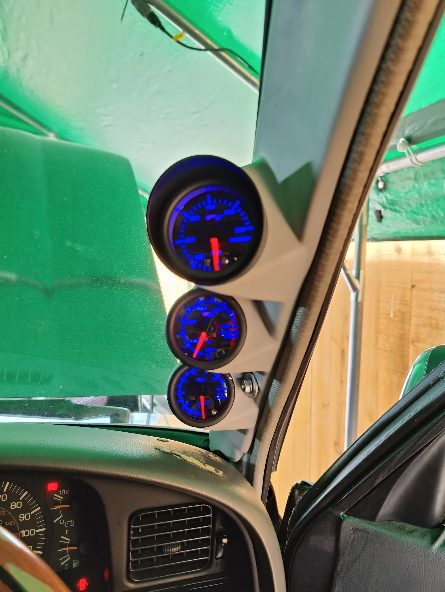

Then I worked on getting my gauges to stay in place and not flop around. There's only like 2 options for RHD cruiser pillar pods that i've found, and they're both kind of s***. I should have just made one myself, instead of ordering this garbage. I put a riv-nut in the A-pillar and slapped a second bolt in it, and then did the same for the grab handle. It looks kind of like ass, but at this point I don't particularly care. I can re-visit it after the rig is driving.

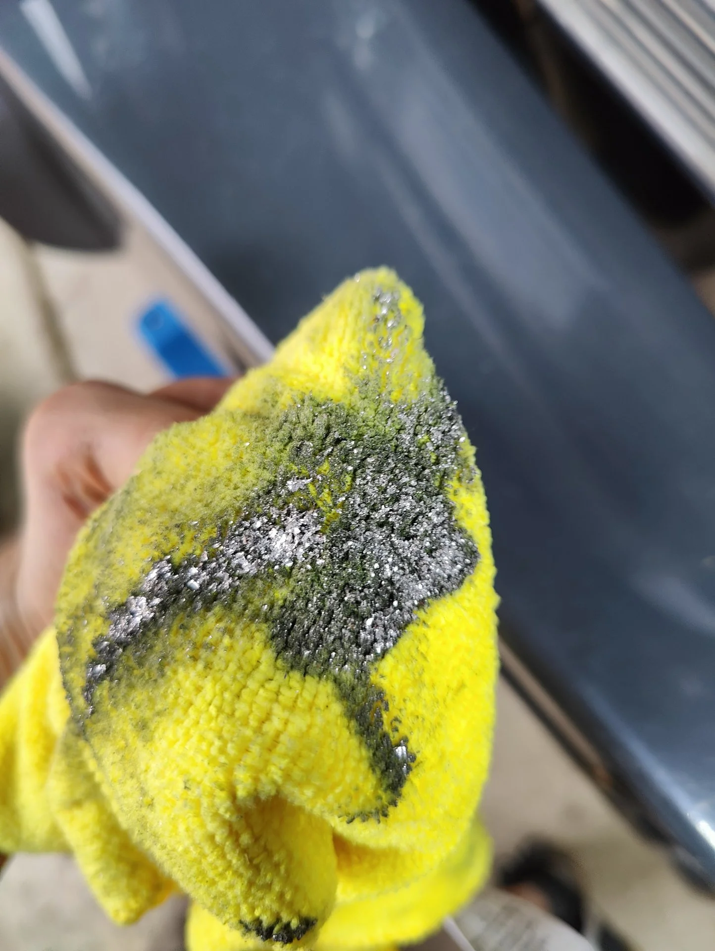

Gear oil is leaking out of either the trans or transfer case, but the worst part is I get a terrible grinding upon deceleration. I think my transmission is shot. Going to take it out and rebuild it :(
All in all it's a pretty good first drive.
Well - I found some rather unfortunate info today when I pulled the transfer case / transmission. Transfer case is messed up. Im thinking my selector fork didnt get seated correctly or i lost one of the retaining rings on a gear, but we'll see when I pull it apart. Since I'm here, I'm at the minimum going to take the top off the transmission and look into it as well. somehow, there was oil on both sides of my adapter plate, so I can't be 100% certain if it's only the x-fer case.
